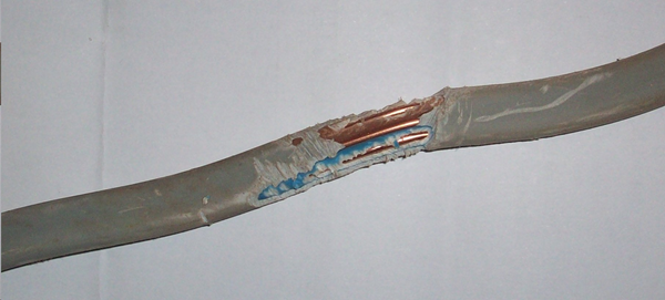

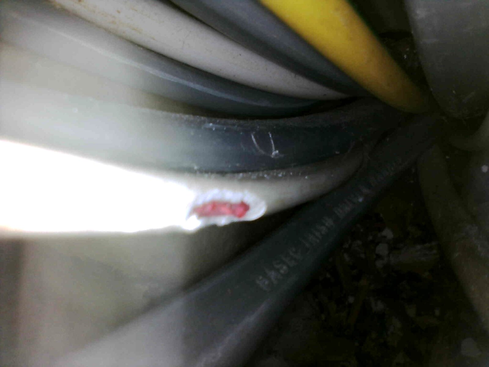

While pulling some new wire through the wall cavity for another project I used a borescope to find my draw tape and found the attached.
It's a 120 year old barn, converted around 22 years ago.
Is this fixable or do I need a full rewire and would that include everything up to the upstairs bathroom light?
If it is not affecting the circuit in question you are probably ok for the time being. But it looks like it has been gnawed by a rodent and so the problem may come back.
Best to chop it out and joint the two ends of the cable with a suitable connector.
Blup

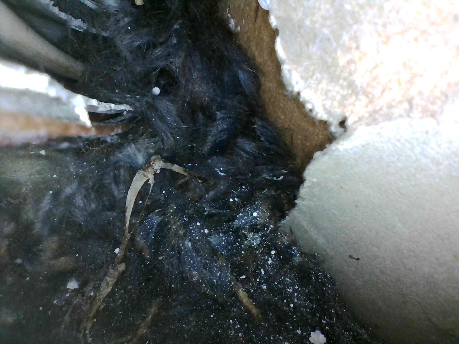

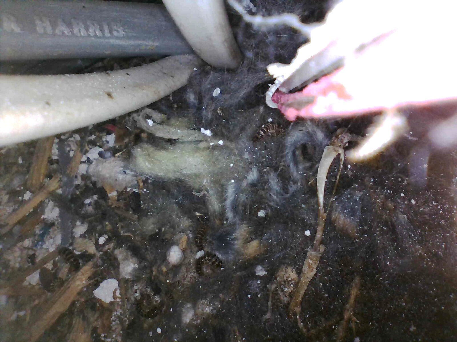

Thanks. Definitely mouse. I can see the dead ****er laying there with his dead friends.
Not a fire hazard?
Not clear in pics but one of the t&e looks like both L/N exposed.
Wonder how many others there are

A few years ago, I (by chance) stumbled across the rodent damage to a cable pictured below. I exposed cables in the immediate vicinity and found no other damage. Lifting all the floorboards 'for inspection of cables' in the very large house was essentially 'unthinkable' and a 're-wire' totally unthinkable. I therefore just replaced the one damaged cable, put the floorboards back and got on with my life.
As I said before, damage of the type illustrated below is (for obvious reasons) not detectable by any sort of electrical 'testing' (the insulation resistance of that cable was, as one would expect, fine) and, indeed would not result in any problems' unless it was 'disturbed'.
