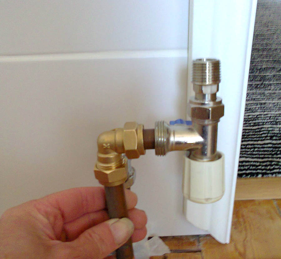

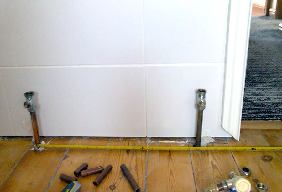

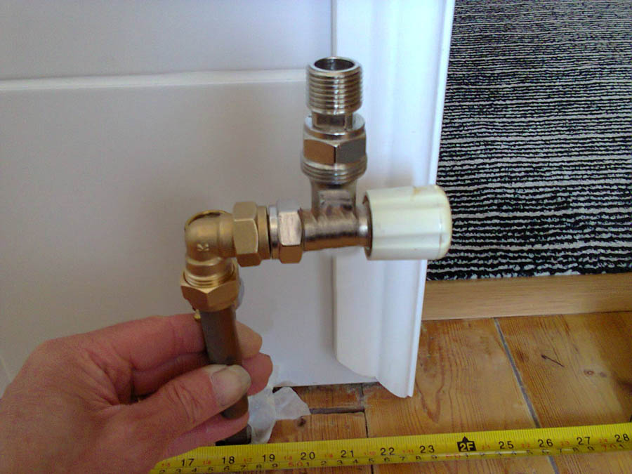

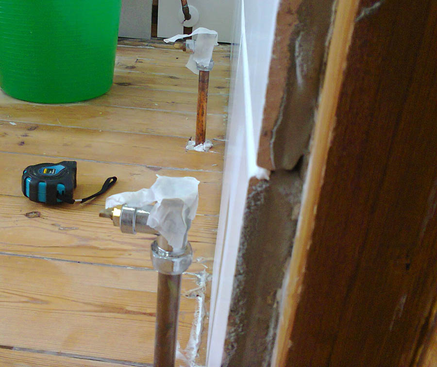

Firstly i am not / cannot alter the pipes under the floor and there will be a loo right next to the rad and it will be relatively out of sight and also not the first thing you see when you walk in the bathroom, so I am ok with any ugly issues.
I have to move the pipes as after tiling they are too close to the wall so need to dog leg but because the dog leg is not massive in order to accommodate the compression fittings I am also moving right but cannot go too far because of a door picture here
I am holding a mock up with bits i have this one for the left
the compression elbow will be this one sided one below below so only 1 nut on the valve side and as that is not a proper rad valve i am holding for my mock up it should all look smaller and neater

Its the right hand side that i have issues with here is my mock up of what i want to do

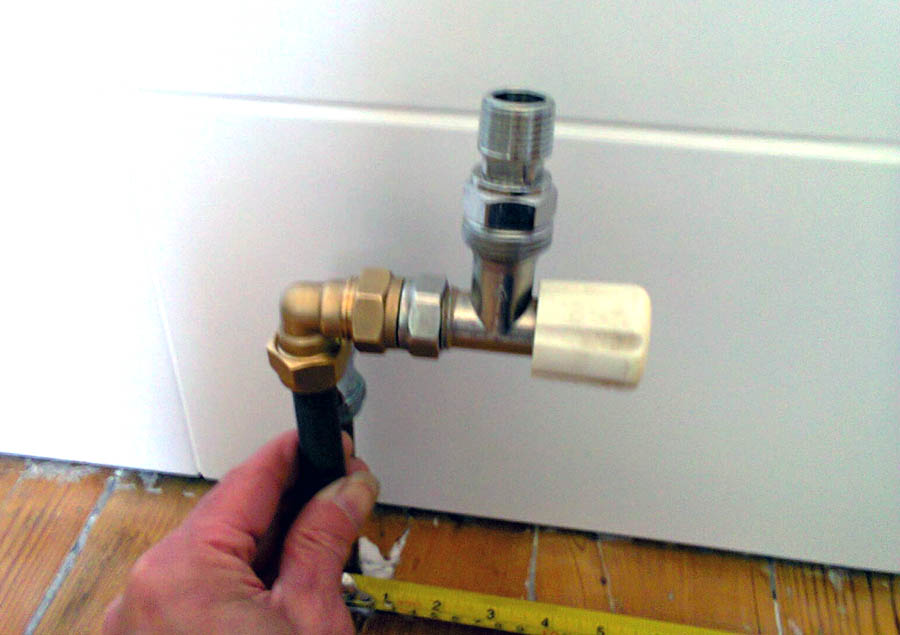

Here is what I want to avoid as its getting too close to the door

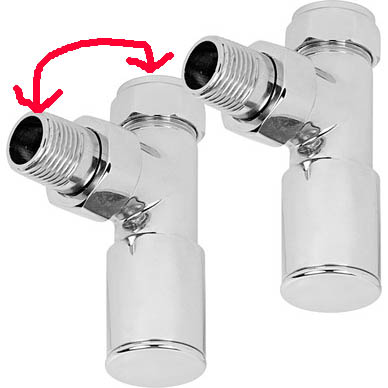

Every picture i see of angled valves shows the tails on the other side to what i need to do for the 1st option
Can i just swap over the tail end for the compression side so I can fit it like this

The problem is i still need to move the valve 20-25mm away from the wall- it is so much i.e not just 10mm tiles and some adhesive because before I tiled the wall was wonky and now behind the tiles on the door side is 15mm of adhesive to level straighten up the wall
If I was to use a straight one then I still have to add 2 elbows to dog leg out, whereas using an angled valve already gives me one of the elbows
Both pipes are too close for 2 reasons one is the tiles and the other was the design of the old towel rad that had the fins on the front so it could be mounted closer to the wall and still get your towels over it, the one nearest in the picture is now even closer because you can see how much the tiles have had to kick out to flatten up the wall

Just noticed the angled versions of the ones you posted say bi directional - does that then mean I can do what i need http://www.screwfix.com/p/verona-angled-radiator-valves-15mm-pair/37800
Bi directional just means they can be used on the flow or the return. If the two threads on the rad valves are the same dimensions and both have a taper you should be able to do as you want. I can't quite tell from the pictures.
Does the rad tail have an olive, either sliding or fixed? If so you can turn the valve around. I suspect not from the photos though.
Right so if there is a taper at both ends then i should just be able to swap over

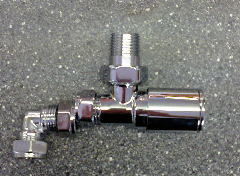

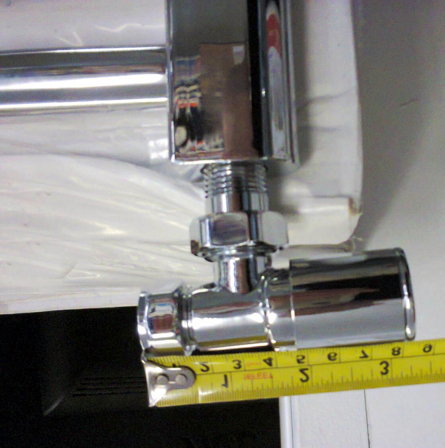

I dont have the valves yet as this picture I took in the plumbers merchants when I was trying to work out what to do and is not what i need because the tail end has a bigger nut I think so i canot swap over
pipe-1-jpg.81803
But this one and the screwfix ones look like they are 15 mm both ends, the tail piece that I want to swap over i think is a standard 15mm tube beyond the thread so the body of the valve must have a taper and olive, i will have to go and look
pipe-8-jpg.81802
No theyre definitely not standard 15mm tails, the hole in the nut on the tail side is too big,

That one in the merchants then has a big nut and a big thread but yet the tail thread is standard, big nut like my origionals in the picture.
Its just that looking at the screwfix picture the nut looks 15mm both ends
Now I see the screwfix ones have a pdf download that says its a 3/4 nut

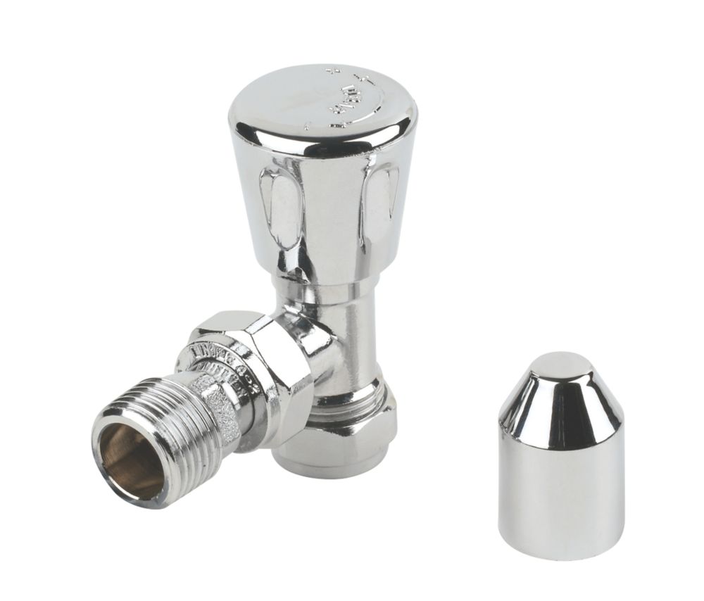

These screw fix ones look what I need http://www.screwfix.com/p/chrome-angle-radiator-valve-15mm-pair/94103
ae235
The pdf shows two olives
Just read the reviews ands one in 2012 says this
" This is the part you want for dual fuel towel radiators. The fitting for the rad can go on either end of the valve so you can come out of the dual tee into what would normally be the bottom of the valve. The valve tap is then horizontal. The pipe goes down into the floor. A straight valve on the other side and you have a ladder towel rail with the taps both facing in for a tight solution.
So 1/2 inch bsp tail, and a 3/4 inch bsp nut, so not turn-around-able. That is, the old union type valve where you put the tail in usually with a large Allen key.
Bear in mind that the nominal thread sizes have only a loose relation with the actual thread diameters for historic reasons.
The 15mm tails have flats to wind them in with a spanner. So 1/2 inch bsp one end and 15mm compression the other. The vast majority of rads have 1/2 inch bsp tappings.
I actually have a spare tail just as you describe with flats you can see it sitting on my mock up valve ( which is actually a washing machine valve I had laying around so I could mock somthing up) I pushed a spare wheel cap on the nut end
Ahh I hope that has not confused people thinking I was trying to use that, you can see the blue plastic turn behind
pipe-4-jpg.81806
Yup, can see what youre saying, just need to get a rad valve with two 15mm compression connections rather than a washing machine valve.

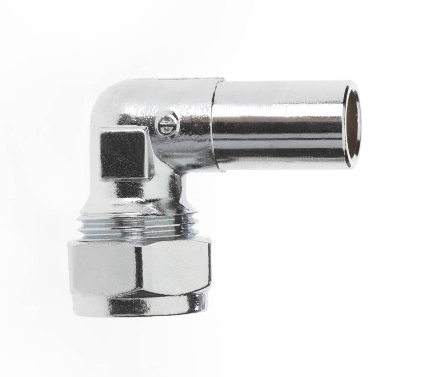

Everyone has been a great help so far. Now I think i know what i need and that i can do it can anyone help as to where I can get these other than here http://www.heatingcontrolsonline.co.uk/15mm-chrome-compression-elbow-p-772.html?search=elbow as I will have to pay as much post on them as they cost, I can not find them on the web other than the link, im hoping there is enough pipe end of these elbows to be able to cut it down a bit as one rad side will need to be longer than the other as one of the original pipes needs to dog leg further out than the other by swinging the elbow out more
