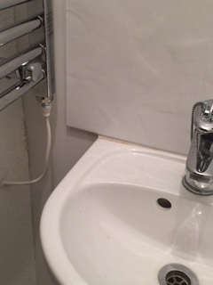

T Tracey Davies Joined 29 Feb 2016 Messages 2 Reaction score 0 Country 29 Feb 2016 #1 Hello I've just had some work done in my wet room. The electrician has placed the towel rail right next to the sink. He says that because it is IP55 it is okay. Any comments will be of help. Thank you in advance. Attachments IMG_0296.JPG 35.8 KB · Views: 1,098
freddiemercurystwin Joined 21 Jan 2007 Messages 27,723 Reaction score 4,796 Location Devon Country 29 Feb 2016 #2 Pretty sure that's OK but why not ask in the Electrics section?
C chappers Joined 27 Aug 2004 Messages 3,251 Reaction score 358 Country 29 Feb 2016 #3 if the connection is IP55 then yes
Admiral Property Joined 29 Feb 2016 Messages 2 Reaction score 0 Location Bristol Country 29 Feb 2016 #4 As above, it's likely in zone 2 of the bathroom, so IPX5 is recommended. If you want any more information, the zones and requirements are detailed here: http://www.denmans.co.uk/info_bathroom_zones.html
foxhole Joined 14 Mar 2006 Messages 25,084 Reaction score 3,940 Location Essex coast Country 1 Mar 2016 #5 Ok , but that looks untidy.
