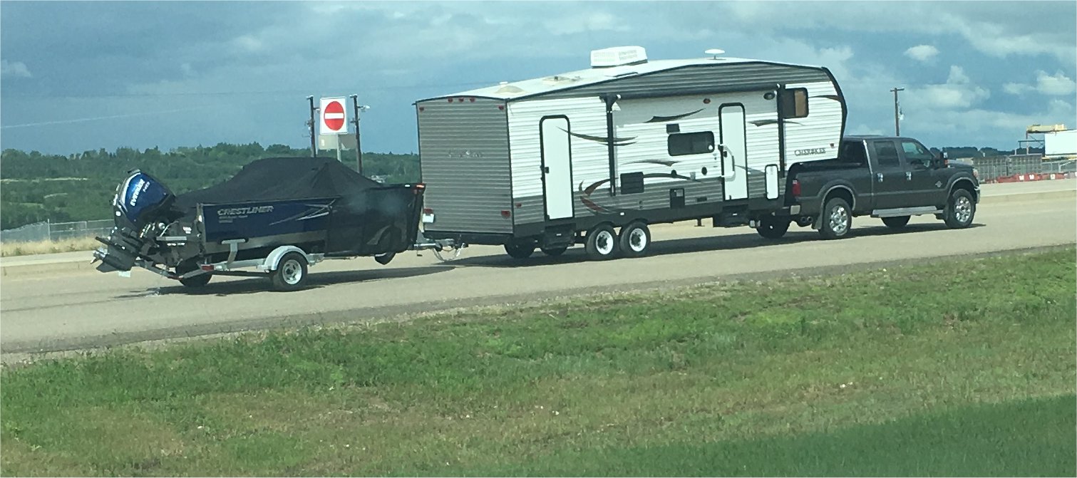

This is a picture of a friends caravan set up in Canada.
My question is "Would this be allowed on UK Roads". The set up is 70ft from Front Bumper to rear of the boat.

I've seen large caravans being towed by a saloon car and the caravan was towing a small/medium sized car. Both tow bars were of the fixed metal type though I have also seen one where the towed car had it's front wheels in a cradle attached to the rear of the caravan.
Yeah, it is all about definitions and the law is notorious for interpreting definition for the sake of winning cases and making oodles of cash. That is how the law seems to be setup, make it confusing so the barristers can make loads of cash arguing about what the loose definitions mean.
70 ft trailer like that of of my friend in Canada would seem unreasonable to me on UK roads. I am no nearer to knowing if it would be legal though.

Presuming that is someting like a F250 Super Duty it can handle trailers on its tow hook up to 21,000 pounds, and 5th-wheel trailers (as in the photo where there is a 5th wheel like on a lorry in the trailerbed) up to 27,500 pounds.
That's 12tonnes! of towing capacity.
So I guess it is not overwight in regards to its towing capacity, but no idea regarding UK rules. (And it would never fit down my local roads anyway).

It is legal Canada as the friend of mine tow this lot on most weekends. Still no idea if it would be legal in the UK!!!!!

Sorry that is what I menat to say. Legal in a lot of USA where I have seen it in use many times. Just dont know if you are allowed to tow 12tonnes in Uk, or use a 5th wheel in UK or (as per the queston) two trailers in UK.

If you could do the research into the weights of the vehicles involved then I can give you a definitive answer on whether it would be allowed in the UK & on what licence, but generally that setup would only be allowed if operated by a genuine & bona fide member of the 'showmans guild' brigade.

Can't see how any saloon car would be plated to tow that combined Gross Train Weight, I bet they were well over the towing limit of the car.
The car on the end would be classed as unbraked so would have to be 750kg or less to start with disregarding caravan.

leave the caravan trailer at home and you still can’t run the truck and boat on a standard driving licence in the UK. Truck 3,400kg boat 1300kg outboard 300kg = 850kg over without the trailer for the boat.
