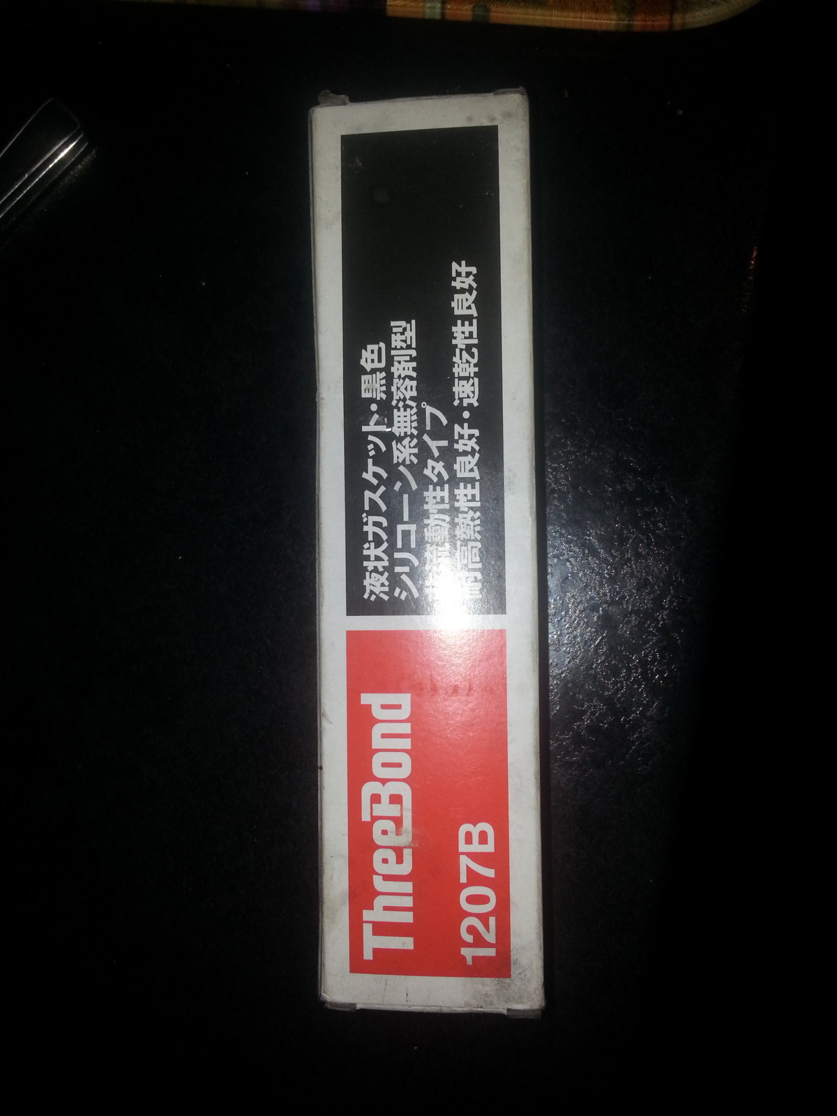

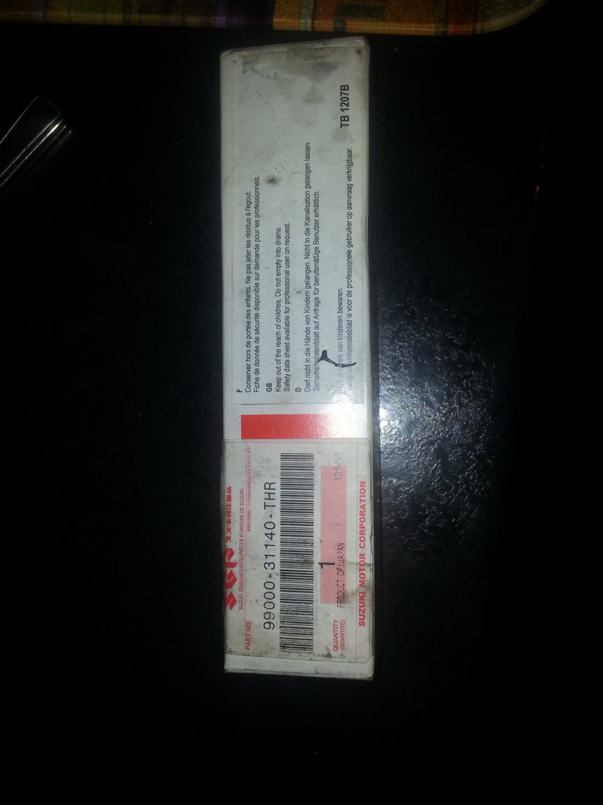

I'd use Three Bond, tube below costs around £12 (used to be nigh on £50 a tube!).
Best sealant you can buy imho, I use it on all out engine rebuilds. Suzuki specify it for crank cases etc (days work if you had to do the job twice due to leaks)..
Worth the money as a tube will las ages.

It's a mechanics dream John, never had any problems when using it and very easy to apply.
It is a variant of RTV silicone I believe but doesn't smell like "normal" silicone.
It's what they use in the factory when building the engines.
Well worth buying a tube to try!.
