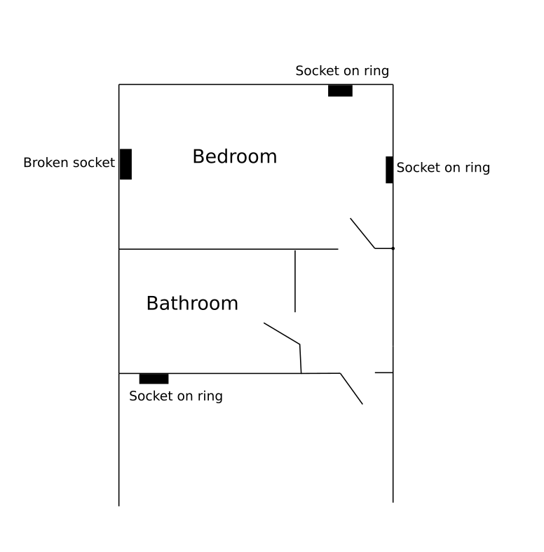

Well...It is an option. Not the most attractive one for obvious reasons! I’m also wondering where to look because starting from where the broken socket is, is the least convenient place to lift the floor (inevitably). I’ve drawn a quick sketch. I don’t suppose there is any usual practice which might make it easier (e.g. I’m wondering if it would be near one of the existing sockets)? I appreciate that is probably wishful thinking...

PS. Might I just double-check a question from my initial post? Would any of the cable finders that you can buy help with locating the junction box?
Another thought - are we even sure that the socket in question is on the same circuit as the other two sockets in the room?
If you know, or can determine, which MCB or fuse in your CU is supplying the other two sockets, you could 'switch that off' and then use your socket tester or multimeter to determine whether there was still 'mains voltage' between L and E at the problem socket.
