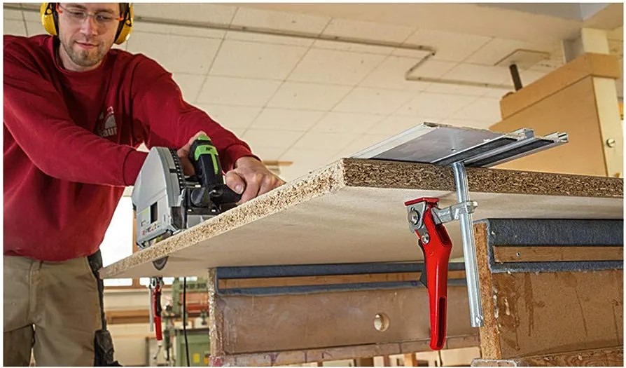

As others have said, pretty much every rail guided saw out there is right handed. You don't reslly need to watch the cut line because the guide rail* keeps it all in line in the same way the rip fence on a table saw does
Plunge saws on rails are primarily designed to break down larger sheets of material into components with minimal edge break out, as you will get on MFC (Contiboard) and the like if you cut without some form of anti splinter device. That's where the anti splinter strip on the rail comes in handy, but if you cut thin strips of material on the outside of this you get two potential problems - on many saws there is no anti splinter protection on the outside of the saw blade, and you need to account for the width if the saw blade kerf when marking or making the cut
By using an add on accessory such as the Original Waste Side Jig (2.2mm kerf example shown, but other kerfs are available to match your saw blade - different blades have different kerf widths) you can take account of the kerf width of the blade to make accurate size cuts. It works by helping you set the anti splinter strip on the guide rail a kerf width further away from the right hand side of the material, thus making qn accurate cut. TBH with experience you can pretty much eyeball this, I find
Some materials, such as MDF, won't spelch much, and for some materials, such as chipboard flooring a small amount of breakout is acceptable, but where it isn't the rail should be clamped in place and a 1 to 2mm deep scoring cut made before drawing the saw back to the starting position and making a full depth cut (some saws have a built in facility to deal with this)
Another technique for dealing with narrow cuts is to place a piece of same thickness material to the left of the piece you wish to cut and use that to support the guide rail. This works better if you join the two pieces together temporarily with masking tape as narrow steips can move - the key is to support the guide rail and also ensure the narrow piece cannot move whilst you are cutting
Whatever else youneed a flat, stable cutting base to be able to use guide rails accurately and effectively
* - guide rail = track. When Festool (the inventors of this concept) originally introduced these they were called guide rails. Track is a later term from the USA

I don't know which brand of saw you have, but quite a few brands have 700 to 1000mm rails as well. If you do a lot of very short cuts it can be worth buying a short rail and trimming it to the length you requre, but you'll always have some overhang at the start and end of the cut as it is necessary to support the saw. The clamps supplied with many saws are designed to slot into the T-slot on the underside of the rails and can be slid back and forth, although TBH the rubber "grip strips" on the underside if the rail are often sufficient to hold it in place unassisted, I find. Are you using guide rail clamps or something else?

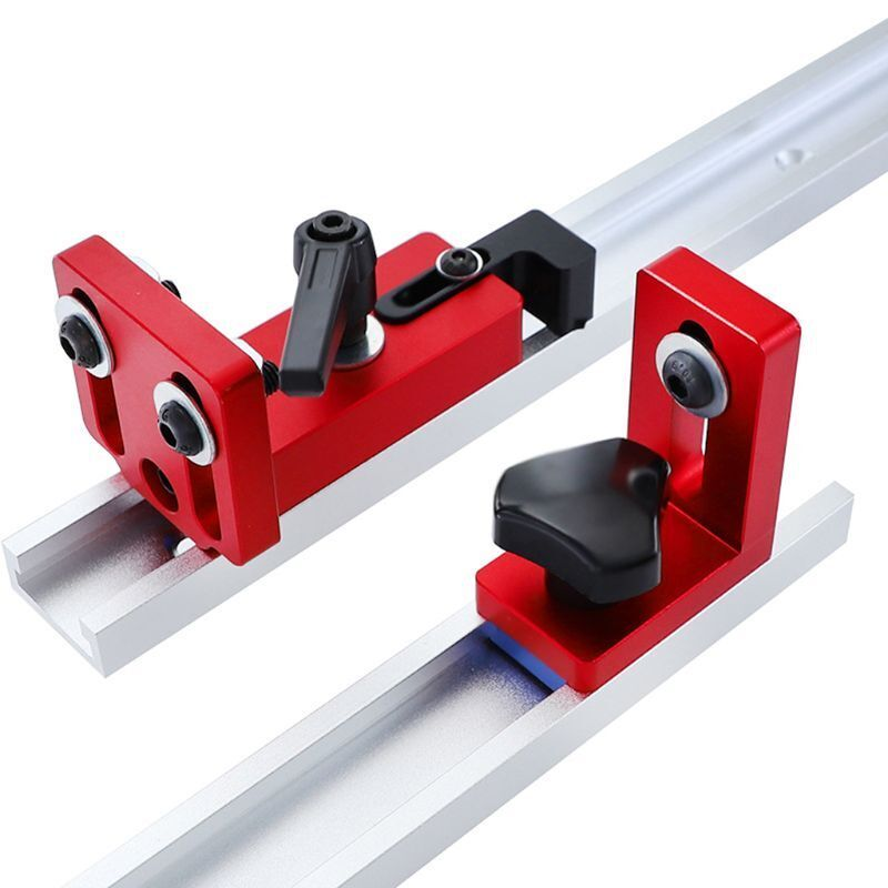

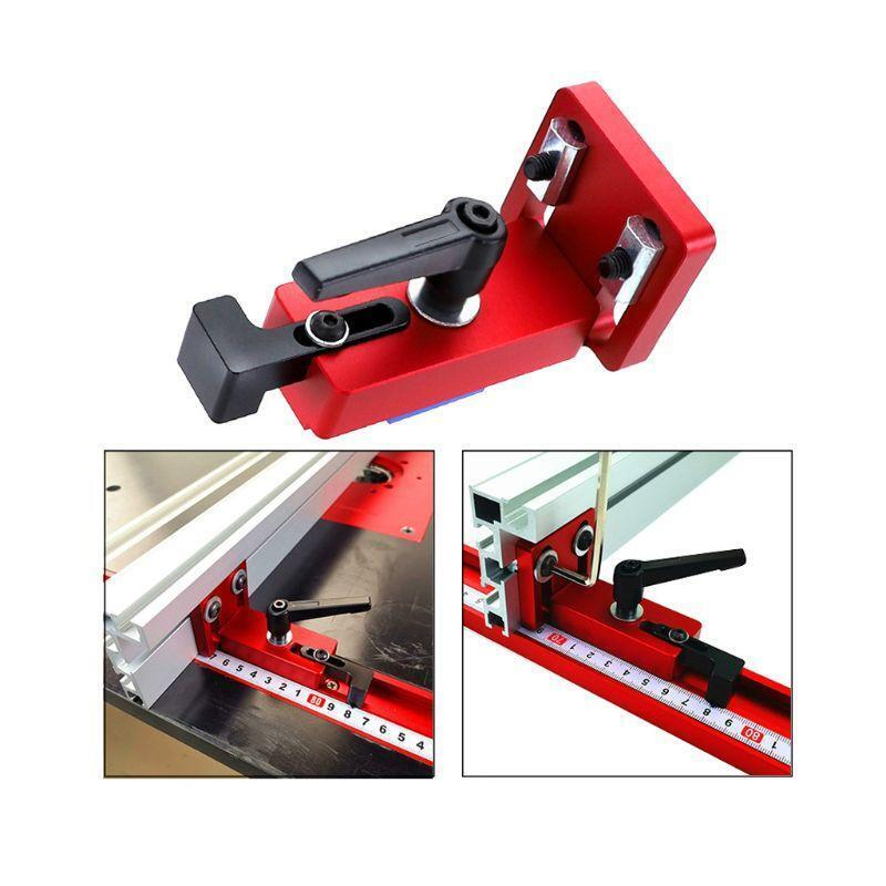

Could you use some sort of stop on the track? This will depend on the track though.
What sort if thing were you thinking about doing with those? AFAIK all manufacturers supply/offer rail clamps which fit into the slots on the undersides of the rails, as do some independent suppliers, such as Bessey, who make these:
