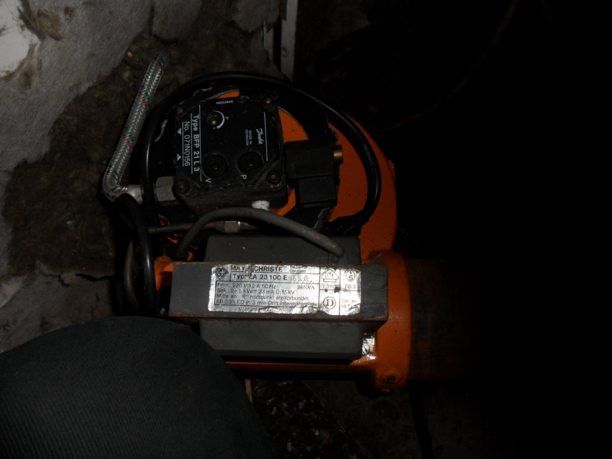

Hi = new here and come in desperation for help please.... Old Trianco 28/32 oil boiler playing up and now not igniting. I've spent a samll fortune replacing the time controller and the ignition controller, but still no spark in start up sequence. Relay closes, but burner faults out to reset mode. Heating engineer eventually arrived, stripped down the burner (looks like an Electro Oil International with 0.85x80 nozzle, but no further ident on unit). Engineer identified the lack of ignition was due to fault in the transformer, a May and Christie type ZA 23 100E. He says they are unobtainable now (??), and was clearly not interested in taking repairs further, and rushed off as soon as I'd signed his chit!, but checking on line shows they are still obtainable at highly variable prices. Before I waste another couple of hundred quid on a 30 year old boiler, buying a new transformer, fitiing it and finding I still have no ignition, I wonder if there is any way of verifying that this transformer is stuffed? From what I know of transformers they are usually not repairable. Or perhaps I might substitute another type of lower cost ignition transformer? The M+C transformer is rated at 240 v primary and 2x 5kv eff at 22ma secondary output. Any helpful comments PLEASE.... Driven me to the edge of despair and bloody cold after 10 days with no heat in house
Check the HT leads are not arcing.
Wire the TXFR to a fly lead to test or fit a link in control box base. Leave box off to test.

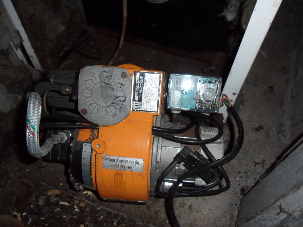

Photo of burner would be handy.
Firstly you can get bits for these burners and secondly I wouldn't pay the bill if that's the kind of fitter you got.If you don't want to mess about with that burner you could always consider fitting a new burner as IMHO triancos arent bad boilers and tend to last.Bob

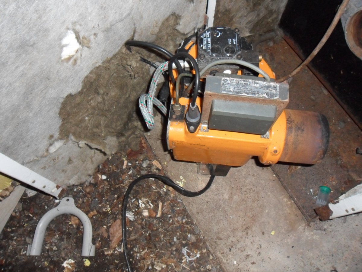

Thanks guys - pic of burner attached; upside down of course, but showing the faulty(??) transformer. I'll have a look deeper in to see if I can run a test on the txfr and check the HT leads... Having already spent so much on the new Potterton timer and the new Honeywell Ign Controller, which might not have been necessary, I'm kinda reluctant to abandon the burner if it was a simplematter of replacing the transformer (although the timer will work with any replacement). One of my concerns is that the pics I see on various websites selling these transformers indicate 2 distinctly different transformer types with the same model number (!) Don't want to drop another £100 and get the wrong one.... and one German web site wants about 400 Euros to supply it! SAM_2320.JPG
OK - managed to track down a reasonably priced supplier of the Ign Transformer - Greek (!) company called Kestakon in Covent Garden. Any knowledge of them? My big dilema is whether to spend another £100 on yet another part for this old clunker of a burner, or whether to replace the whole unit. I don't know whether its worse to scrap equipment and replace it at full cost when a cheap and simple repair could have sorted things, or whether to carry on throwing money at a never ending series of expensive componet replacements and still end up with non working unit. I'm at least £150 down on this so far and facing another £100 for a replacement transformer that may not be faulty and may not cure the ignition fault....honest opinions please, bearing in mind I'm a skint pensioner with a cheapskate attitude.... ? After the transformer replaced to possibly no useful purpose, what next? HT leads? Electrodes? Another £100 or more?

Isolate the burner electrically.Remove the control box and put a wire link between the live terminal and the transformer feed. reconnect the electric supply and the electrodes will spark, or they will not. If they don't, then the transformer is faulty.

You will get a continuous arc. Check the HT leads are not shorting to earth if no spark at electrodes.
Don't forget it is 10kv (It bites) !!
It is easy enough to disconnect from the burner. There are screws holding the feet; they need to be slackened off, and you should find the HT leads will pull out of the connectors. They are just HT lead screwed onto self-tappers in the transformer.

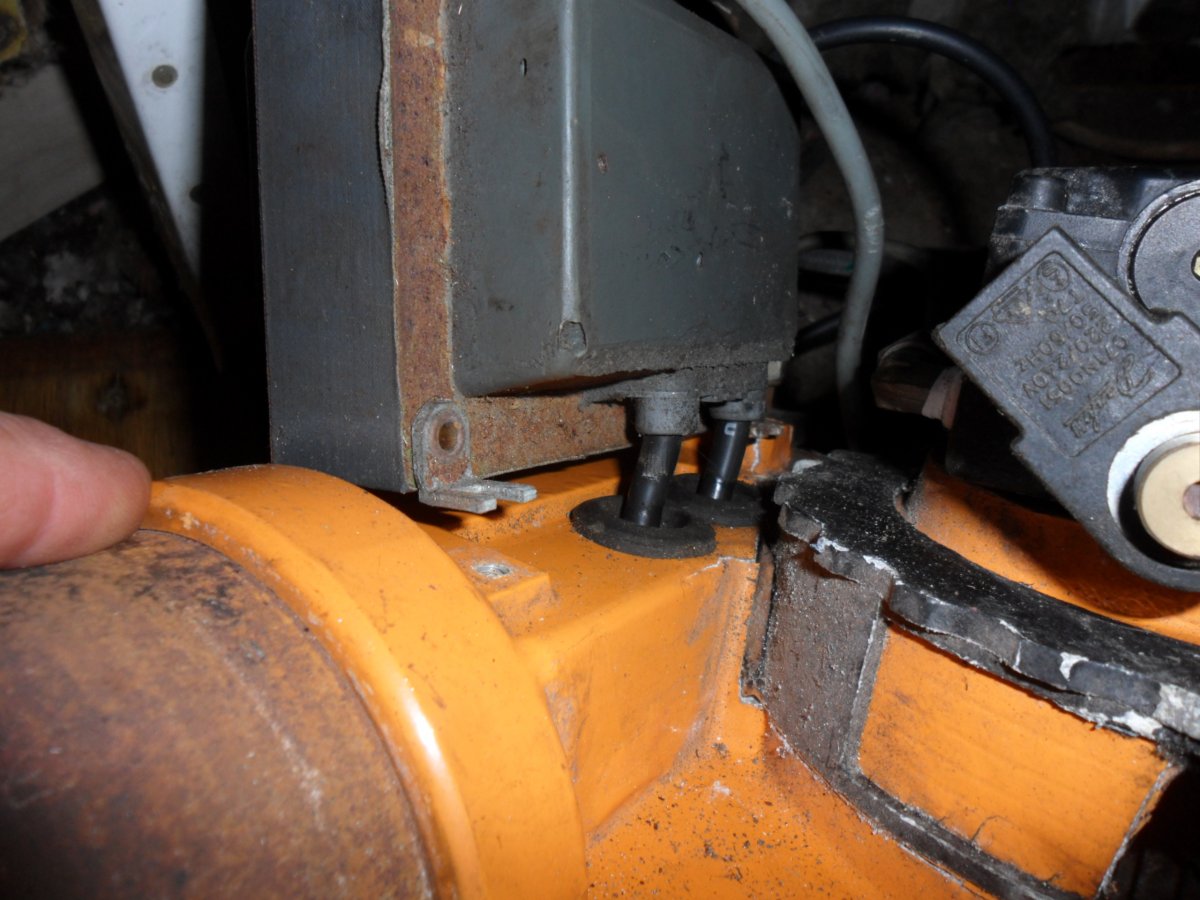

Thanks Oilhead.... easy enough to release the TXFR from the burner, but the 2 output lines are glanded through the casing and the transformer seems to gave some kind of plastic moulded casing enclosing the internals which isn't removable... see pic. Am I just being thick on this. I really didn't want to have to withdraw the burner head from the casing as that involved the oil lines and a whple new level of potentially fatal things to spring apart as I separate the burner from the casing...

Once loose, you should find the HT leads will move easily through the glands. If the cables are bonded into the transformer, then you can snip them as close to the connection as you can leaving sufficient to make any connection to a new unit.
