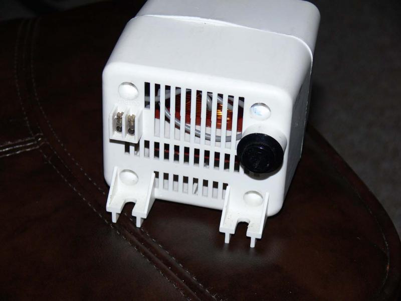

Thanks for reply Bernard. Photos below. So with the "~" it looks like 24V AC output. Is this a standard convention?
Yes, looks like a standard transformer AC/AC with no additional regulation of the voltage. It looks like the grey wires go direct from the windings to the two exposed terminals on the side?

I have tested the new fuse since I tried it in the tranny and that has not blown. The fuse is a small glass fuse. I have tried to read the markings on the end of it and I think it says 5A/250V but very tricky to see even under good light and with magnifying glass. The fuse holder is the black plastic thing on the right of this picture - on the opposite side to the 2 output terminals.
If you peer through the grill, can you see the wires that go to the output terminals?
Does one of them attach to that fuse. If so the fuse is on the output side. And in that case, the reason that the fuse has not blown is because you tried it with the shower disconnected. I'll bet that is you reconnect teh shower then the fuse will blow, indicating a fault with the shower, not the transformer.
The fuse is on the output side. I will try what you suggest tomorrow. Should I not get a reading on a multimeter from the output terminals though if the tranny is OK?
