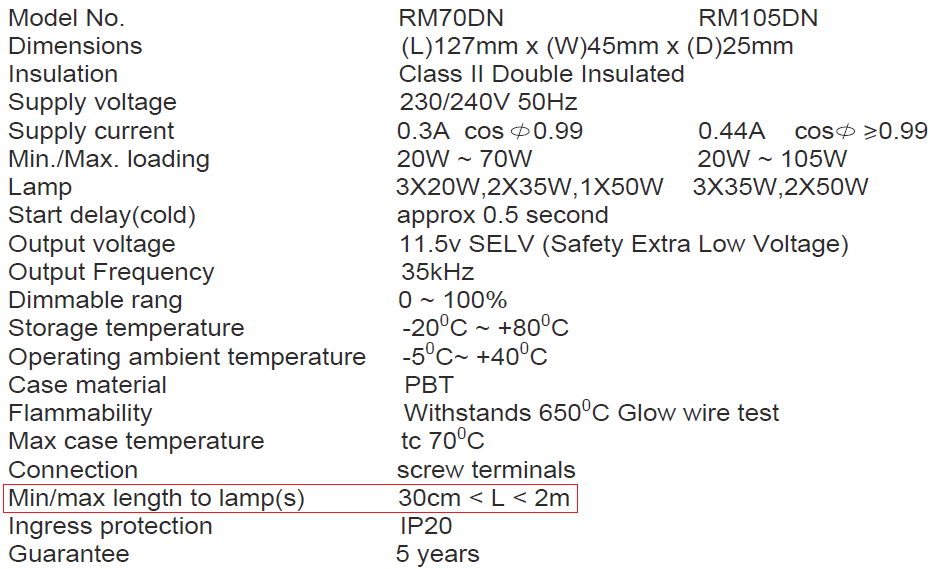

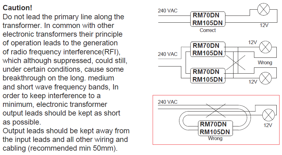

I think it's the amount of cable and 35kHz which is causing EMC problems.
What EMC problems has the OP reported?
None, but ericmark is reporting them.
The manufacturer seems to have gone to great lengths to warn about the EMC problems. From their documentation it would seem they are well aware of the problems using 35 kHz. That is why I raised the idea that the problem could well be due to cable length or routing.

Just to jump in mid conversation; I swapped the Screwfix unit out for a single output 12v jobby and full brightness has returned.
