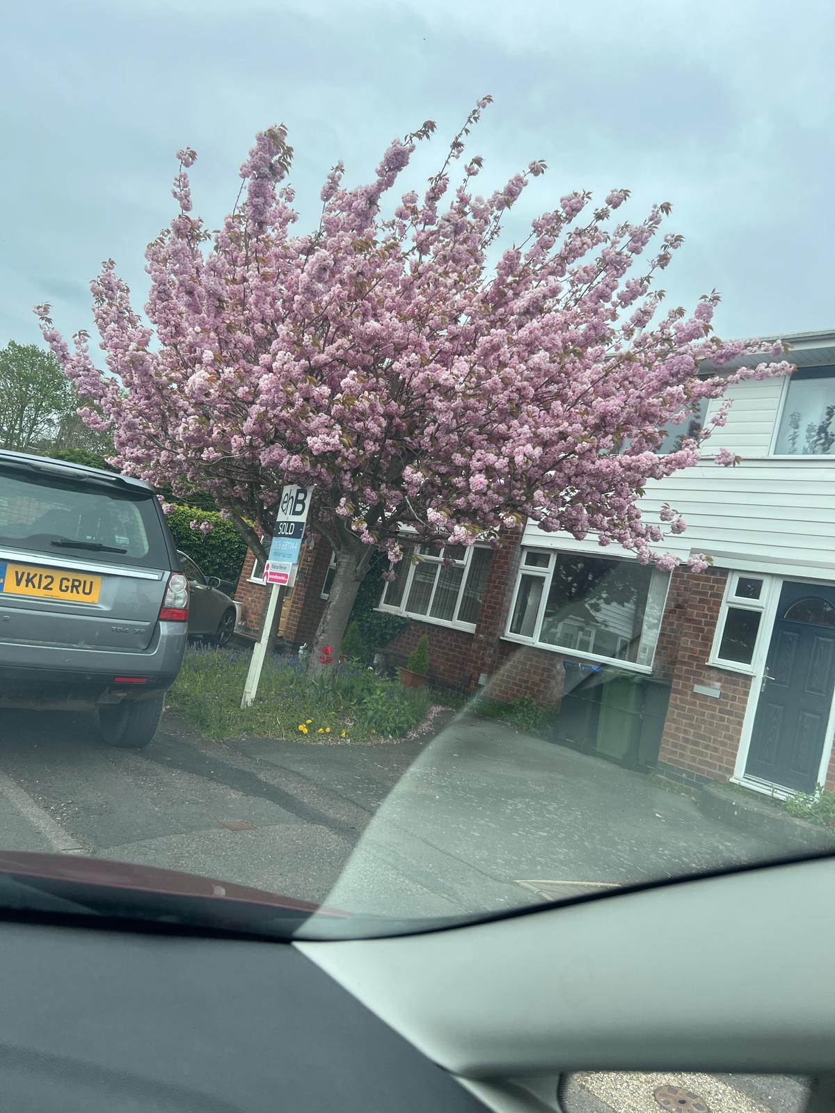

My lad is in the process of buying this house, and there’s what looks like a cherry blossom tree in the front garden. The next door house also has the same kind of tree, just visible in the pic.
The basic homebuyers survey didn’t mention the tree, questioned the guy and he said nothing to worry about.
No visible cracking anywhere internally/externally.
Reckon it’s anything to be concerned about or just keep an eye on it? It looks nice to be fair so no plans to get rid of it unless some horrible impact arose to the house in future.
I see you can get specific tree impact surveys but they’re not cheap and not sure whether it’s worth it here…
Depends on the soil type. Cherry is a moderate water demand tree, so with a high shrinkable clay it could be a problem.
There's your answer.
My view is outside of London, most cracking is caused by roots damaging the drains rather than shrink/swell of the soil itself. Certainly the vast majority of ground movement I see in the downwards direction is caused by drainage issues.
Thanks all. I don’t know the soil type, but on balance I’m not overly concerned
I would not buy any houses with a tree that size within 3m (front) to 9m (back) of a house, if the tree is small i would chop it down before it causes issues .
Issues: blocking out sun light, leaves shedding fills gutters and mess all over front of house, high winds could topple tree over the house and potential subsidence issues.
Sometimes the roots can grow under the foundations and dry out the subsoil underneath, causing shrinkage that makes the entire building subside. It'll depend what kind of tree it is as they all root differently.

That's a lovely tree in a terrible place. It's far too big, too close so could cause subsidence. Also you'll find out in the autumn that there'll be tiny purple plums with stones all over the place, and purple bird crap all over your car. And as pointed out above, the front room must be dark.

It actually looks a lot more imposing in the photo than it does in reality. All good points, will bear in mind. Would be surprised if a situation arose where the neighbour refused to cut theirs down if either was causing issues to the houses…
