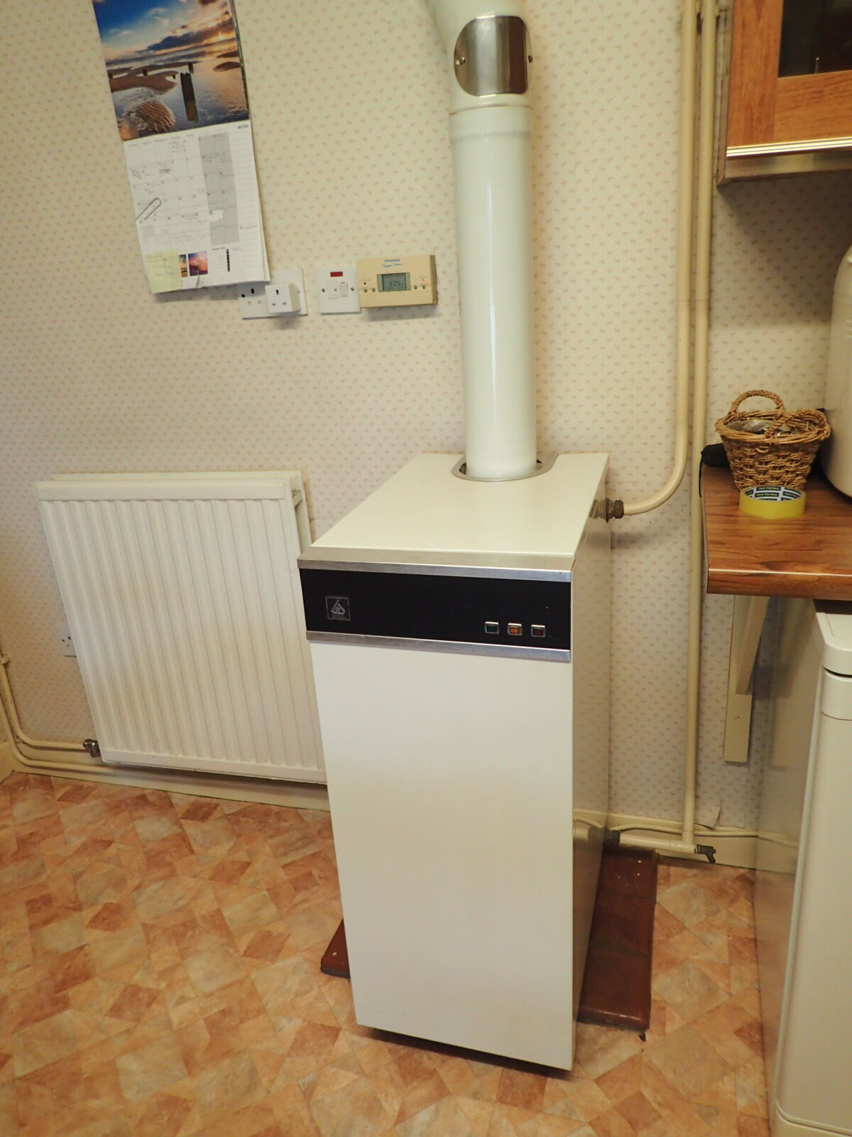

Oil Trianco 15/19. 36 years old
Thinking of replacing my boiler next year, What condensing Oil could you recommend ?
Would this get rid of the water tanks loft and airing cupboard ?
As the boiler is situated in the middle wall in kitchen with no other alternative without building work so would have to site condense pump ?
Some clear pictures of what you have would be useful. Take it it's a chimney flue?
If you really want to get rid of your tanks/cylinder you would be looking at a combi which may not be best option.
As for make we fit Grant's or hounsfield good option for smaller systems.
I would suggest you find a competent oil installer and talk through options.
Apart from the issue with condesate you have already identified to leave it where it is would need a complete new flue system.
We now try to avoid chimney flues wherever possible due to cost.
Room for a external boiler anywhere?
Despite its age, these are actually a pretty good boiler.....burner parts are still available as are thermostats etc.
You won’t get an original time clock though!
You won’t find a new boiler to be a great deal cheaper to run, but of course a combi does away with loft tanks.
No way to move without kitchen refit
Hounsfield Tuscan 12-19 would be my choice for a direct replacement. Avoid oil fired combi boilers unless you really really can't live with having a hot water cylinder
We will have the problem of the condense water discharge, as its on internal wall would have to have a pump up into loft exit down wall to outside drain,
if there is a pump to do this ?
