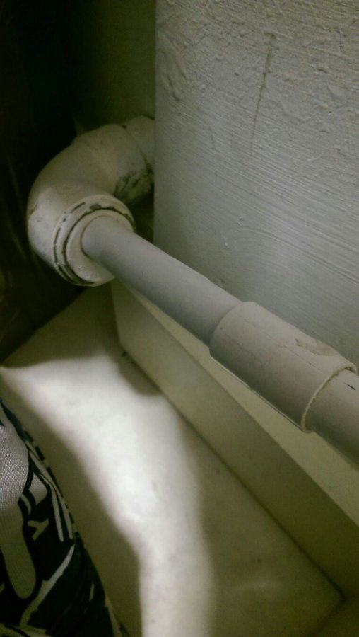

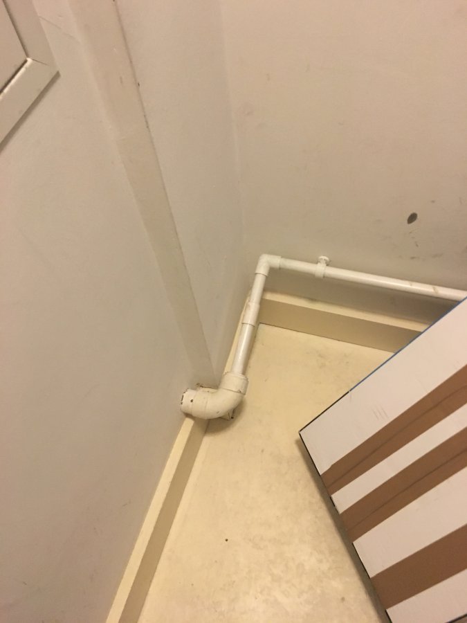

I'm trying to help a friend fit a washing machine in his flat utility room and I'm wondering what the best way to fit the waste is.
The current situation is a short stub of 1-1/2 in solvent weld, an elbow and immediately a reducer to a 22 mm hot water tank overflow. I've attached a couple of photos.
What I'd like to is extend the 1-1/2 in, put in a tee for the washing machine waste and leave some extra space for in future.
Is there any way of attaching on top of the elbow? Say, a flexible coupling or a way of butting a straight connector onto the elbow? Otherwise, it's very close to the wall into a shared space.

Cut the elbow off leaving as much inch and a half pipe as you can, did the wall out to expose a bit more pipe, clean the pipe stub and solvent weld a tee which will give two inlets, one for the washing machine upstand and the other with a reducer to connect the overflow.
That's all I could think of too. I was hoping there might be a trick or special part to save cutting into the wall.

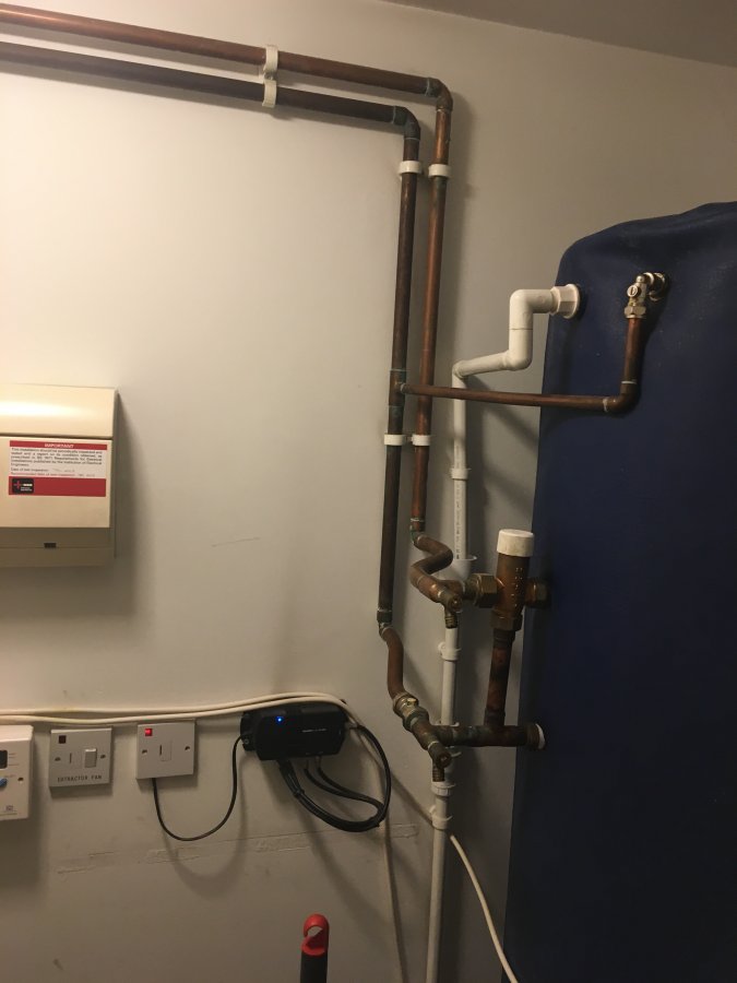

I'm intrigued, this 22mm overflow is from some form of hot water tank? Are you sure?
I take it whatever it is is flowing into the 40mm? From the first picture it looks like the 40mm is flowing down into the 22mm which I hope is just the camera angle.
As a curiosity, this is the 22mm further along, where it comes from the tank into a tun dish.2016-07-15 06.57.53.jpg
Ahah, that explains it.
I'm still wondering though if that 40mm elbow and pipe are running uphill? If it is that overflow wont overflow properly and it will need corrected before it's used as a WM outlet.
Before reconnecting the overflow I can check it flows properly from the tun dish, otherwise I'll increase the fall.
