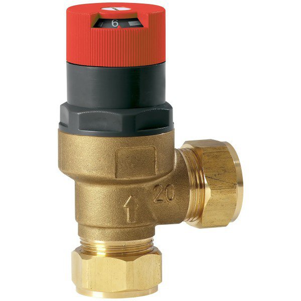

What would I be looking for and where
Manual valve will look like a stopcock, an automatic valve will look something like this.......
