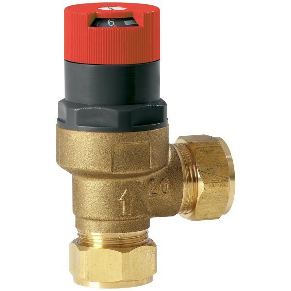

Manual valve will look like a stopcock, an automatic valve will look something like this.......
I guess you mean this? Must be manual from what you are showing
I dont think that is it. The valve will connect between the flow and return pipes of the heating circuit. Its purpose is to allow flow in the case of all the radiators being turned off to prevent burning out the circulation pump.

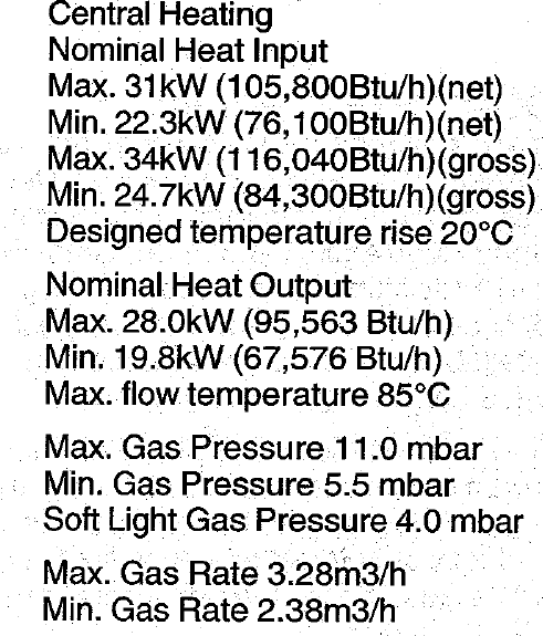

Compact 28 SE
OK then, some real info at last from the above......
The minimum output of that boiler is 19.8kw so IMO it must be cycling continuously and will never get the temperature up to its SP, in view of this suggest getting either a strap on thermometer and attach it to the boiler flow pipe or get a thermal gun to clear up once and for all what the flow temperature and boiler is doing. Ideally, monitor the return temperature as well.
