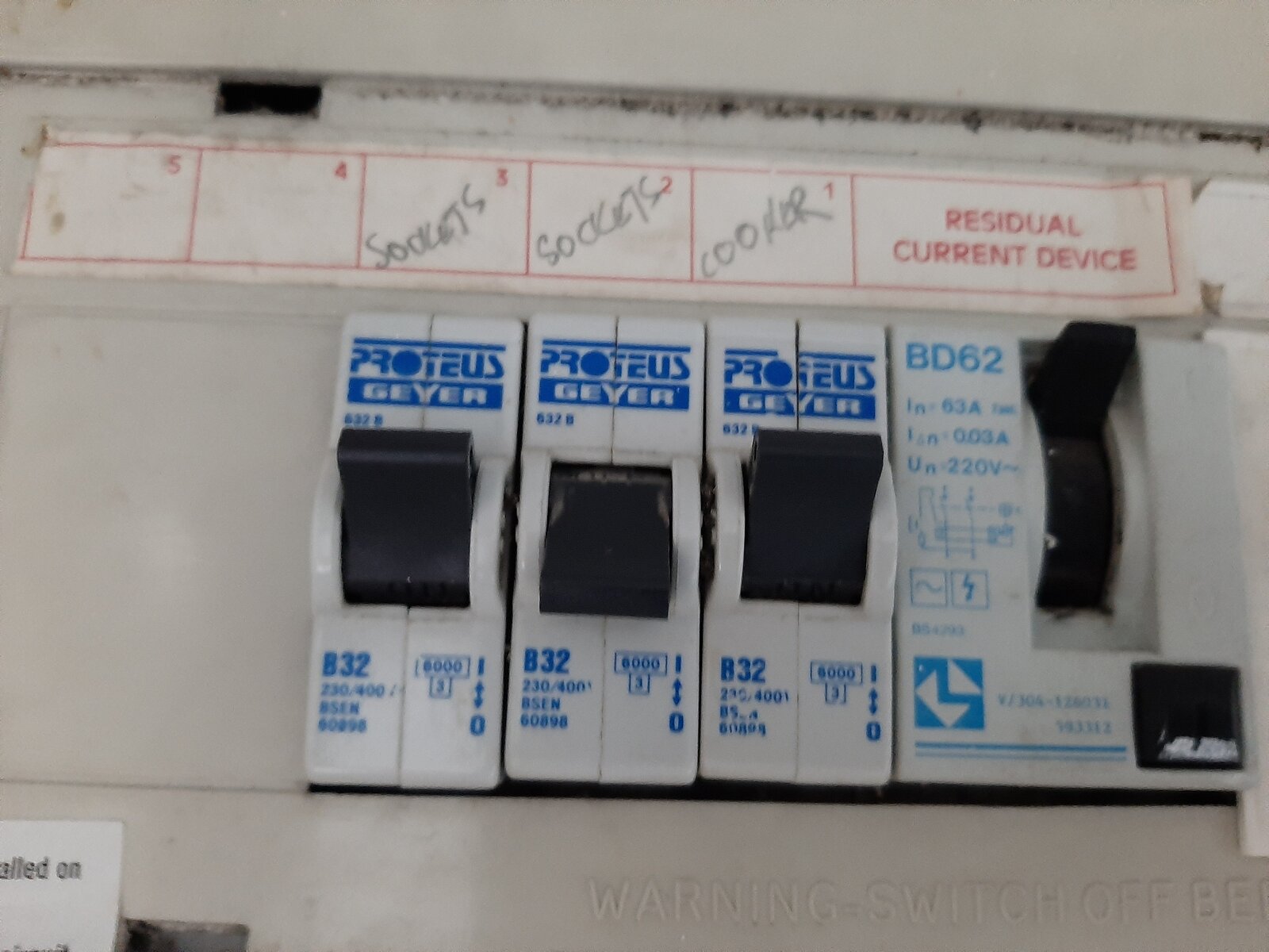

My kitchen socket MCB keeps tripping, I have been round and unplugged everything but it still trips after a while, I cant see any pattern to it at all just seems to trip under any load. All the other MCB's are ok. Could this be an issue with the actual MCB?

Can we confirm it actually is an MCB that is tripping, maybe its an RCBO, is there a test button on it?, what is the rating?. Post a pic if you not sure.
Hi,its the middle one. Sorry if my terminology is wrong
Your terminolgy is fine, but some people sometimes get the various 'devices' confused - hence TTC's question.

Hi, won’t come back on at all now, as soon as I flick the switch up the RCD on the right trips. Not changed anything since I posted
Update, found the issue. One of our double sockets was duff, the 2 Live wires were all charred, they was both secure in the fitting though. How does something like this happen please? The socket don’t move.
