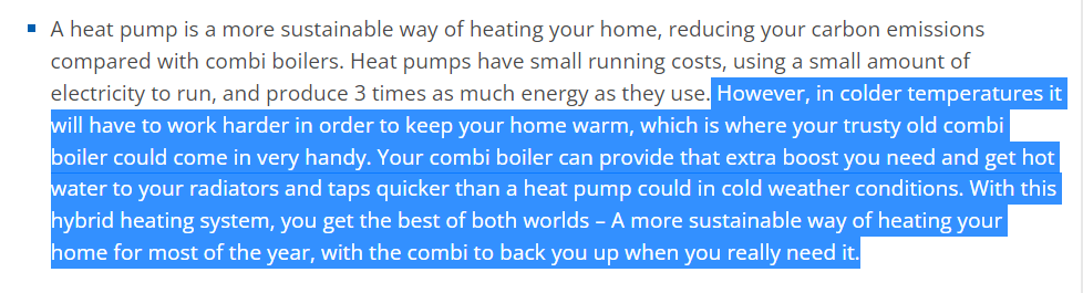

A combi will block you from installing other items such as solar or a heat pump.
Completely wrong
Do you honestly believe that installing a heat pump and a gas combination boiler in the same building is beneficial in some way?
What circumstances would require a gas boiler to 'provide that extra boost you need'? Who are these people with heat pumps installed that also require a gas combi?
The whole article reads as a desperate attempt to justify the continued installation of gas boilers where they are neither needed or wanted.
