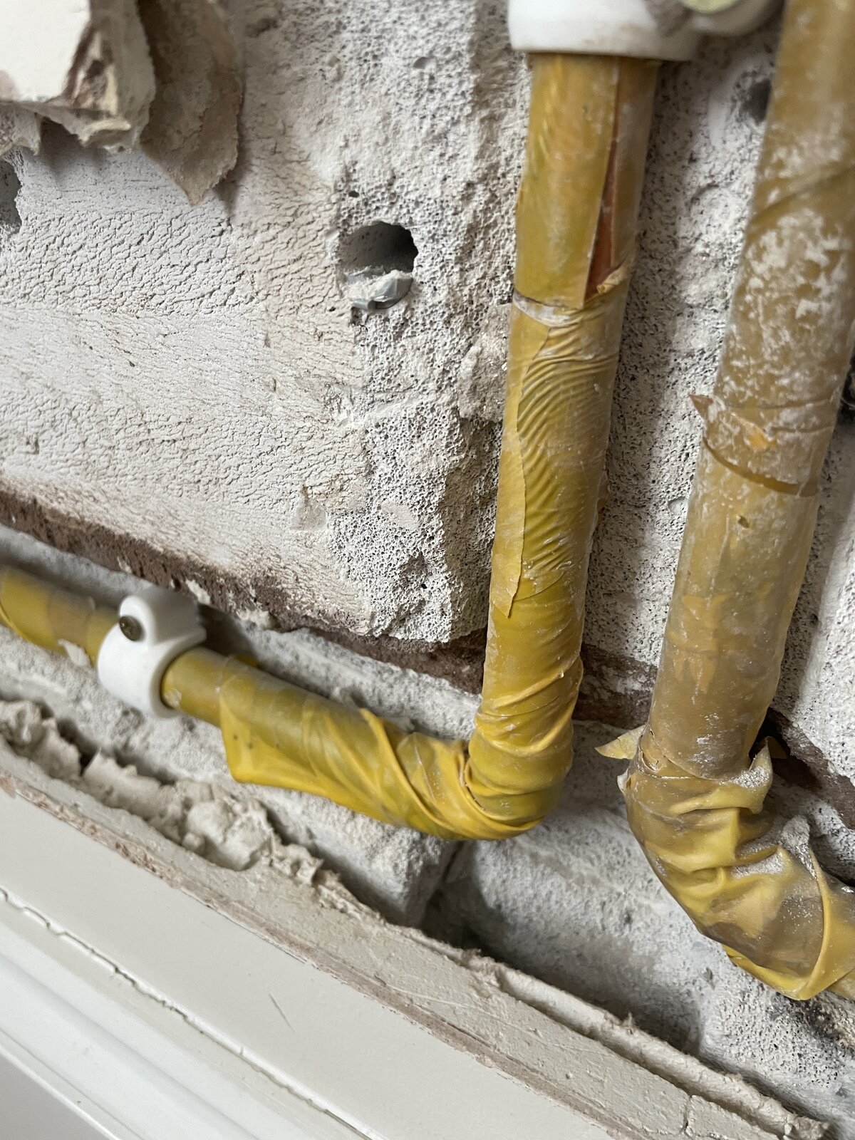

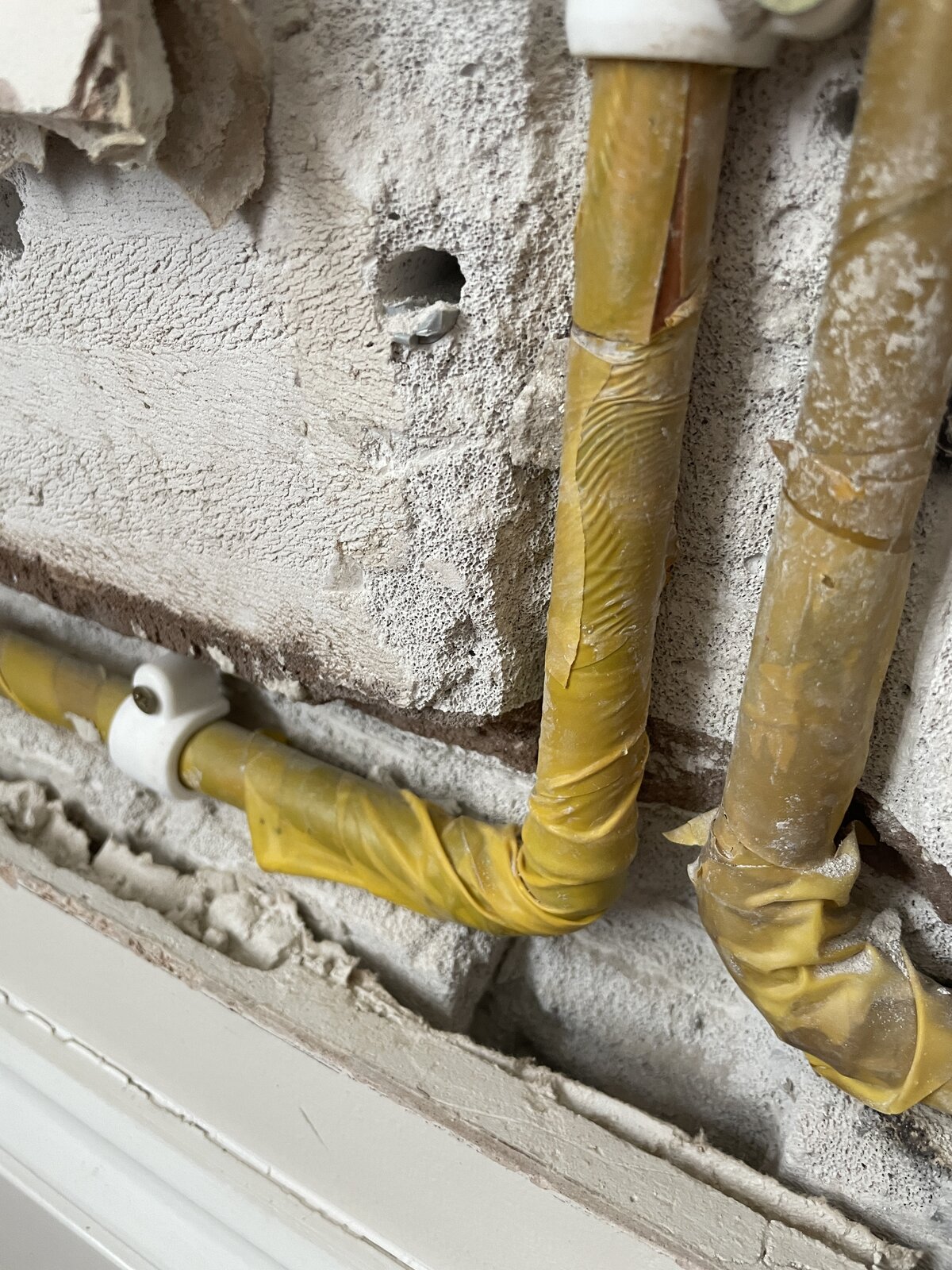

I’ve exposed some of the pipework as my new radiator will be larger than the previous and thus the pipe work will need extending
Does anyone recognise what this yellow tape is please that my builder used ~11 years ago ?
It feels quite tough but I don’t know if that’s as a result of the heat
Is it especially for covering pipes in brick work ?

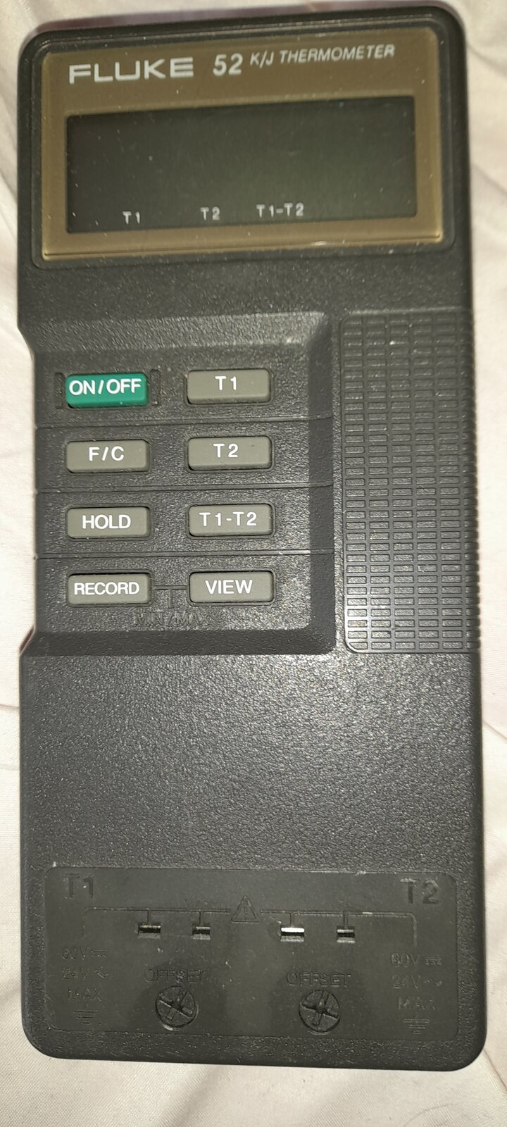

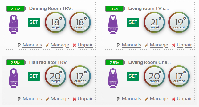

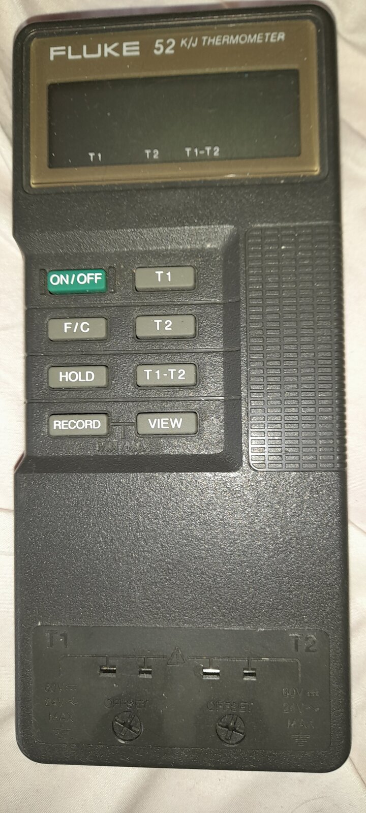

I found when setting up mother's system, with the TRV on the return the lock shield needs to be restricted more, so there is enough time for the TRV to work. I read all the things about setting up, using a differential thermometer 1722170249176.jpeg one should set the in and out with around 15°C but could I find the tool when I wanted it, no, even now found the meter, but not the plugs and sensors. So had to use another methods, lucky my TRV heads are connected to my PC so 4 TRVs-1.jpgI can see the target and the current temperature, so my method was to close the lock shield a bit at a time, until the current did not on start up (in first hour) exceed the target, and it worked, OK found the anti hysteresis software was a bit OTT, so 7 am set to 22°C and 8 am set to 20°C this worked fine. And it did take some time with a tweak here and there to get the rooms spot on, the meter method would have been faster to set up.

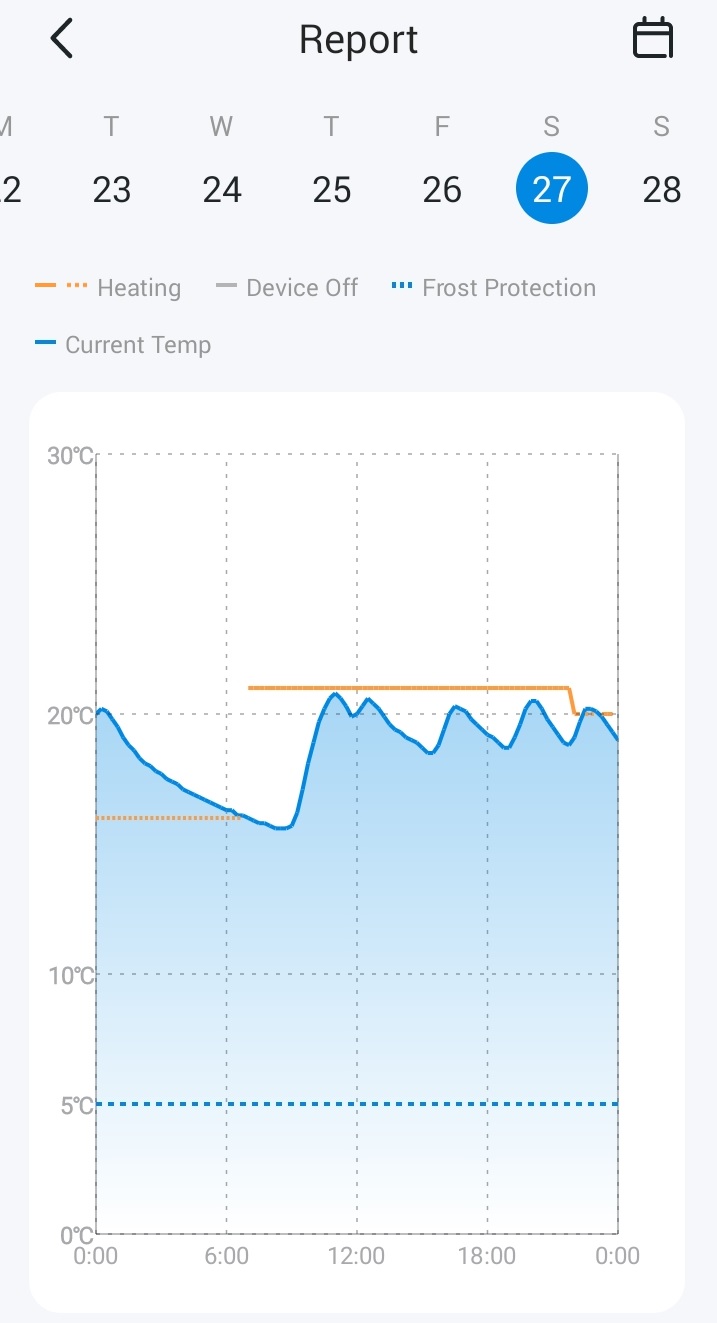

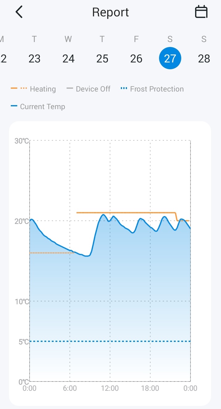

But the rooms with feed to TRV heated up faster than those with return to TRV, as with return to TRV the lock shield had to be set lower, as to how it would work with more expensive heads I don't know, the Wiser head is claimed to have algorithms so you set time you want the room to temperature, and it works out when to turn on.
My Kasa TRV shows me a graph, Report full day.jpgso I know how it has preformed during the day, my boiler is simple on/off oil, so will always be a hysteresis.
