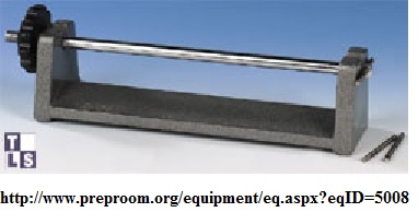

34 years BG the forces involved in expansion and contraction were demonstrated in the school laboratory using the bar breaking rig.
Small cast iron bars are used in this experiment, replacements can be found through many lab suppliers. Cast iron is used primarily because it is easier to snap than say steel.
The centre of the main bar may be heated directly with a bunsen burner. During heating, the main bar should expand slightly allowing the small bar to be inserted into the gap at the end of the large bar or on other versions, allowing a srew to be tightened, holding the small bar in place. When the bar cools down, it will contract to its original size putting immense pressure on the small bar until it snaps.
Copper pipe and lower temperatures mean the forces on the soldered jopints are considerably less than those that snap the cast iron bar but repeated cycles of forces from cycles of hot and cold do weaken the solder joints.

Bernie is somewhat guilty of extrapolation (spell?), I haven't looked at the link as yet, but the provided text actually says the bar used was Cast Iron - as it is easier to break!!!
EDIT: The address is NOT FOUND.
But, the device presumably demonstrated "metal fatigue", but that has sod all to do with your original assertion. Your story states that the firm who found the leaks recommended that the neighbours also paid for a repipe (presumably just in case". I assume and hope they were not so stupid as to go for it. Did they write to all the other homes in the UK piped in a similar fashion?
Metal fatigue occurs after repetative strain cycles, the bar snaps first time.
