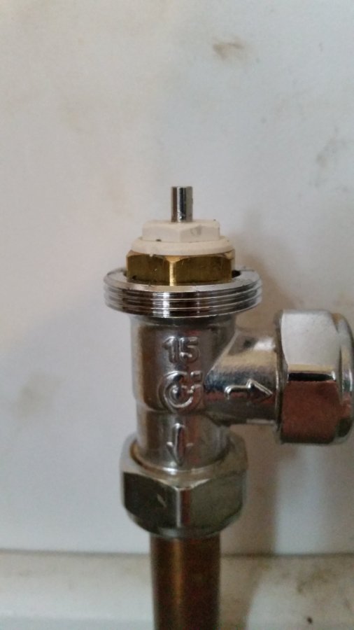

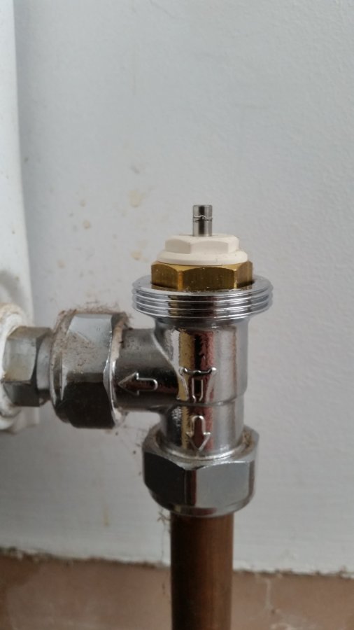

If the valve is not fully open when set to max (V) (assuming the room is not extremely hot), the pin projecting from the body must be too long, which implies the head is incompatible with the body.

Some pics of the bodies of two TRVs in case it helps:
Will have to check the balancing properly next time.
That's definitely a Caleffi body; you can see the logo on the left pic.
Just wondering if it's an old body with an incompatible head for a newer body.
Some Caleffi valves have a threaded insert adapter (spacer) that fits over the white valve nut, inspect the good working valves to compare and check if these are missing otherwise without them the pin will be always pushed down and water flow shut off.
