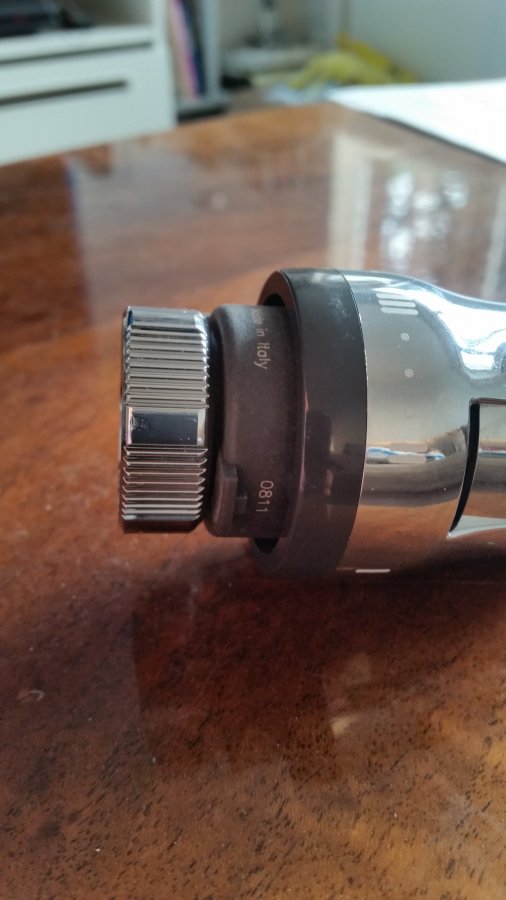

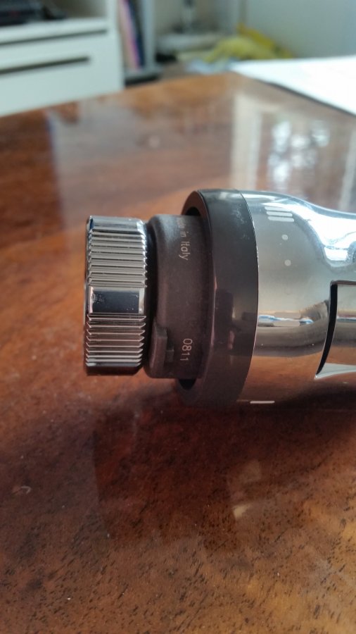

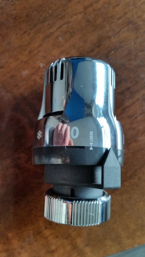

Ok here's some pics of the TRV - no model markings that I can see, just '0811', which doesn't appear to correspond to a model.
As mentioned by MrTherm it indeed has a screwdriver slot to lift up the body and allows you set a different max temp, but this has not been done on any of the valves.
(I did find some Caleffi instructions at http://www.caleffi.com/sites/default/files/file/01034_na.pdf which cover this)
Also after I'd spent some time trying to think of Italian synonyms for "maximum" starting with V, I've just realised that the V marking is not a 'v' it's a roman numeral '5' - doh! I'm just not used to 4 being written IIII ...
Then I tried screwing a Honeywell TRV onto the old body, but this exhibits exactly the same issue, so I can only think that TRVs are not fully open when on max and that there must be some lack of pressure in the system affecting the downstairs rads. Any thoughts on this?
The heads may be Caleffi, but are the bodies?
Are the downstairs TRVs same as upstairs?
Can you post a pic of a problem body, showing any markings?
A TRV should be fully open when the room temperature is more than 2C below the value set by the head. So, with the head set to V, the TRV should be fully open below 26C (V=28C for a Caleffi head).
