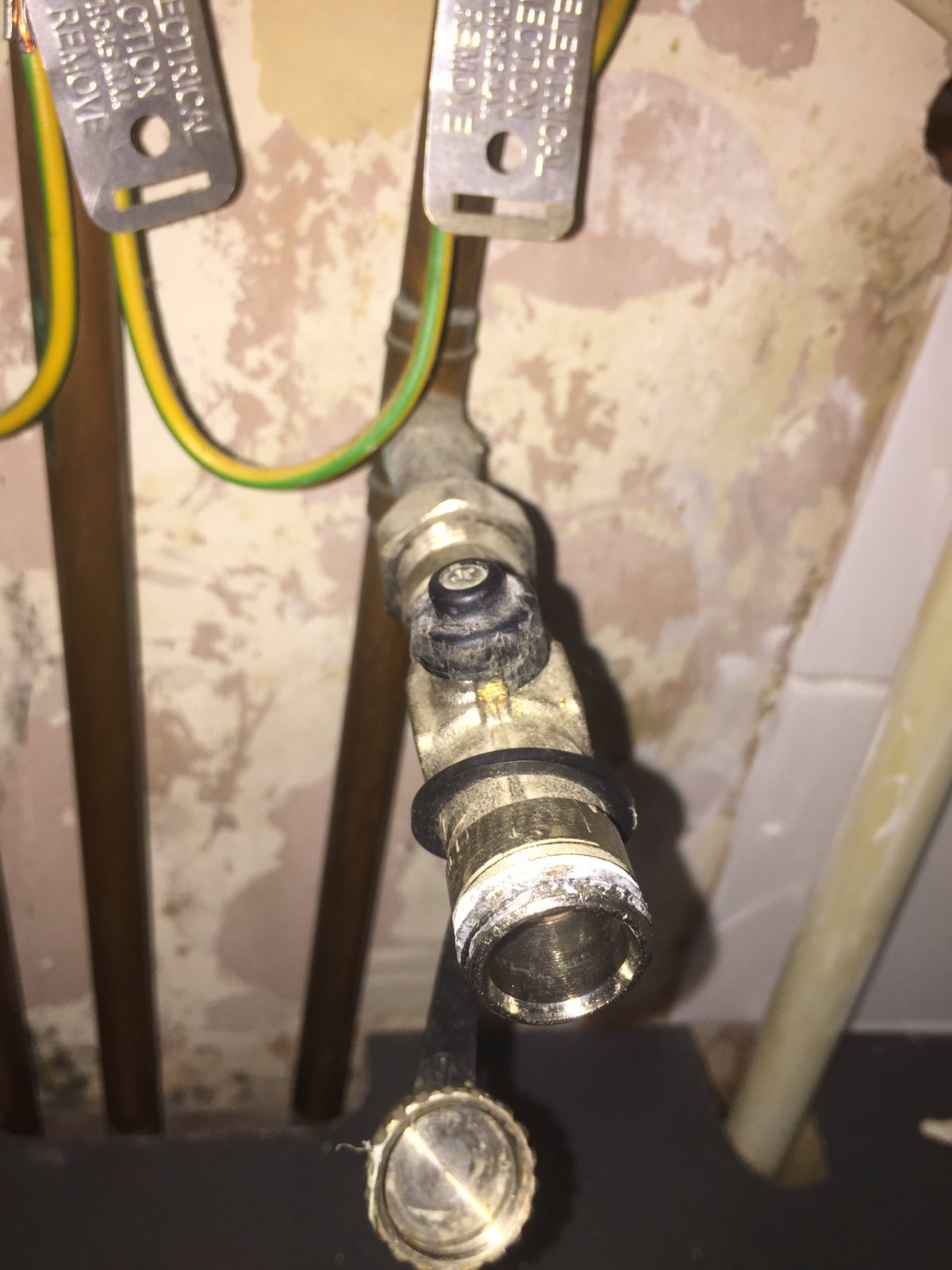

Hi, I'm trying to top up the pressure on my Vaillant combiboiler (Ecotec Pro 28).
I've watched a few videos and I think I know which pipes to connect with the filling loop, but I'm not sure. I tried and the pressure didn't rise, although I don't think I heard water flowing like in the videos.
The pipe which the water comes out of when I turn the tap is labelled as "C H flow" with an "out" arrow, and the water smells and is hot. Is this the right pipe?
I connected it to the "cold water mains / cylinder return" which has an arrow pointing in.
Any advice would be helpful. Thank you!

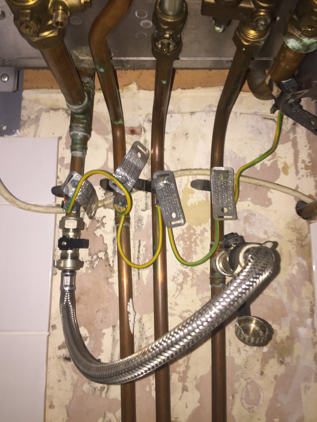

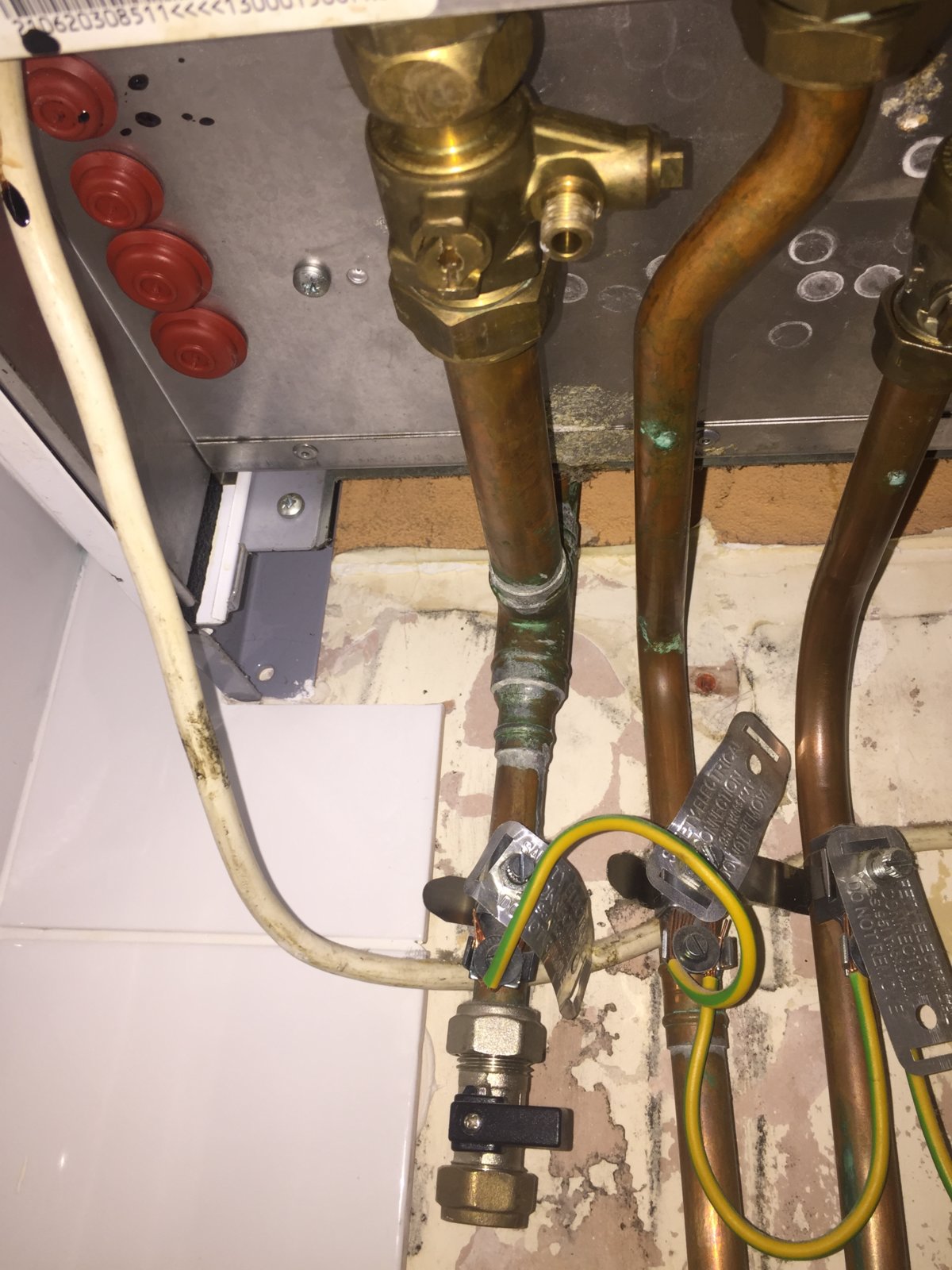

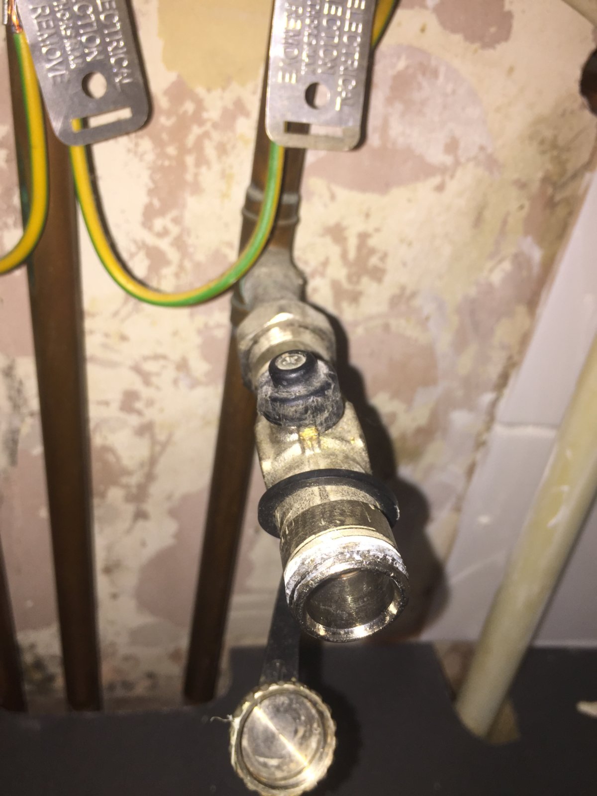

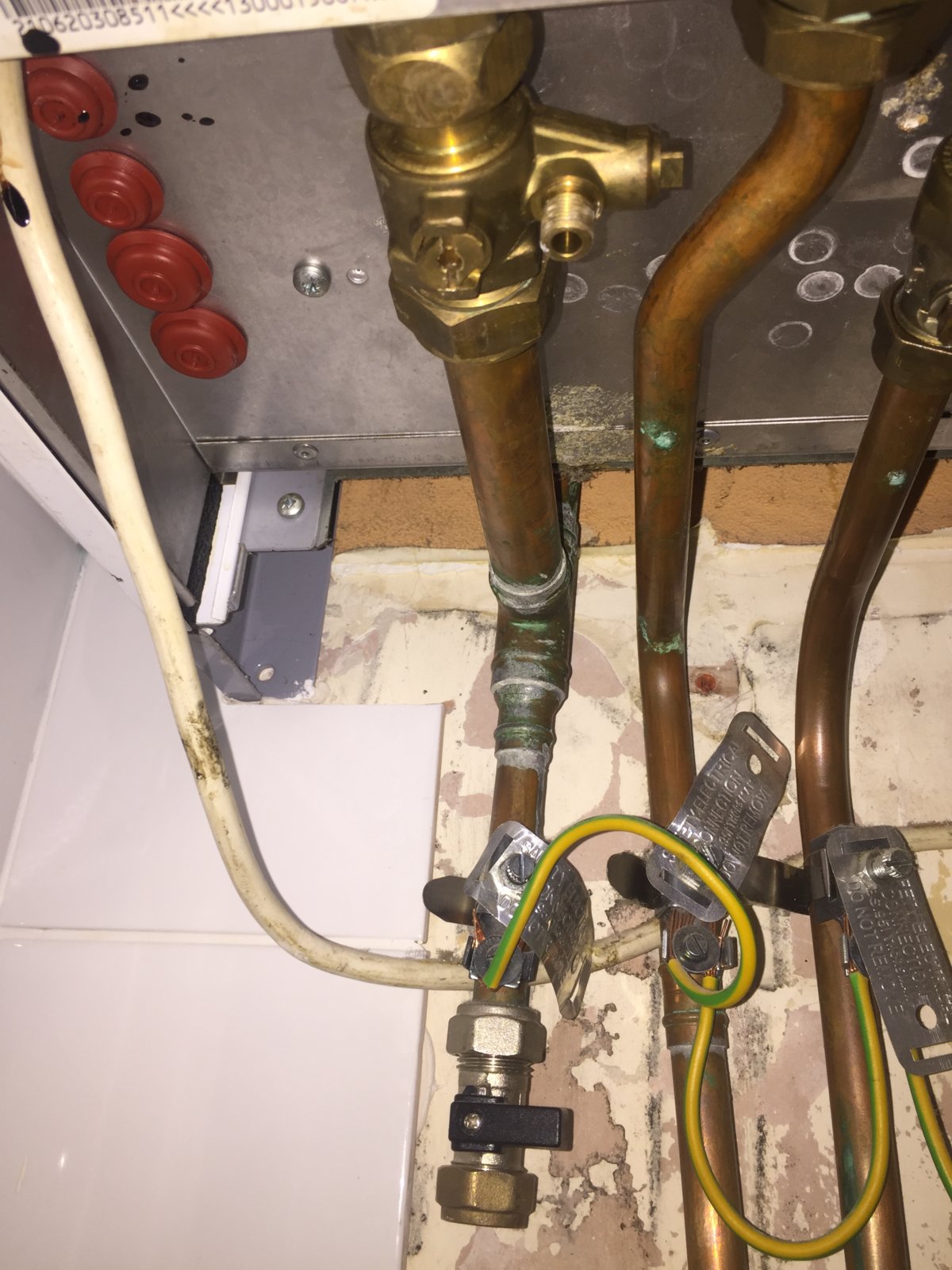

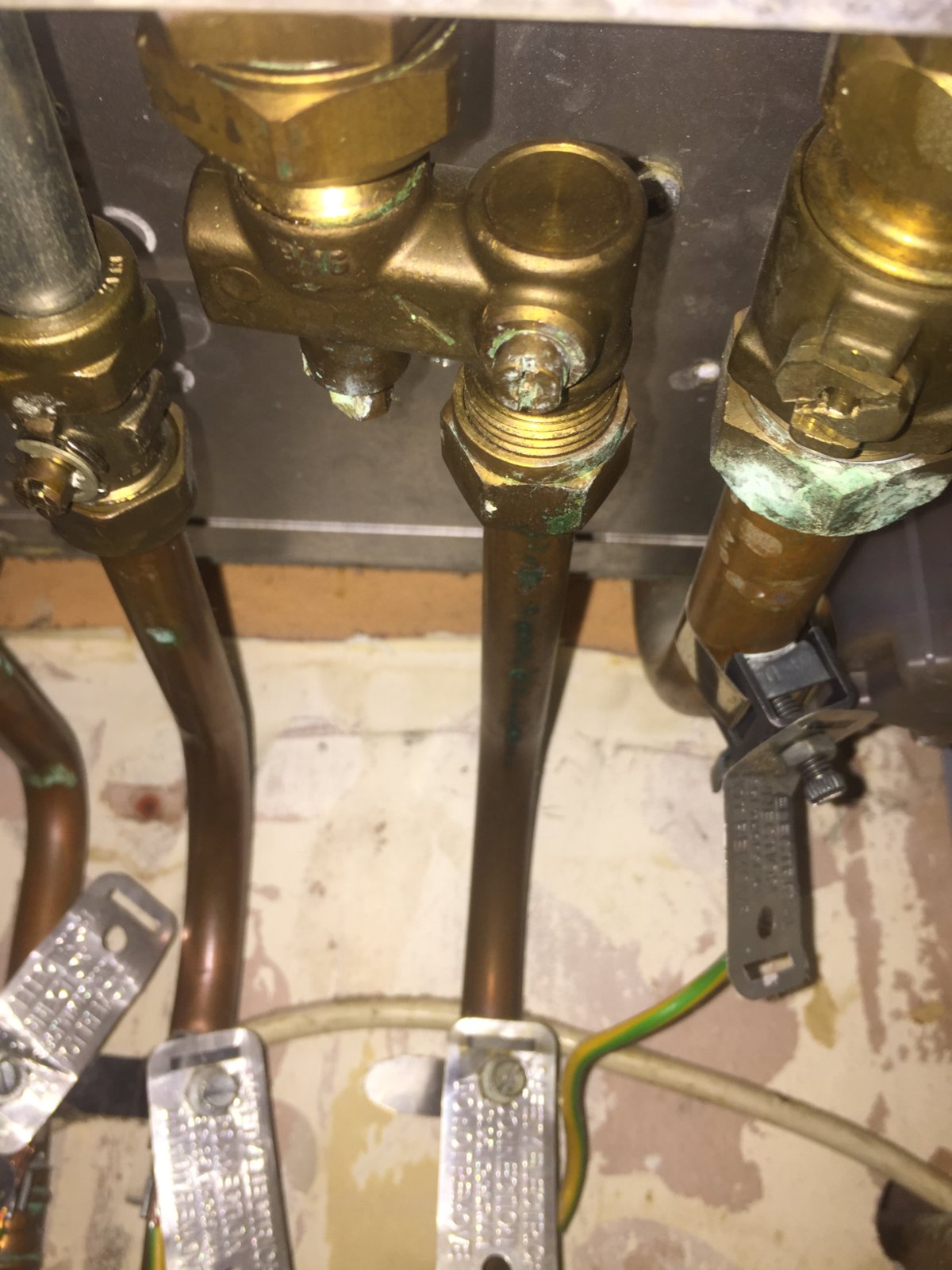

Here are the pipes
the one on the far left is where the water came from, and I had it going into the 4th one along.

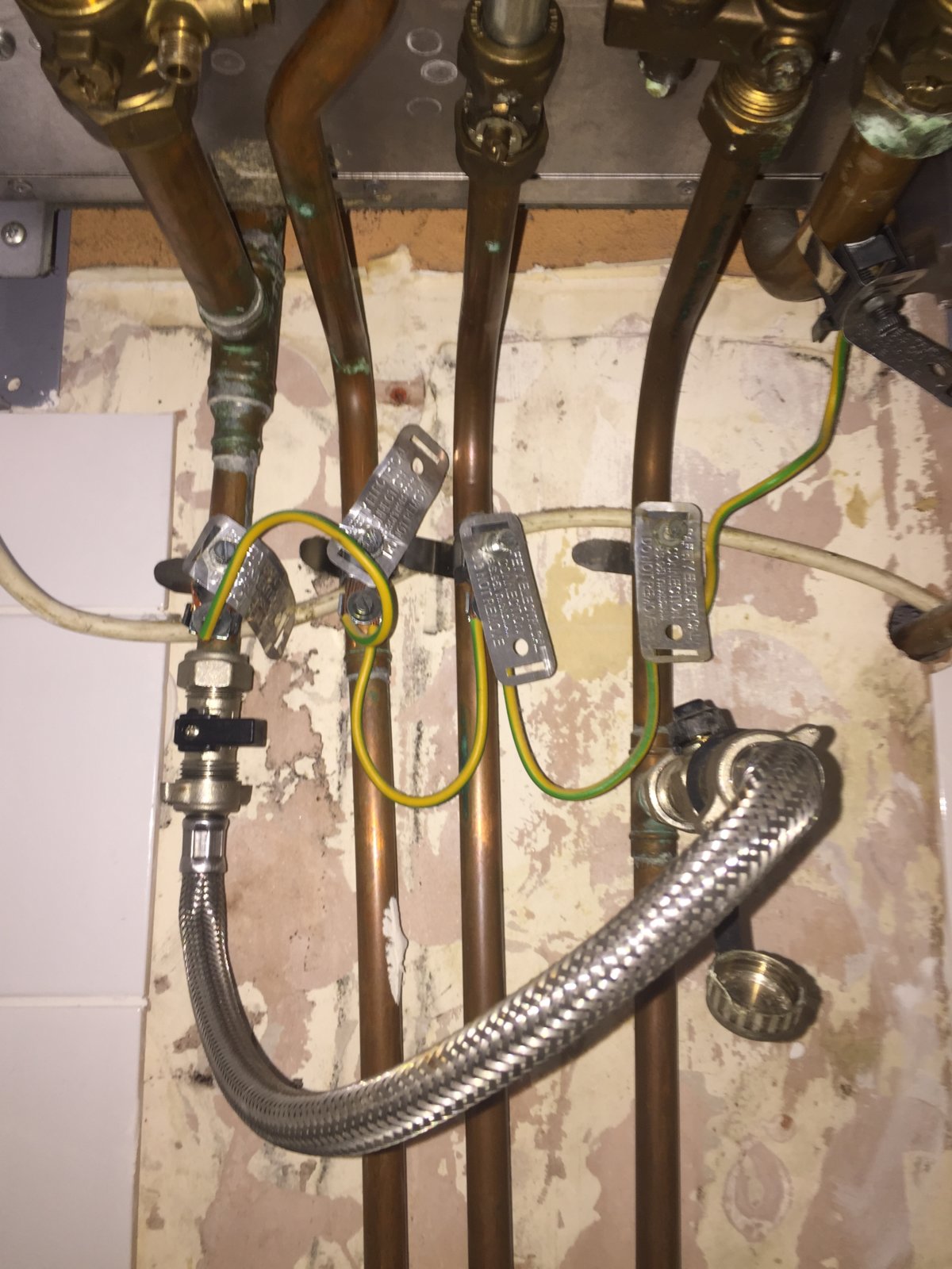

This is what I was trying
Yes that connection is correct. Does the valve on the 4th pipe ( cold mains) have a lever like the one on the left ? Both valves need to be open for water to flow into the boiler. I can't see the one on the right very well in pic.

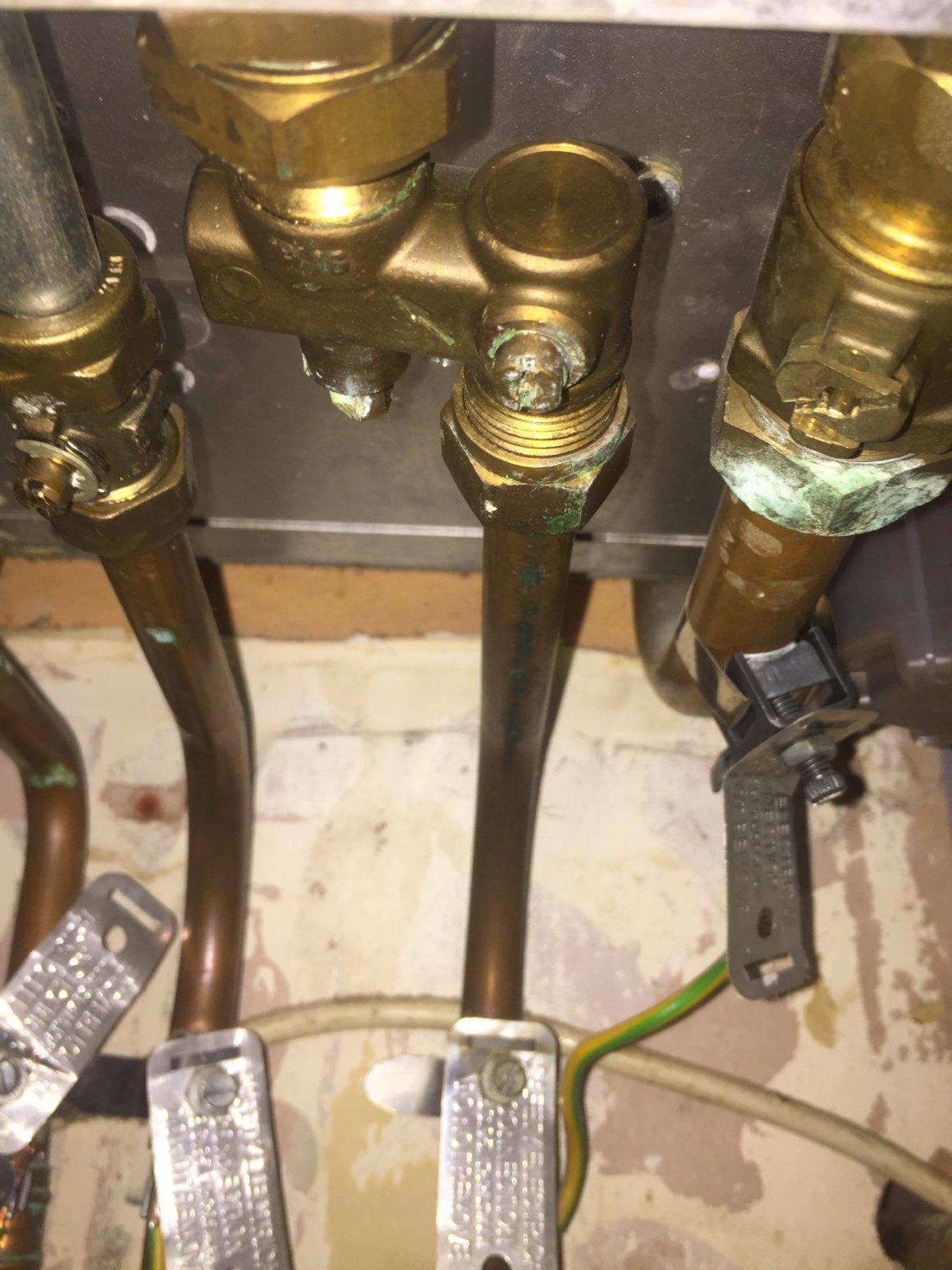

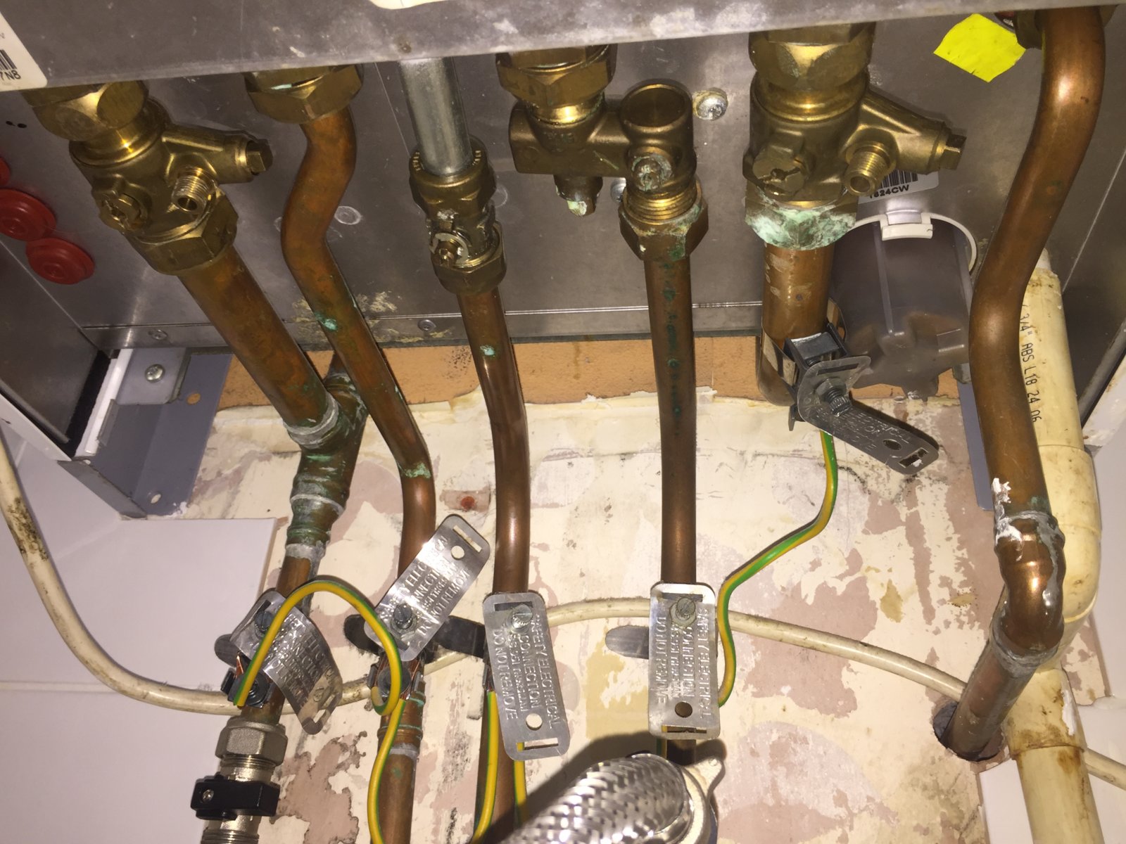

It doesn't have a lever. Here are some better pics of it:
Looks like the lever has broken off. Its the black plastic bit on the top ,with a screw ( cross head type) in the centre. If you have a set of grips to turn it 1/4 turn it should open the valve and water should flow. Connect the braided hose both ends first !
Ah yeah, turned that one and it worked. Brilliant! Thanks so much for the help Terry.
