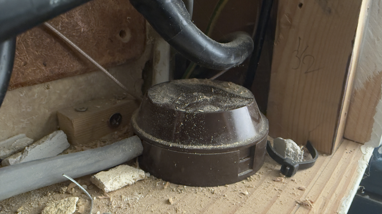

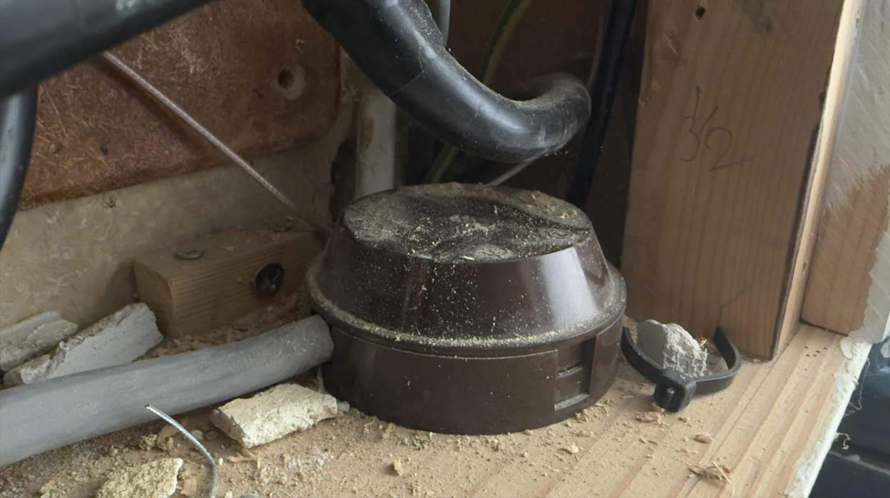

We bought a house about five years ago, and it has a freezing cold kitchen, which we later learned has underfloor heating that was apparently damaged during a flood. Something tells me this isn't the case, and that it was just the electrics above surface that got damaged. I have done some investigation, and have uncovered a junction box under the kitchen cabinets that feeds into the wall. It's 6mm T&E.
Here you can see it going into the junction and emerging from the wall. This is under the kitchen units. It's not live.

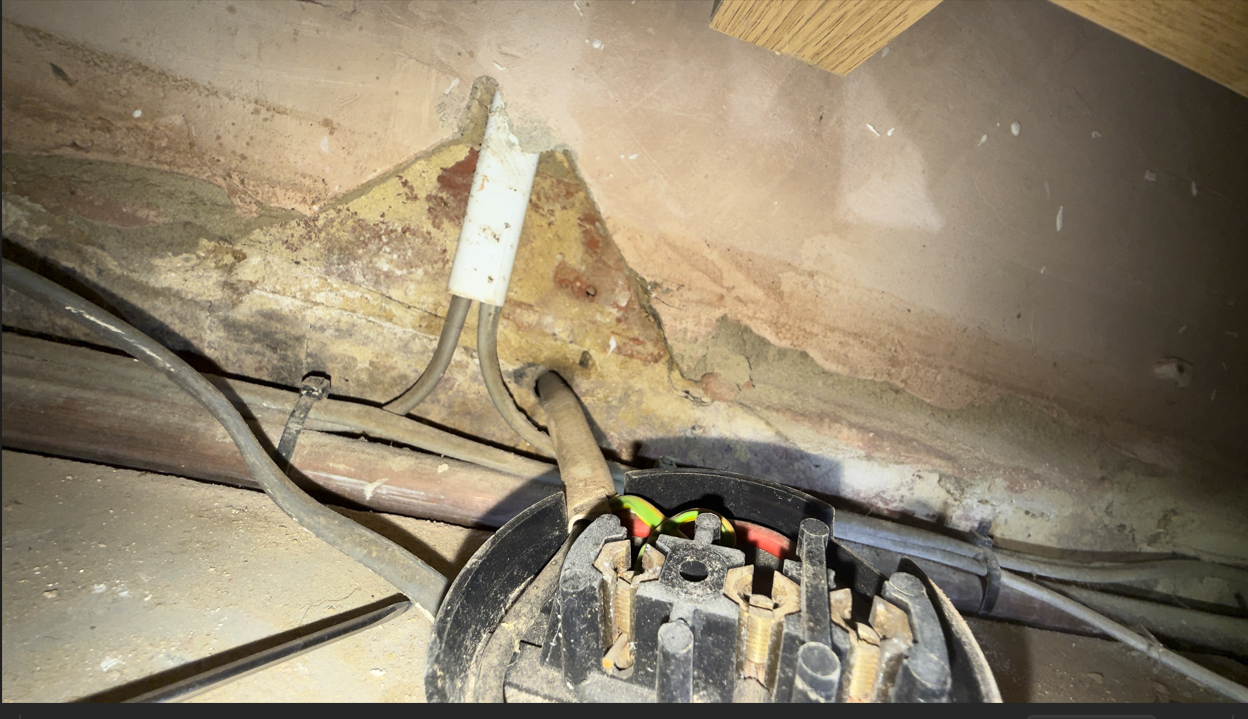

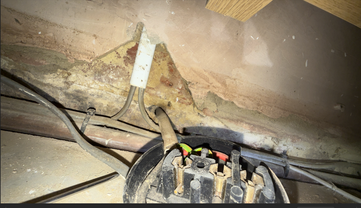

At the consumer unit, the cable emerges, and goes into another junction box, with another piece of 6mm coming out with "underfloor heating" written on it. The cable has been cut and taped. Presumably, this went into a breaker at some point

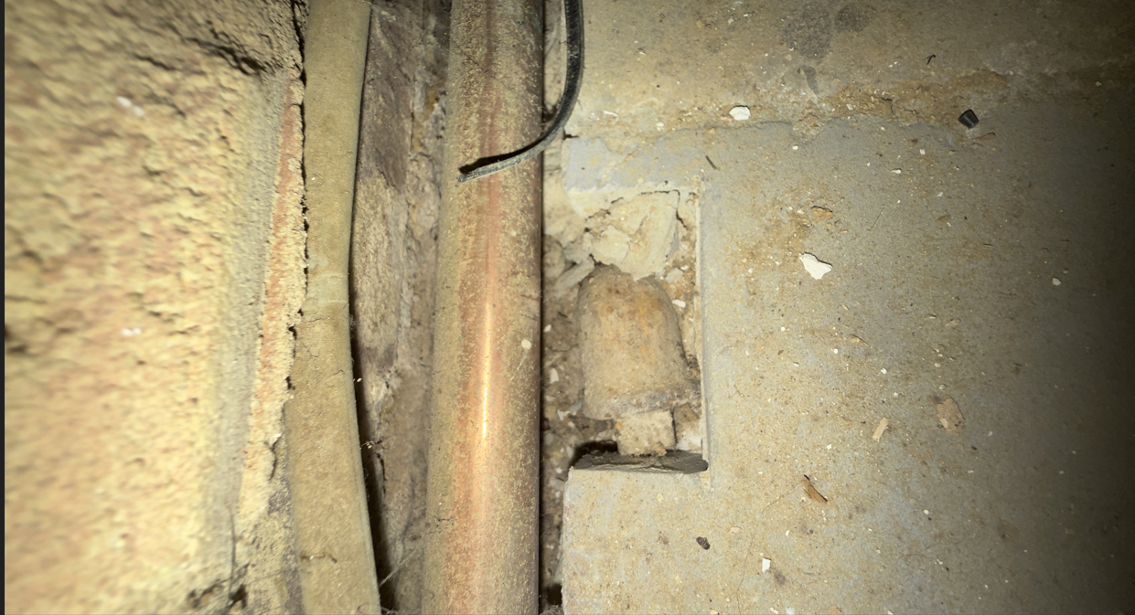

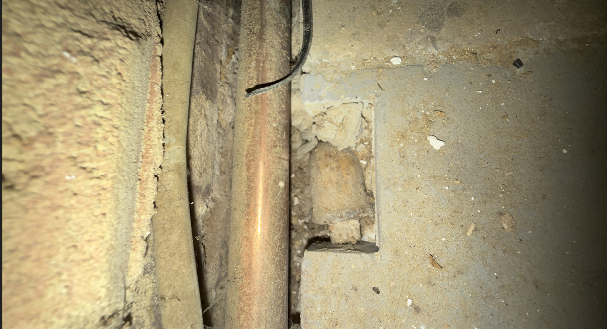

My problem is that I cannot find where the underfloor heating would actually connect to this junction box.. the only thing under here that even looks remotely possible is this cutout in the kitchen tile:

That's a gas line, unrelated to the heating
Ok, well those cables are touching the pipe and should be 25mm away from it.

Ok, well those cables are touching the pipe and should be 25mm away from it. I don’t the think I’ve heard electric tails being called cold before. What I think you need to do is either contact the previous homeowner if possible or investigate more where the cables run.
Thanks for letting me know that. I just checked, and you're right, I'll fix that today. Really appreciate you pointing that out. When I saw it myself it seemed off, so I'm glad to hear someone else say it. I'll get something between them this afternoon.
That cutout is there so the tile will go flat on the floor, avoiding that crusty old iron pipe end in there. Probably the old gas pipe before the copper one was installed.
Unrelated to any heating.
It doesn't and probably never did.
Even if it was used for that, you would be looking for another similar sized cable from that box to where the wall controller was installed, and that is where the actual heating cable(s) would be.
May be unrelated, plenty of kitchen fitter types leave old and new cables randomly in all kinds of places.
Or this underfloor heating was never installed, someone had the idea and labelled up a cable for it, but it was never connected.
