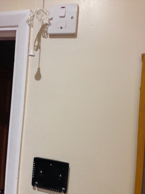

i can see there is a fuse box on the wall , just on top of the warmup control panel, which can switch the underfloor heating off, but i dont think its RCD. just a fused box that states 'fused'
is this safe or should i get a separate RCD fitted for the underfloor heating, even though the main circuit breaker for the house has RCD?

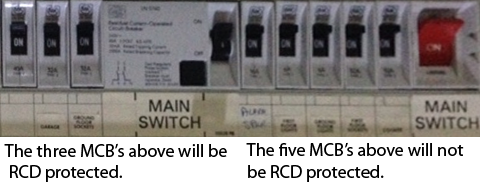

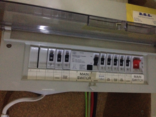

If your whole house has RCD protection, you do not need a second one, providing the main RCD is rated at 30mA. Is it? post a pic if you are not sure.
many thanks for the quick reply,Taylortwocities. am not sure of the rating so i will post a picture this evening when i get home. thank you
As to RCD if supplies from left hand side then already protected. As to if an earth mat is required it would seem from what I could see yes required. I know when we fitted under floor heating to mothers wet room it took some time and many enquiries before we found one with a built in earth screen around the heating cables making it suitable for a wet room without having to lay an earth mat above it. Problem is using an earth mat most can be used in bath rooms so it's not so easy to work out which is which.
It was all to no avail anyway it was a useless system.
If it is a Warmup system, then the cbales come all ready with an earth broad and are suitable for bathroom use without any additional earth mat's needed.
Going back to the RCD. (that's the big opne in the middle with the test button on it) I cannot read the writing, can you pic a close-up.
This may be acedemic as it looks like bathroom heating feed is not RCD protected. Turn off the "ground floor sockets" MCB to check.
If that is the case, then there are two choices
1. Move the circuit that controls the underfloor heating feed to the RCD side of the consumer unit
or
2. Changed that fused switch by the heating control to an RCD FCU like this http://www.screwfix.com/p/safetysure-13a-rcd-fused-spur-white/26963
thank you both. i will post a closer picture. am not really sure which is the RCD side and which isnt. embarrassed ... yes am useless with electrics. i will have a closer look. maybe its written on it.
will update. thank you once again.
I would hope the under floor heating is controlled by one of the three MCB's to the left.
or
so if i decide to go with option one, is it a case of finding the switch that controls the underfloor control panel ( switching off and on till i find the one for upstairs bathroom) and just pulling it out and inserting it into the other side? do i need to unscrew anything? obviously with the mains switched off.
thank you
Basically, it is that simple, but if you've never opened a consumer unit before, just don't. Those old MK boards aren't always the easiest to work on.
Option two is definitely your best, and safest option, hands down.
It's not just the 'switch' (actually an MCB) that needs to be moved, but the circuit controlled by it.
I agree with Iggifer. In the old MK boards (IIRC) you have to completely take out the whole busbar to move release the MCB, then you'd need to do the same on the otehr side.
Then you'd have to properly relocate the busbar into all of the MCBs, then you'll need to re-route (and probably extend) the wiring inside the CU, as it wont be long enough to reach the new position……
It's not easy, even if you have done it before.
Go for option 2. Its an easy fix for you.
