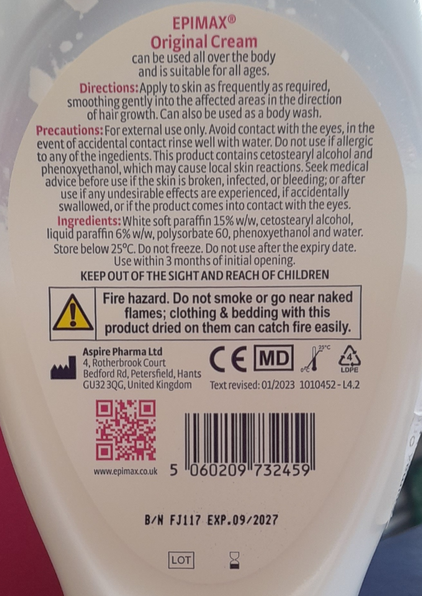

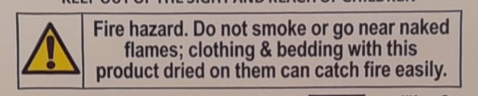

The cream I use to treat my legs, can catch fire and if any clothing or bedding was dried without washing first, then it could catch fire. But need to warn people of this problem, not lump it together with a load of nonsense.
