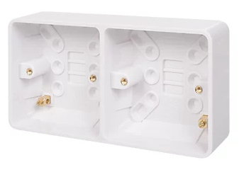

It seems some double sockets are rated at 20 amp not 26 amp, in fact specials like filtered double sockets often rated at 13 amp for the pair, so using a twin socket back box 1692001663185.pngrather than a double back box and two single sockets is a good idea.

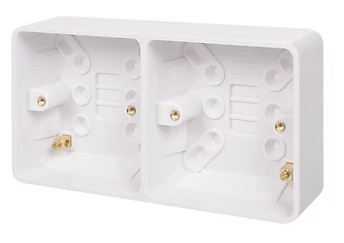

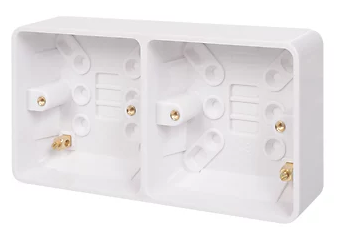

It seems some double sockets are rated at 20 amp not 26 amp, in fact specials like filtered double sockets often rated at 13 amp for the pair, so using a twin socket back box View attachment 310964rather than a double back box and two single sockets is a good idea.
