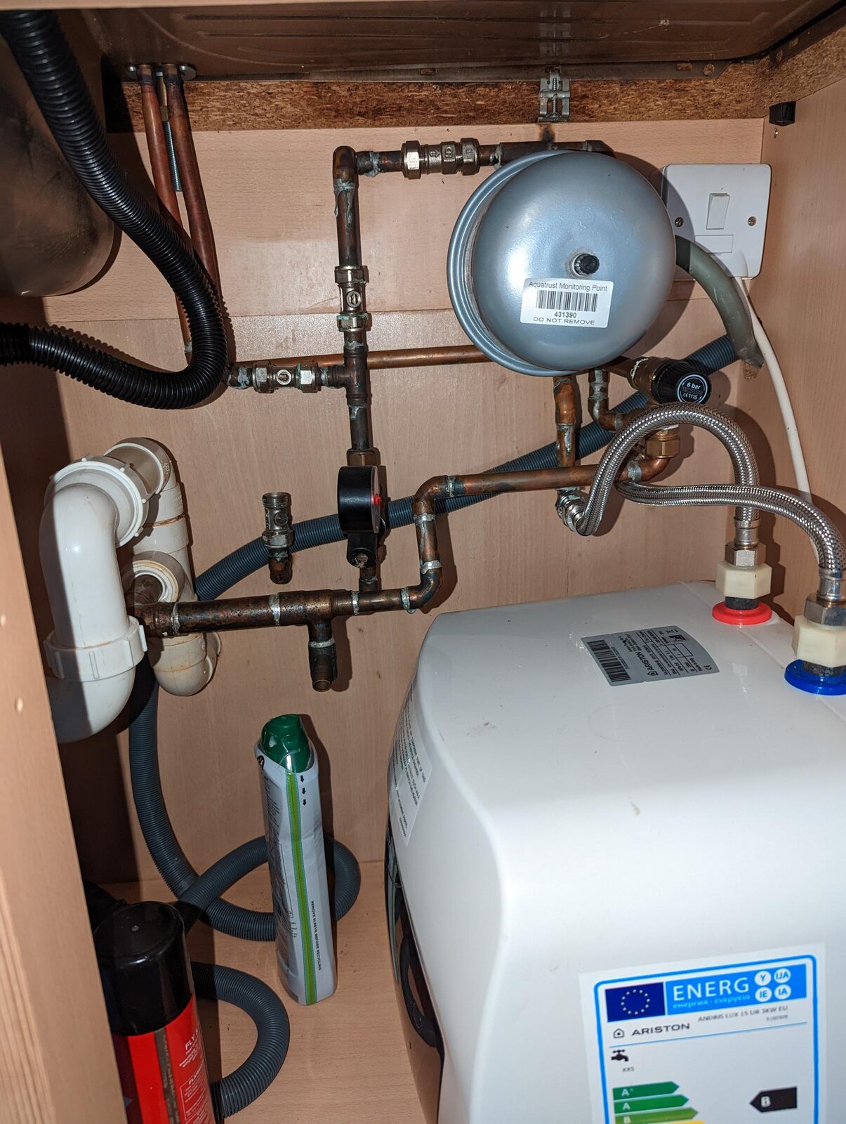

Hi,
I've inherited this setup and during an inspection, it's flagged up that I need a Tundish from the discharge. I'm struggling to see how I can do this. Can anyone offer some advise please?
which model do you have ? think they come in 10L, 12 L, 15 l and 30L noy really sure but will be on the silver label on the top of the heater
