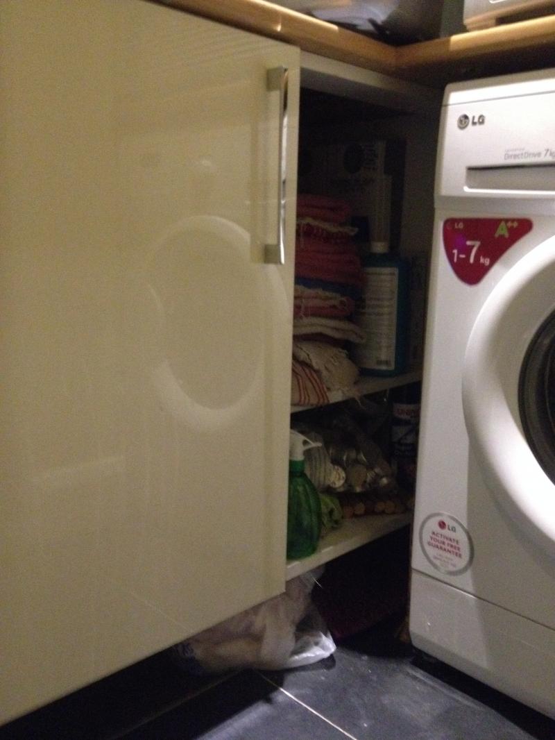

One of my kitchen base units is quite close to the washing machine.
It means that one door can be opened fully but the other can't be, apart from a couple of inches maximum
Because of this the items behind this door cannot be reached with ease, so I removed the door.
This has been fine until we got a dog and she wants to go in the cupboard, which has cleaning sprays in. So re-instated the door
There is a lot of space next to the base unit, which would allow for the door to slide across to allow access into the cupboard.
There's quite a few different door sliders on the market and don't know which to choose
Has anyone got any experience in turning a hinged kitchen door into a sliding door? and if so what kind of sliding mech do I need?

there are no systems that will work flush on the surface
the easiest are a runner top and bottom for the door to sit in within the frame off the unit
with the door cut down to fit
As you can see the door is off it's hinges so that we can get to stuff in that section of the unit.
However, there is a good 50cm deadspace to the right that the door could slide into
It doesn't have to be flush or even that pretty, just functional and practical
First of all, sack your kitchen designer.
Second, can you not reach around from the left hand side once it is open without opening (or trying to open) the right? Why not put stuff on the right that seldom (if ever) needs retrieval?
Sorry but I can't provide the solution you are after, but maybe side-step the issue?
the best i can think off is a lift out door
with say a small pocket to hold the far end off the door and say 2 roller catches this end
by pocket i mean timber to support the face and bottom off the far end
and roller catches as opposed to magnetic catches as they will give full support iff the machine vibrates the door

the kitchen sink trap, I don't think the carousel will clear it. Unless I used just the bottom shelf but as you can see from the photos there's a lot of stuff in the cupboard
I think a sliding door will solve the problem but don't know what sort of runners I would need
Any suggestions?
So the sink is in this unit? You really DO need to sack the designer!
To be honest I can't see how any kind of sliding door would work as access to that end of the unit seems to be obstructed by the washing machine.
What is to the right of the washing machine? If you can give us a wider view of the kitchen layout perhaps there are other possibilities.
