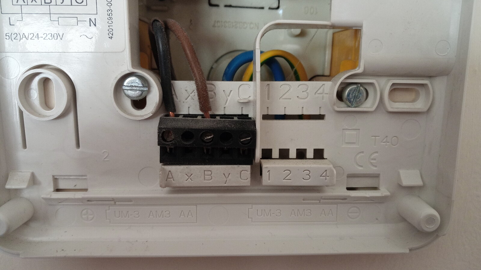

I'm trying to replace my Honeywell digital thermostat for a WiFi Tuya thermostat.
I think I've got it figured out but I want to run it past someone.
This is my current wiring,

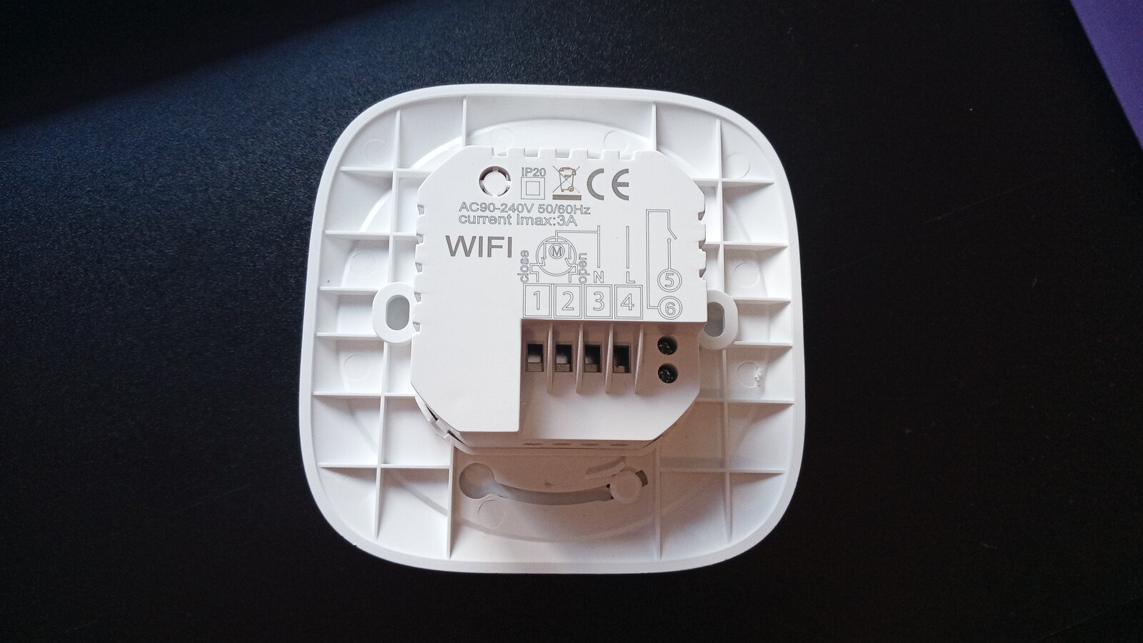

And the back of my new thermostat,
I plan to put Brown into 4, Blue into 3 and Black into 2.
Is that right?
Thanks.
Your existing thermostat is battery powered and the wires in A & B are the switching wires. With combi boilers there are two possibilities. They can be wired for 230V control or 24v control. The new thermostat you have will only work with 230V control. So first of all you need to determine which way your boiler is connected. It does appear from the presence of a brown sleeve over the black wire that it is 230V, but this cannot be taken for granted it should be checked with a multimeter. If it is 24v you cannot connect it to the new thermostat.
If it is found to be 230V, the two wires in A & B will be a 'live' and a 'switched 'live'. Being battery operated there is no need for a neutral connection at the existing thermostat. The blue wire at the back may be connected to a neutral at the other end, or it may also be left unconnected at the other end, so this too needs testing to find out.
The next problem you have is determining which of the wires in the existing thermostat is the live, the diagram shows the L terminal as A, but the brown wire which is normally used as the live is in terminal B. Testing the wires will identify the live supply wire and which wire is switched 'on' and 'off' by the thermostat. [A battery thermostat will work with them connected either way around]
Once you have identified the wires then:
Neutral goes to [3] N
Live goes to [4] L
Switched live goes to [2] Open

With a multimeter on a known neutral or earth, such as on the fixing screw in a nearby socket. You can test for a live on Brown or Black. The one that is still live with the cover off the thermostat as in your photo is the live. [if there's a programmer or timeswitch somewhere that will need to be set to heating 'on'] Once you have determined the live, you can then use that as a reference with the unconnected blue wire. 230V between the two will confirm it is a neutral

The black wire has a brown sleeve, so that's my live.
I'll test the neutral tomorrow and wire it up.
Both wires connected to the existing thermostat terminals A & B are live wires. You need to find out from your test which one is the supply live.
