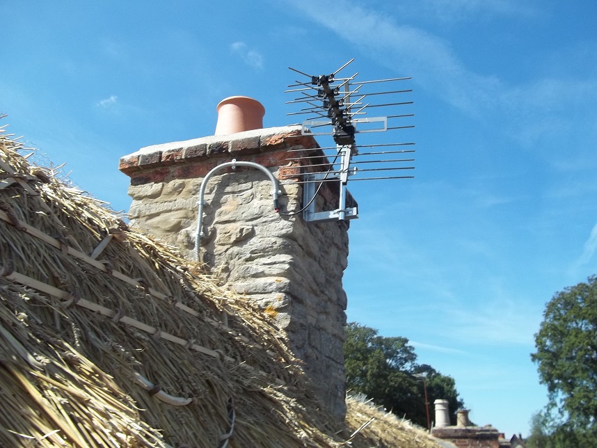

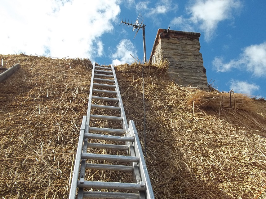

Why ? and loft aerials ? what about them
My aerial was mast mounted before the re-thatch, moved to be at the side of the stack and the signal is just as good. 14 miles from Sandy Heath
View attachment 125841 View attachment 125842

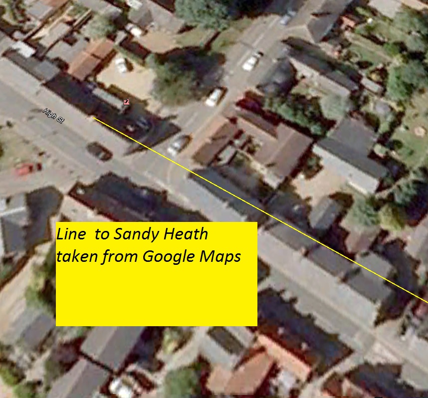

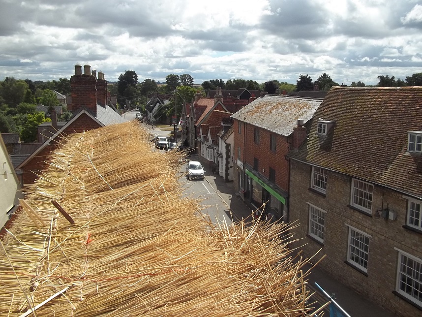

I take it then that you, or your aerial installer, has the equipment to measure it then.
I installed it ( using the thatcher's ladders for access ), Google Earth assisted with the direction and a TV provided information about signal strength and quality.
