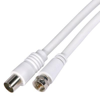

Well i just wondered if the cables are the same and sky uses a coax cable similiar to tv. And is it ok to wire the sky cable into a tv box. The socket range I have purchased doesn't include sky faceplates, only tv ones. The tv faceplates i have match the connector for the original sky faceplate that was there.

The cable used for satellite TV is a higher quality than the normal low loss coax.
There should be a least an aluminum foil screen around the copper braiding, this must not come into contact with the centre conductor as when you connect it will cause a short circuit.
F type connectors must be used and the belling lee type are not suitable for this.

Can you show us a picture of the old sky faceplate? If it (and your new outlet plates) have a threaded screw-on connection then chance are that they are F connectors and will be fine for satellite use. If they are of the standard push-in variety then they aren't really suitable for satellite, it may or may not work depending on your luck.

The lead I can insert into both the tv and sky face plates was the one on the left pictured. I did see both working.
