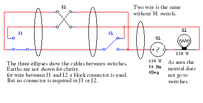

As to wired multi switches, that has also changed, in the old days you needed three wires from master to slave switch
shown was the standard way years ago, with two x two way and one intermediate switch, however today there are switches which only need two wires between them, and also kinetic which does not need any. The whole idea of two way switching has been turned on its head.
The problem is many smart switches will not work in the old way, the smart switch I have used for my outside light does not come as a two way version, as there is no need, pressing door bell turns on outside light, as well as the switch inside the door. Using a battery powered smart switch (TP Link or Tapo) means no neutral required, and it does not change state with a power cut, or pass any current through the bulb, so it can work an outdoor PIR lamp.

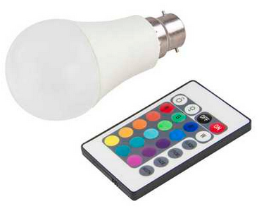

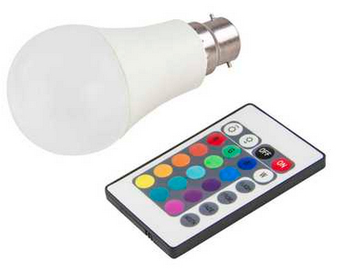

Down stairs in the flat used for visitors, did not want a lamp visitors could not use, so
this was used, does not connect to wifi, or phone, just a simple remote control so light can be turned off/on when in bed, as long as main switch left on.
