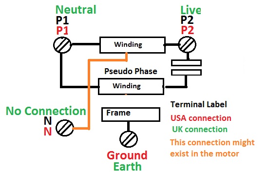

Unless I have misunderstood the posts in this thread so far, this particular motor has 3 terminals:
N, P1 & P2
'N' has a whte wire connected to. This appears to have been ASSUMED to be the neutral wire and has been described as a dummy (isolated terminal solely for 'parking' a redundant wire).
one of the 'P's has a black wire connected to it. This appears to have been ASSUMED to be the hot connexion.
the other 'P' has a capacitor 'wired in series'
Now pardon my ignorance but how is this motor supposed to operate?
It isn't. The wire colours give it away.
Oh and I learnt a very long time ago not to assume the colour of the wires inside a piece of eqipment have any relevance other than the manufacturers design, which does not have to comply with wiring regs in this country and I assume this is also the case elsewhere in the world.
I realise I am referring/replying to more than one poster.
I don't understand the possible orange connection in this sketch unless it's a dual voltage motor, in which case I'd expect 5 or 6 windings terminals + 2 cap terminals,then there'd be no reason for the dummy terminal. I know they frequently are but Ididn't think the capacitor is built into this particular motor!
From OP's description I get the impression he is not overly familiar with this sort of thing and is asking for advice (this is not in any way a critisism), therefore with the reference to capacitor in series with one winding - My interpretation of the information given so far is this:
with an external capacitor
Which I have taken to be this:
and developed it into this:
which matches your 'UK' diagram electrically.
Further to my assumptions so far:
I assume this machine has been functional in the UK until now but developed a fault and therefore wherever the neutral wire is CURRENTLY CONNECTED is the correct position for it to work in the UK.
Working on that basis:
and assuming the white wire is indeed the neutral wire
and assuming that the terminal labelled 'N' is indeed the functional neutral terminal
then I assume my drawings are more likely to be the case.
I have made a lot of assumptions, based on experience and the brief descriptions from OP. As always an OP photo and more replies could remove a lot of the guesswork and hopefully provide him with the knowledge he seeks.
I have certainly found this to be correct in the small number of ocassions that I've been involved in this type of motor.
I've not knowingly come across the dummy terminal situation.
Winston, Bernard and possibly others, by the sound of things have had different experiences to me which I have no doubt are perfectly valid and in this case have made different assumptions to me.
