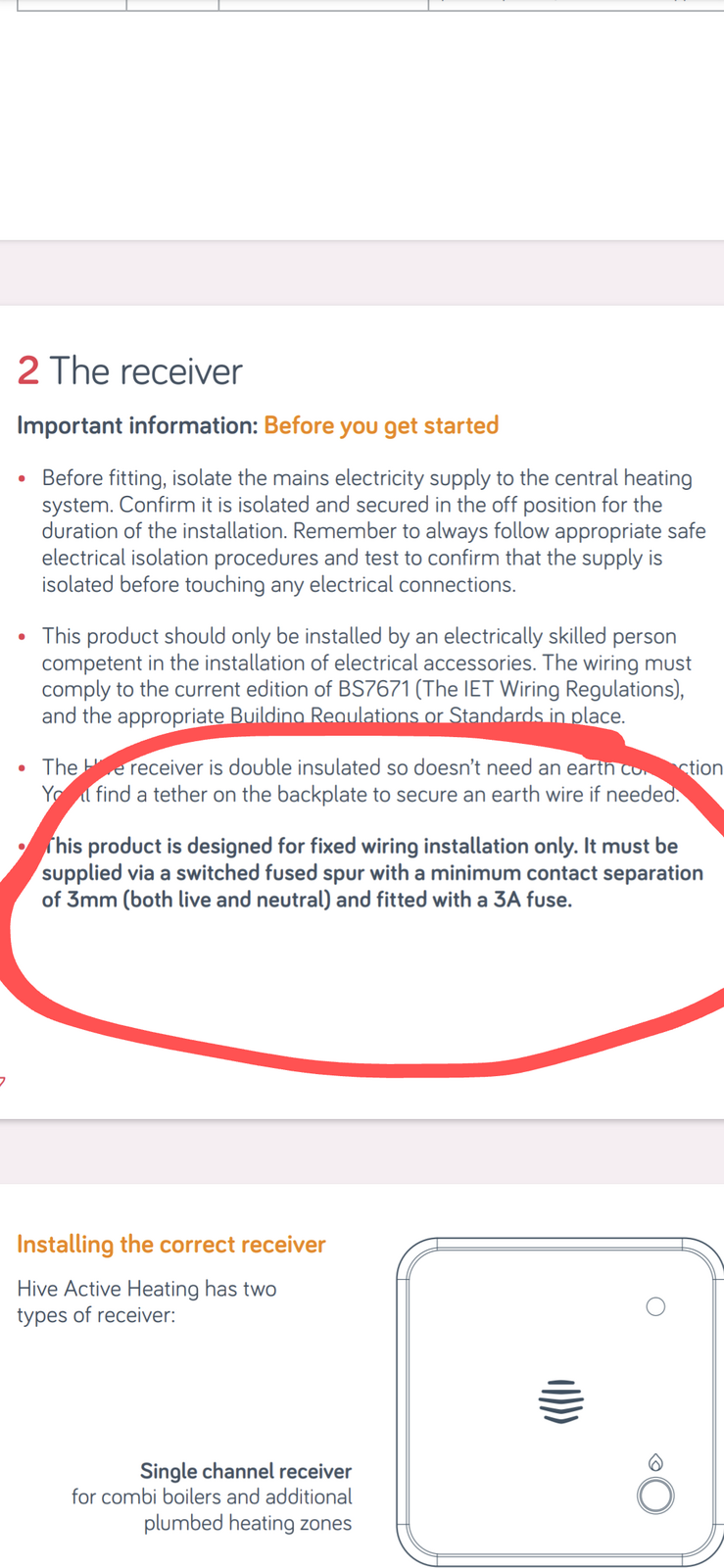

The oil boiler says it requires fusing with a 5a fuse but the hive says a 3a fuse so i am switching the boiler via a relay and feeding the hive with a 3a fused switched spur and the boiler with a 5a fused switched spur....Now these two switches have replaced an old single switch metal MEM fuse box which comes off a 6a MCB about a 50cm from the main house fuse board.

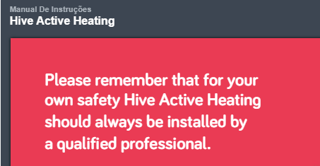

What about this instruction that no one ever minds ignoring?
For your own safety you SHOULD ...but legally not required right?
Where as it also says you MUST install it with a 3a fuse and you're saying a 5a will be fine?
