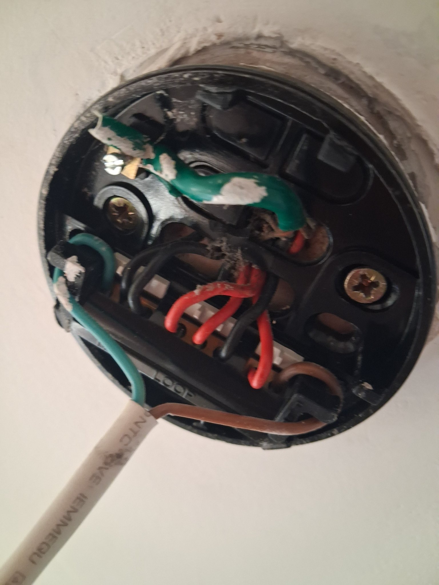

No issues with ceiling rose all connections secure
No idea but it must be if those switches operate the light , I'm not a spark so guessing

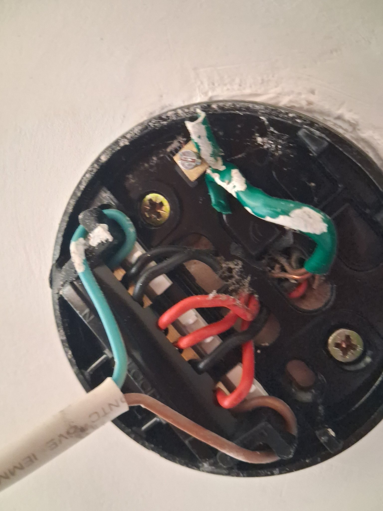

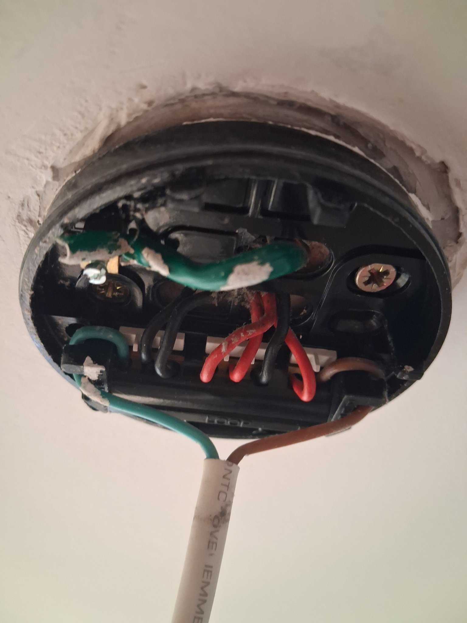

Pictures of the wiring connections at the rose may be useful.
If the permanent live to the switch originates there,that would be a starting point,followed by tracking the cable in the loft. Hopefully it's not boarded over up there and you can access the cables !

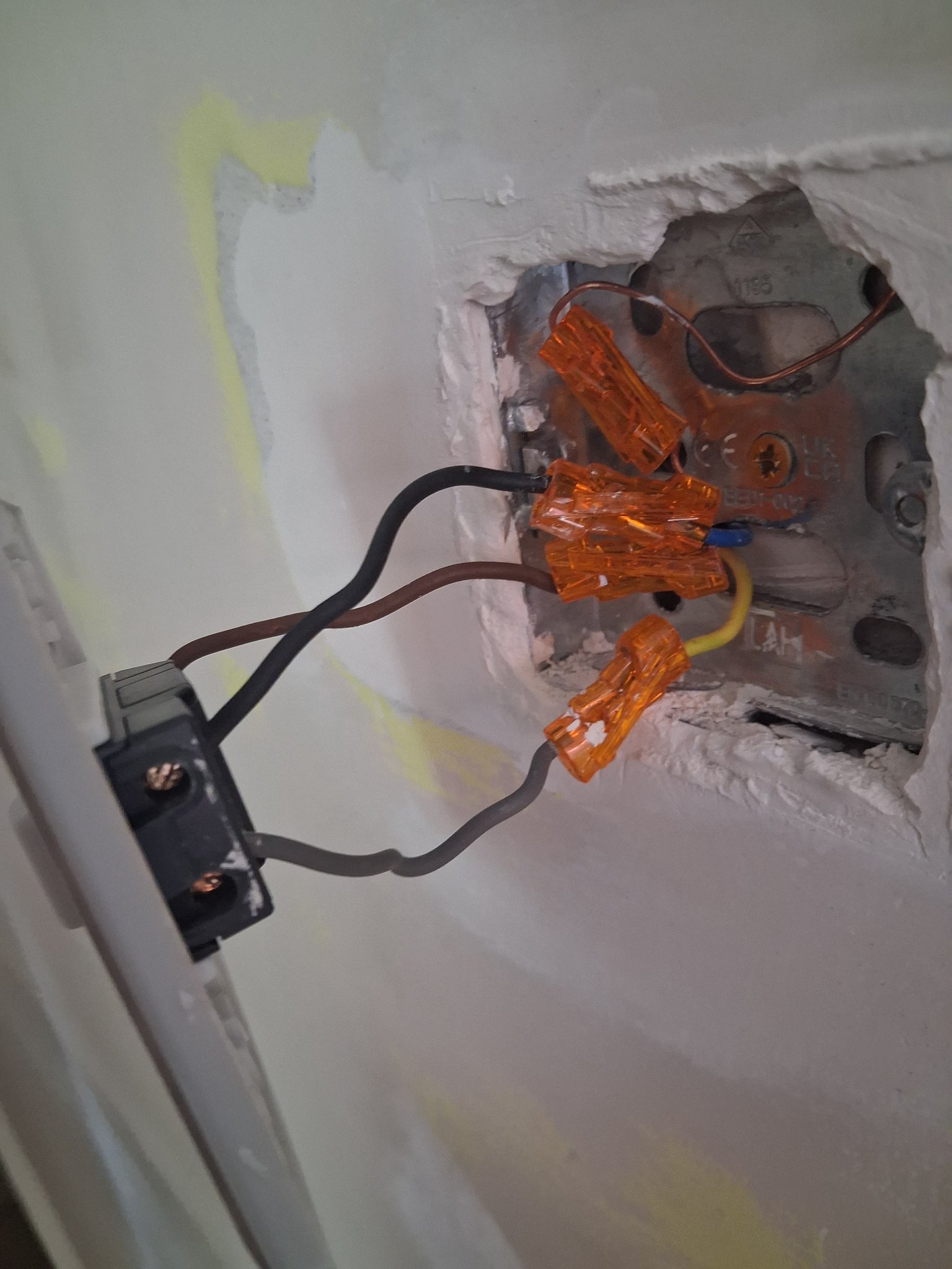

The other reason I suggested getting an electrician is because the wiring and boxes you have pictured in post #8 need to be modified to be made compliant and safe.

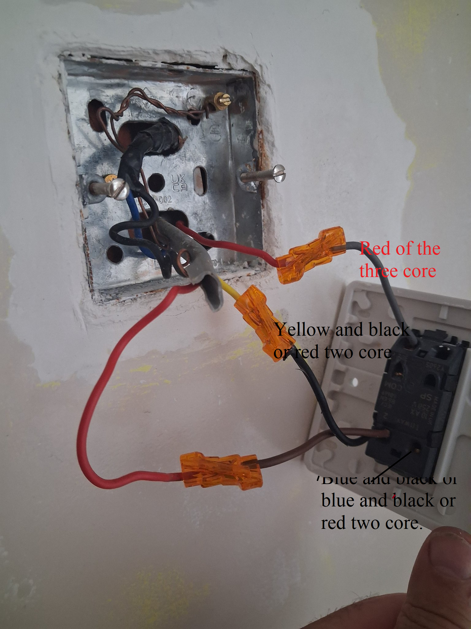

What did you do Peter ?
I'll make the guess

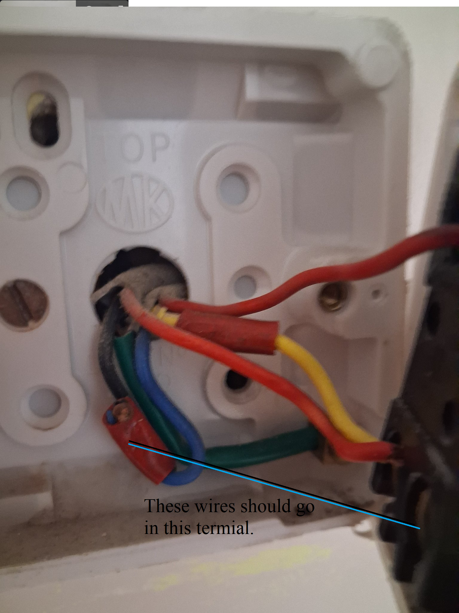

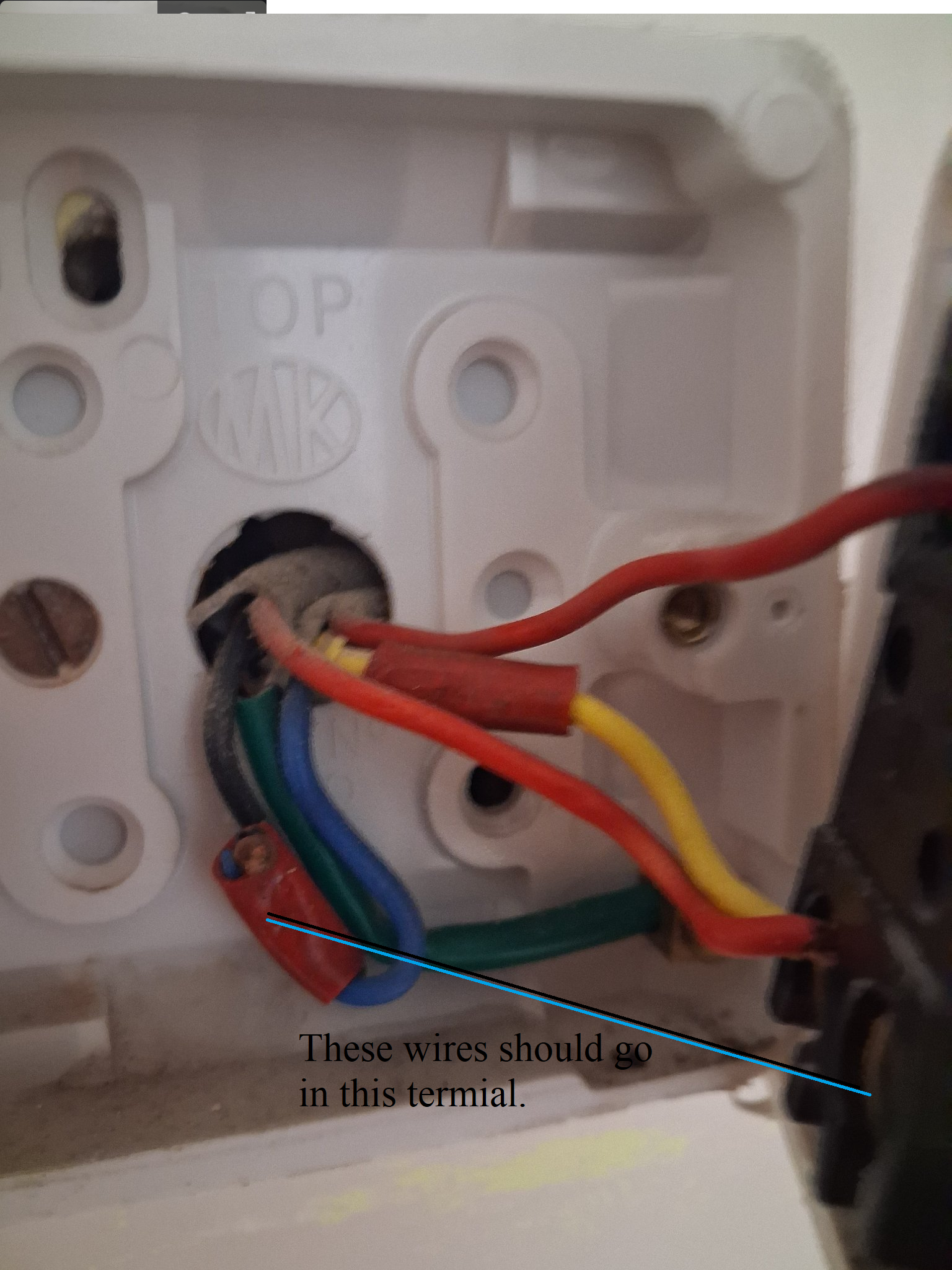

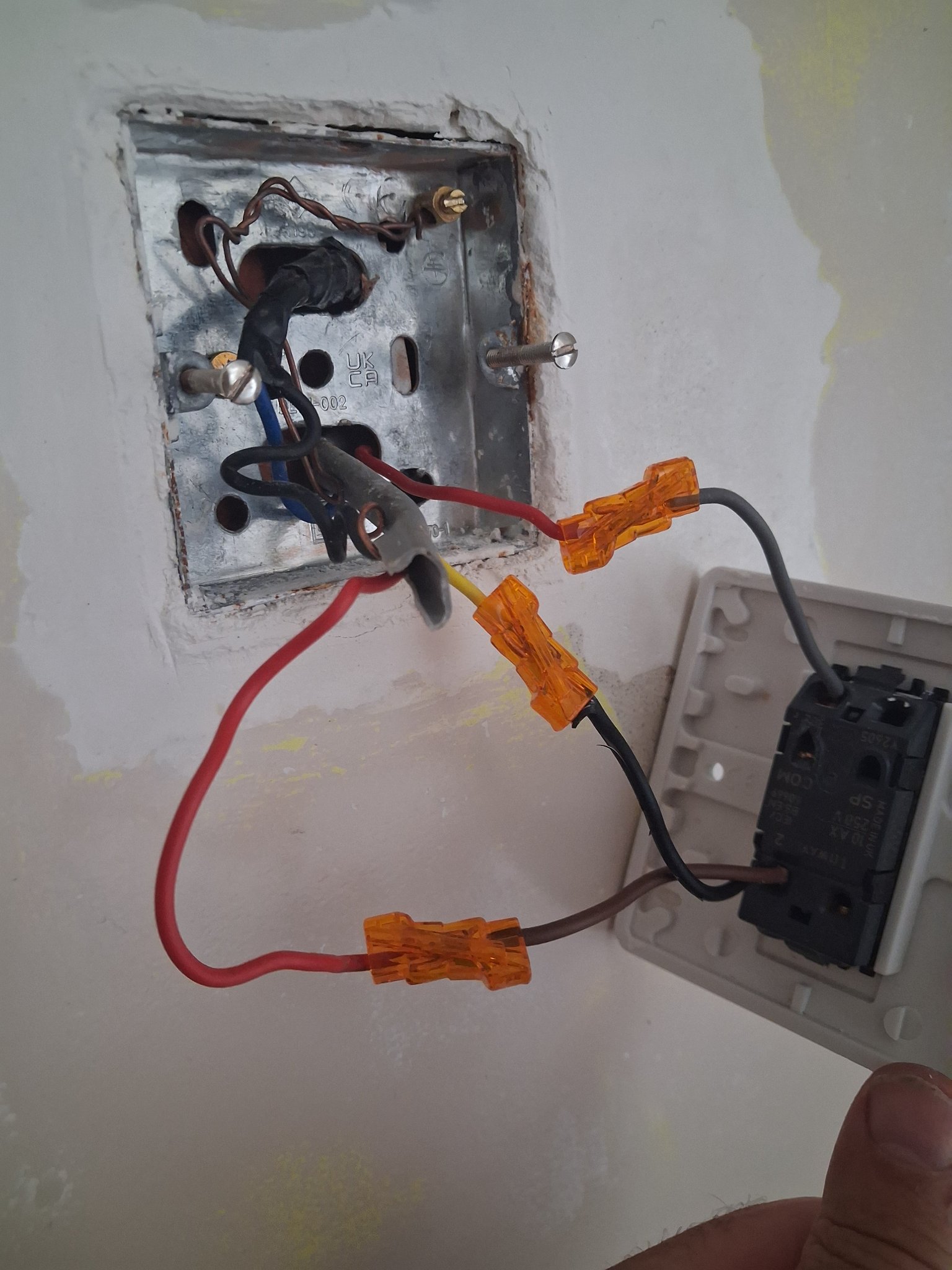

With this one the black and blue have come out to the terminal.
Not possible, they likely pulled out when you removed switch the at moment empty terminal will have the unused wire either red or black from two core, and the blue from three core.
Have it your own way, but it will not work.
As Eric has tried to tell you these wires were in a terminal before you removed the faceplate of that switch. Perhaps the screw wasn't tight but they were in the terminal and they were making a connection.
You come on here asking for help.
Regardless of what YOU THINK; the advice given about 5 wires is totally correct.
What I see in you pictures is a yellow wire, correctly marked with red tape to indicate it's a live wire and a blue and a black wire, correctly marked with red tape to indicate it's a live wire.
Somehow the blue and black have become disassociated from the switch.
Do us all a favour and terminate the taped up blue and black in the spare terminal and try it.
THEN we can start with other advice IF it still does not work.

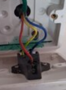

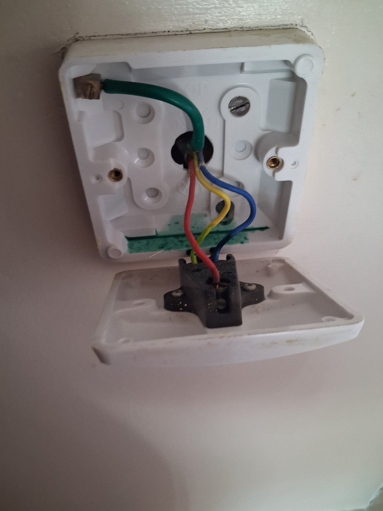

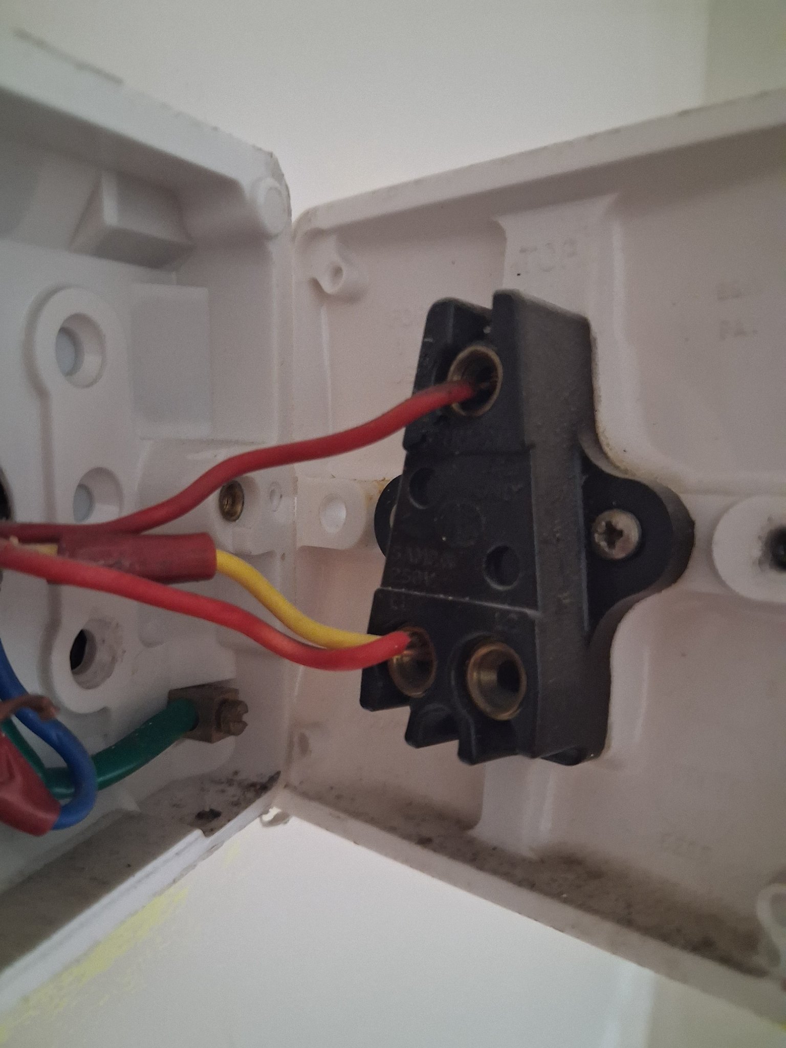

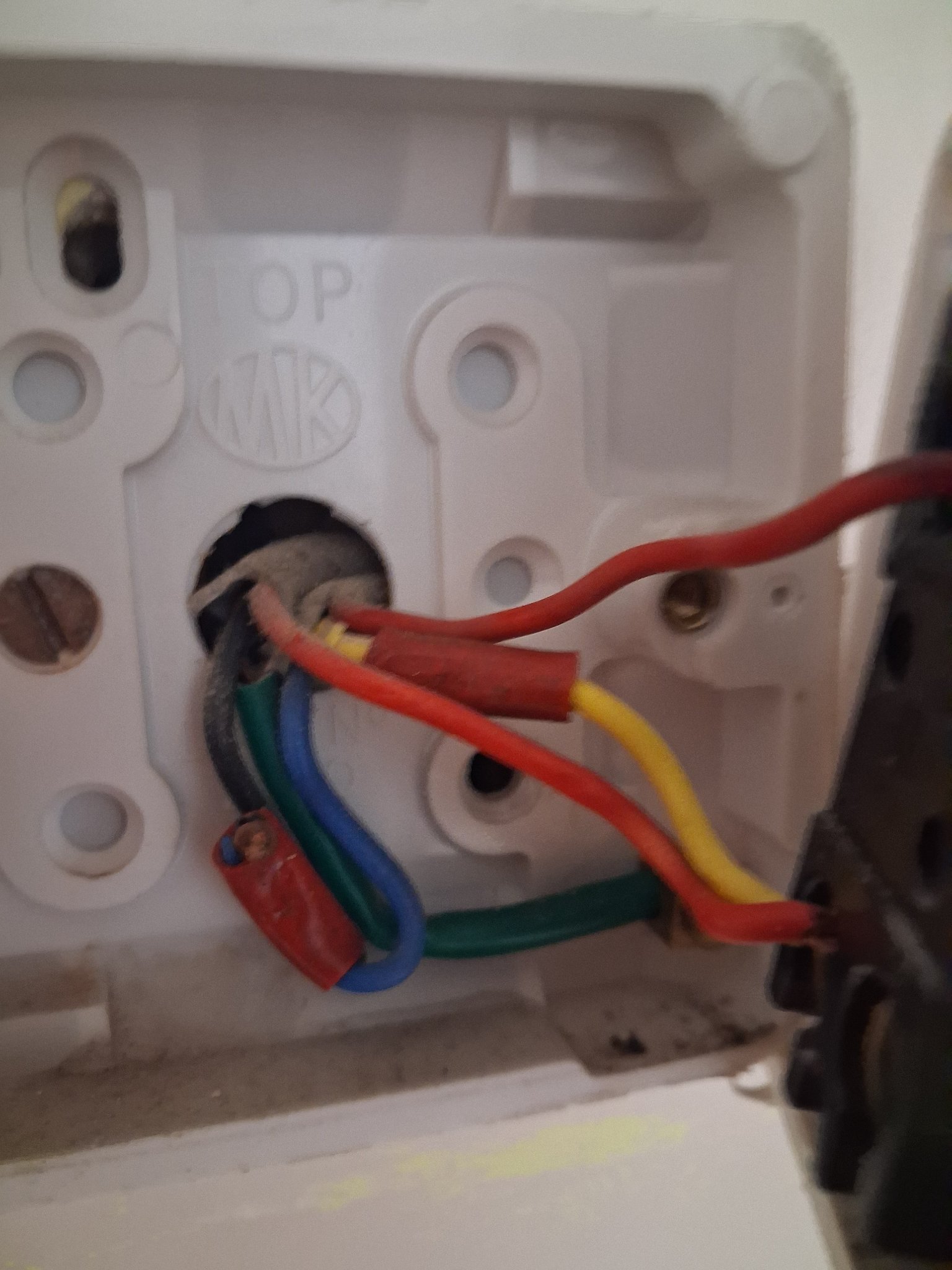

This is how it was wired when it was working properly:
Compare that with what you have now.
If you still have the green sleeving please put it back on the bare earth wires.
I will add: Well done for taking the 'before' pictures, it has helped us a lot knowing what was there.
