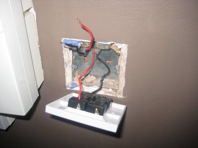

Hi,
I have a two-way light switch in my hall-way. One switch turns on the downstairs hall-way and the other turns on the upstairs light. Also i have a one-way light switch upstairs which works in conjection with the two-way switch downstairs.
However, recently a painter took the two-way switch out and now the two-way switch for upstairs only works if the one-way switch is off upstairs or if the one-way switch upstairs is on upstairs then the two-switch for downstairs will not work (confusing i know). Please help! I'm guessing it is a problem with the wiring. Thanks

If I post a picture of both switches can someone help me out?

All the wires on the bottom row need to move one terminal to the right.
Is the link between your common terminals installed correctly? There looks to be a lot of copper on show...

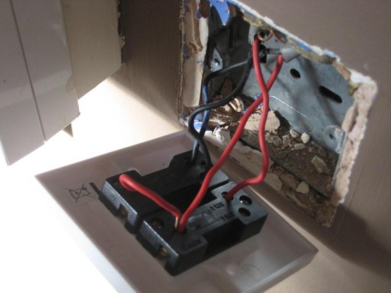

Hi,
I think I misunderstood what you meant, did you mean the 2 blacks and 1 red from the first picture all need moving across 1?

Yes that is correct.
Leave the top wire an link in the terminals they are in, and move the other three.

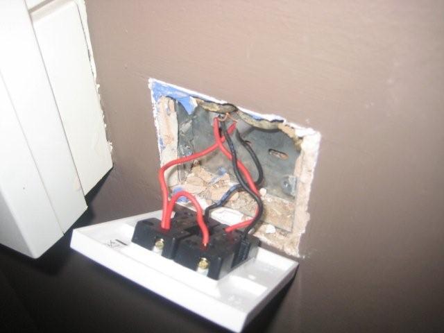

Hi, I did the above but it still doesn't work (see picture below, I trimmed back some of the copper hence the top wiring has changed slightly), does that mean that the switch upstairs is wired wrong or we have another problem.

Try swopping the two blacks over and the two reds over.
(blacks should ideally have a red sleeve on them too, the earth wires should also ideally have green/yellow sleeve on them too)

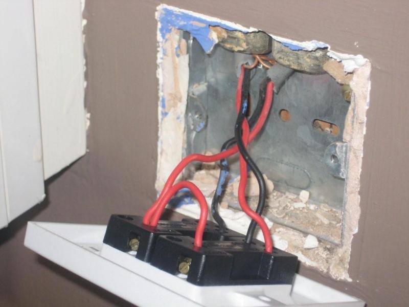

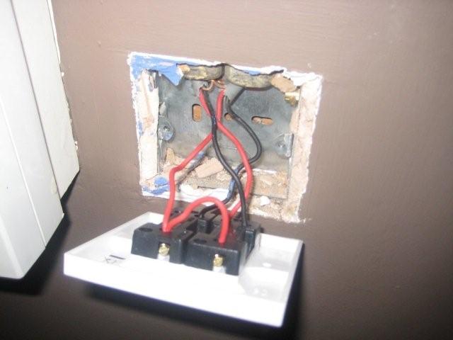

Hi guys,
See the pics below, still having no success :(
The picture with the wires hanging out is just to show which one operates the hall light (this works perfectly). I've tried various different ways of wiring the upstairs light up but it doesn't want to work.

hi nick
the bottom picture on your last post seems to be correct if the left hand switch is the hall and the right is the landing and the switch upstairs is wired as per the first post
if it is still not working suspect the right hand switch of being faulty try swapping the bottom cores over ie leave the red with the link as it is,take the black out of the left hand switch and put the red and black from the right hand switch into the two terminals then put the remaining black into one of the terminals on the right hand switch if the hall light now doesn't work put the black in to the other terminal
Maybe your hall pair has the live connected to the black conductor? In this case, your landing light will only work when the hall light is on.
Go back to basics and check all the conductors to see what they do:
Disconnect the power and make safe.
Make a note of where the conductors are at the moment.
Disconnect all wires from both switches. Start with the top switch, the one gang one.
Put the red and black from the same cable in a terminal block so they are shorted together.
Now go to the two gang switch and put a multimeter set to continuity buzz
(ie it buzzes when you put the leads together) across the red and black of each cable in turn. When it buzzes, you've found the right pair. To double check, disconnect the temporary terminal block & make sure no pairs are buzzing, then reconnect & make sure the same pair is buzzing.
This then is what you call the strappers. They link between the two switches.
So the strappers go to L1 & L2 of the top switch and the remaining conductor to C or COMMON.
That same pair of strappers goes to L1 & L2 of the landing switch on the bottom switch plate.
Next, put terminal blocks on the remaining red & black at the bottom switch position.
Make sure it is safe, then reapply power. With your multimeter now set to voltage range including 250V, check between earth & the two other insulated conductors to see which shows mains voltage (216-252V).
Now disconnect power and make safe again.
Whichever is showing live, put that to the common & put a link across to the other common.
Now place the last remaining conductor in L1 of the one way switch.
This way, you should get it working again. If not, then there may be a break in a conductor or a faulty switch mechanism.
Don't forget to sleeve the blacks to show they are live conductors and the cpc's to show they are earth.
