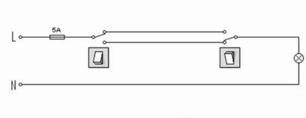

I am helping a friend who has had an “electrician” wire his kitchen. He has stopped answering his calls and abandoned the job.
Ive got most of it sussed but noticed that he has put in a twin and earth between two switches as the two way wiring. I think this should be 3 core and earth? Is there any solution to this as the walls have been plastered and the cable can’t be pulled back through.
Thanks in advance.
Chip out the plaster, put the correct cable in, and replaster. Bill the original electrician. When he doesn't pay, small claims court time.
Send photos or drawings or accurate descriptions on what you have, in case the 3 core and earth is not necessary.
Two way lighting wasn't always done with 3 core+e, so there MAY be a way of salvaging it.
If he has used capping or conduit, and you need to make alterations, the damage could be minimal.
If you have a live feed at one end of the cable and the switch wire at the other, you may be able to sort it.
One of the three wires to second switch is perment line, so it was common to borrow line from another switch.
This can mess up some hearing aids and has been known to result in borrowed neutral, so is no longer done by most electricians, but unless it causes a borrowed neutral there is no rule to stop it.

This is the normal way to do two way switching, note un-switched line to both switches. Easy to borrow line from another switch.

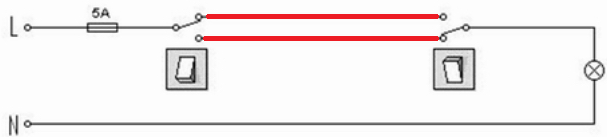

Strappers only require the two phase conductors. It's only the "conversion method" which uses three phase conductors. So it's not necessarily incorrect at all. Professionals use twin brown for the strappers.
What’s a “strapper”?

Could two way switching be achieved by taking a cable from the switch to one of the ceiling lights? The loop is at the switch.
I was wondering whether the other end is tucked away somewhere above the ceiling.
With Live and Neutral looped at one switch this arrangement works but still needs 3 core plus Earth from the ceiling rose to each of the swiches
