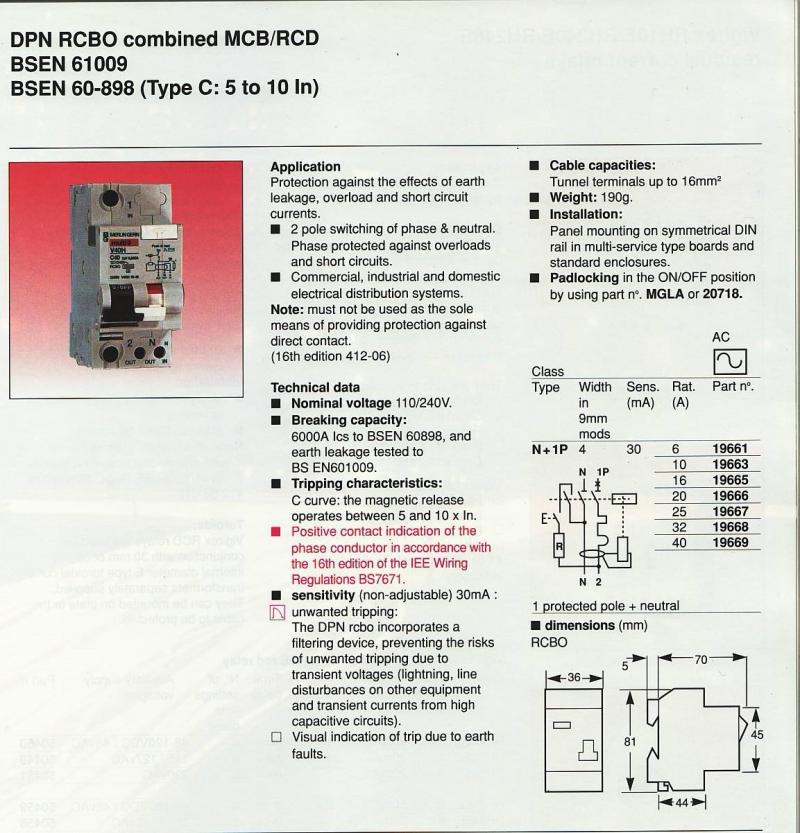

It is beginning to look that way, Schneider make a DP RCBO but looks like it is only available in class AC.
They do make a DP RCBO type type SI as I have said but once you realise it needs it's own enclosure then the simple MCB and separate box with RCD would seem simple way around the problem.
The one I was thinking of goes directly into a Merlin Gerin type A board taking up two module widths, unfortunately I can't find a pic on the Schneider website to ensure the neutral positions are the same, here is a scan of the old Merlin Gerin catalogue page:
I think it has just dawned on me - the photo in the catalogue is the wrong one! It shows a Single Poled version - good old Merlin Gerin!
I don't see anything on that page which says that it is a Type A (or Type SI, if that's the same) device - am I missing something?
