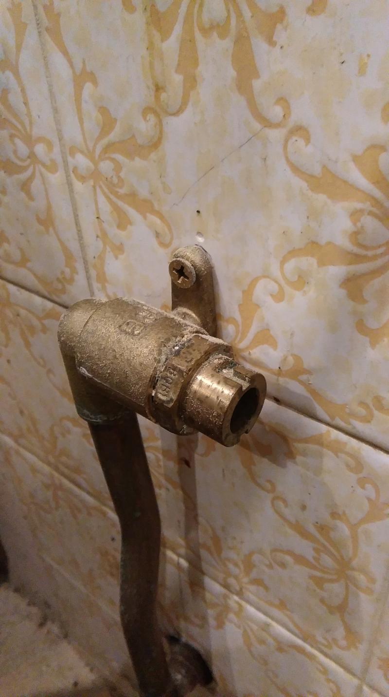

Types of cooker hose and connection - Help Please
Is he coming to fit a new cooker?
You have probably bought a standard hose but you have a micropoint cooker connection....a more unusual connection.
Either get a right angled micropoint hose or get suitable bayonet connector for your new hose....the hose MUST hang in a downward direction to prevent strain on the hose.
