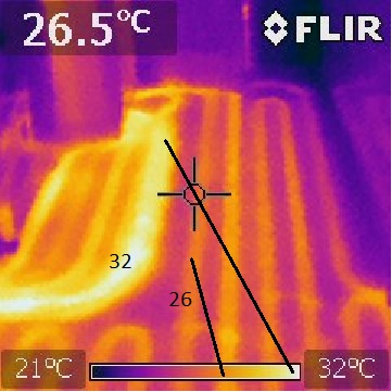

PullerGas, his knowledge may well be expansive, and I'm sure HIS underfloor heating is exemplary, but his people skills stink. I explained why I'm in the situation I'm in, (my own fault I know), but what I was looking for was advice on how I might overcome that, other than digging up my floors. Instead I get derision.
No I'm not a Builder, (although I do know how to push a wheelbarrow), I'm a retired Electrical Engineer.

There does seem to be a steep gradient but without knowing if there is a rug over part of the floor one cannot exclude the possibility that the cooler areas have more insulation ( rug etc ) on the floor above the pipes. I have to say the thermal imaging of a friends DIY water under floor heating indicated a much more even distribution of temperature than the image you posted. He is not a heating engineer, his speciality is robotics and vision inspection systems.
And what construction and what design delta?
Did you not consider that the bit you've highlighted was the transit point for 5 loops and that there would be a higher concentration of pipework? And that there might need to be a gap to allow for something to support the flooring other than pipes?
No.
Why is your flow temperature set at 35C and why so low? Mine is running 50C which gives a max floor temperature around 26C most of the time and a good transfer of heat into the room through 18mm chipboard, 'UFH' rated underlay and laminate boards. Try raising your flow temperature.

Mate, the optimum for UFH is a concrete screed & slate tiles. In most areas of the country you'd be running it on a condensing boiler or heat pump, so the lower the mean water temperature the better in most instances, I'd say. So raising the mean water temperatures would certainly not be the best thing to do!!
The clown has too much wood over his UFH!!
