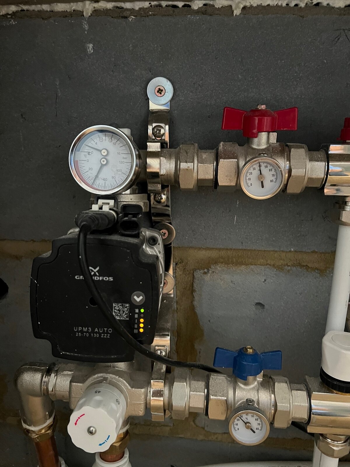

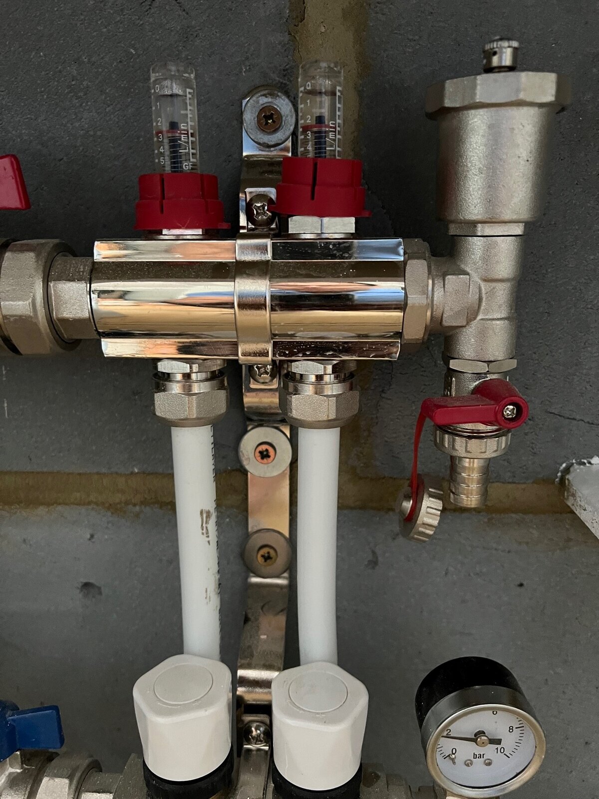

You've got temperature gauges in the flow and return manifolds. I'd trust those more than how the manifolds feel.

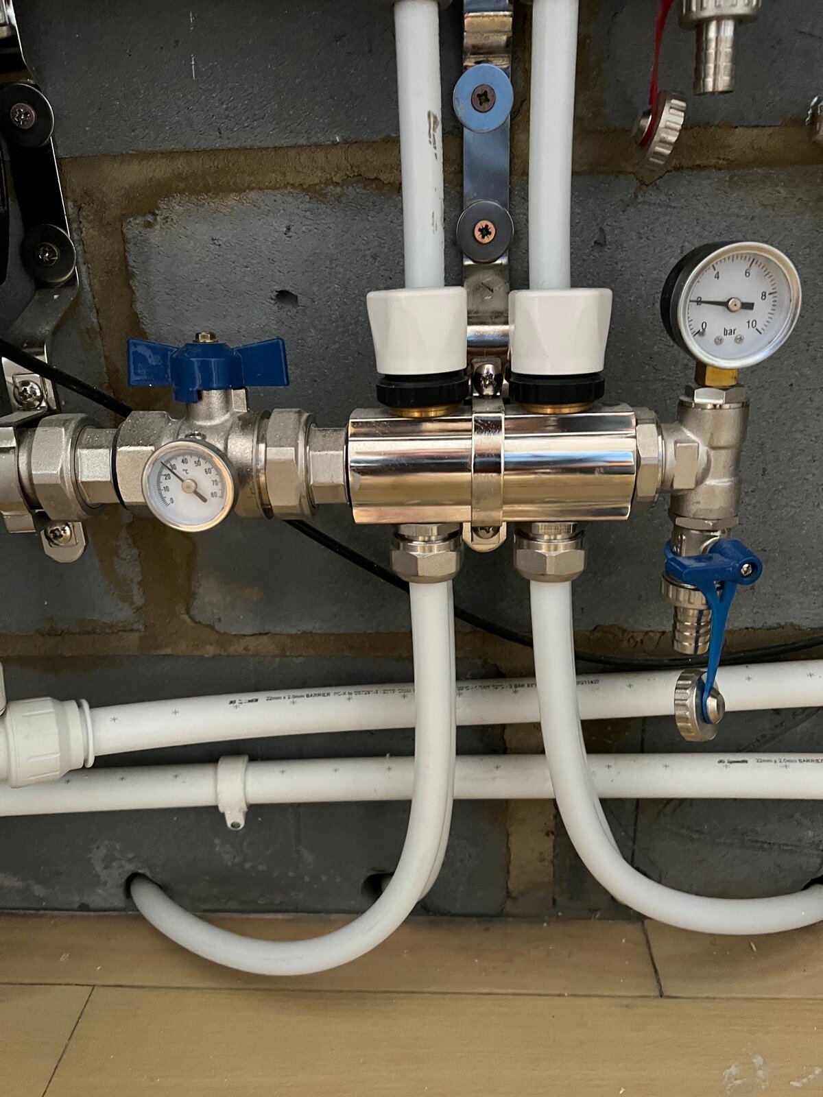

I think the flow plunger in your right hand flow meter is so high its gone off the scale and is hidden below the red plastic lock shield.

There's a mis-match, the output from the blending valve is almost 60Deg - but the water through the manifold is around 48Deg - so one stat isn't reading correctly. Needs to understand what the flow temp actually is, may need a IR thermostat to check. If it's 454 then the manifold won't be that hot to touch, if it's 60 then it should be but the blending valve certainly should be up at max.
As suggested, if both those flows are feeding one room then you need to balance the flows and set them both @ 2.5L/min to start with. What length are the pipe runs, do you know? I would suggest the pump may also be too high, you want that set to constant pressure - which it looks like it may be - and set it to auto, then set the flow meters to 2.5 L/min.
Your temp drop is within range whereby the floor should be outputting as per design.

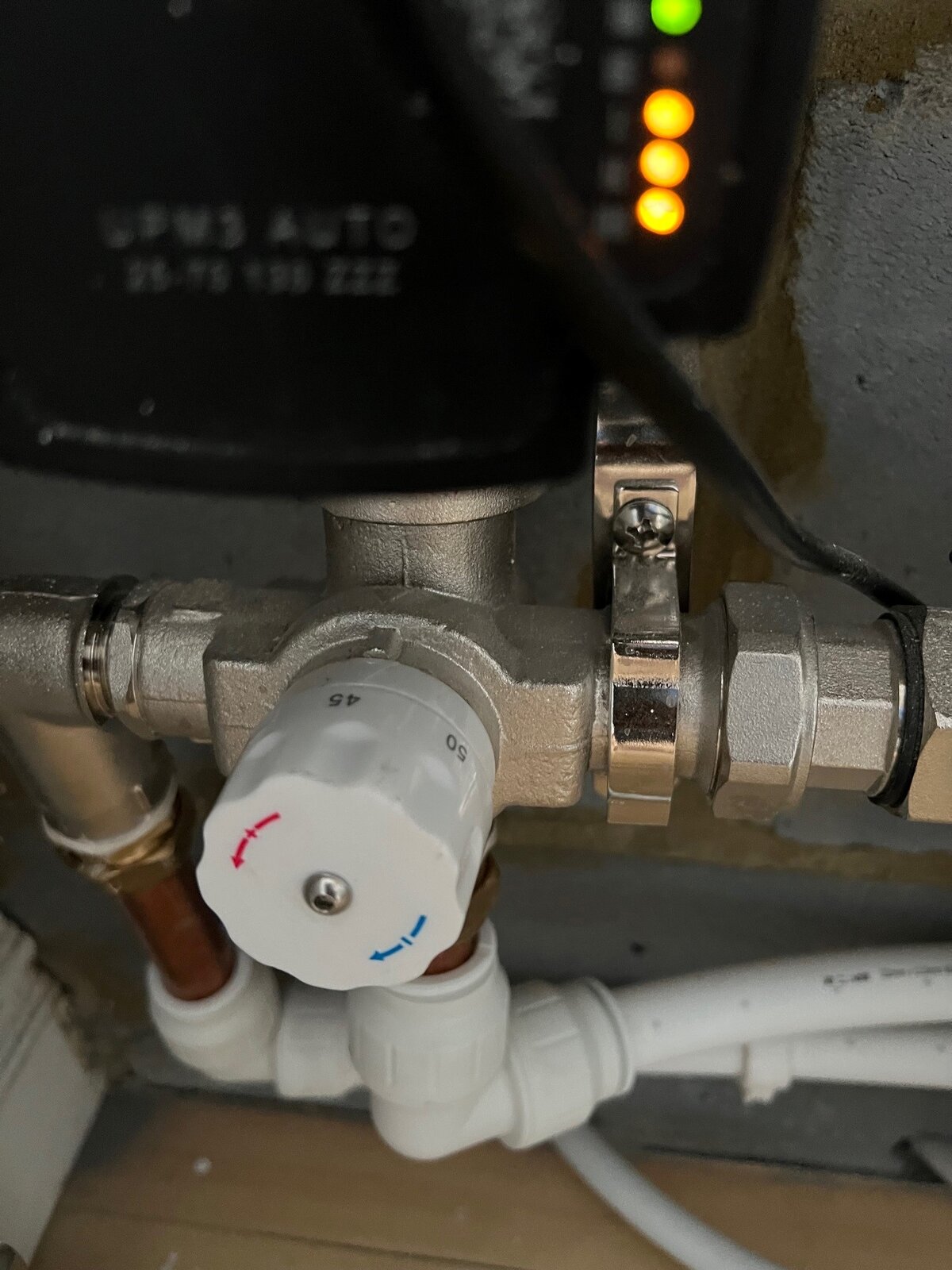

thanks @SpecialK , @Madrab and @Lower for your help so far. I have lowered the flow metres so that they are now at around 2.5/3 L/Min. I have also reduced the temperature on the Blending valve to 45C. Attached are photos showing reading on the various dials.

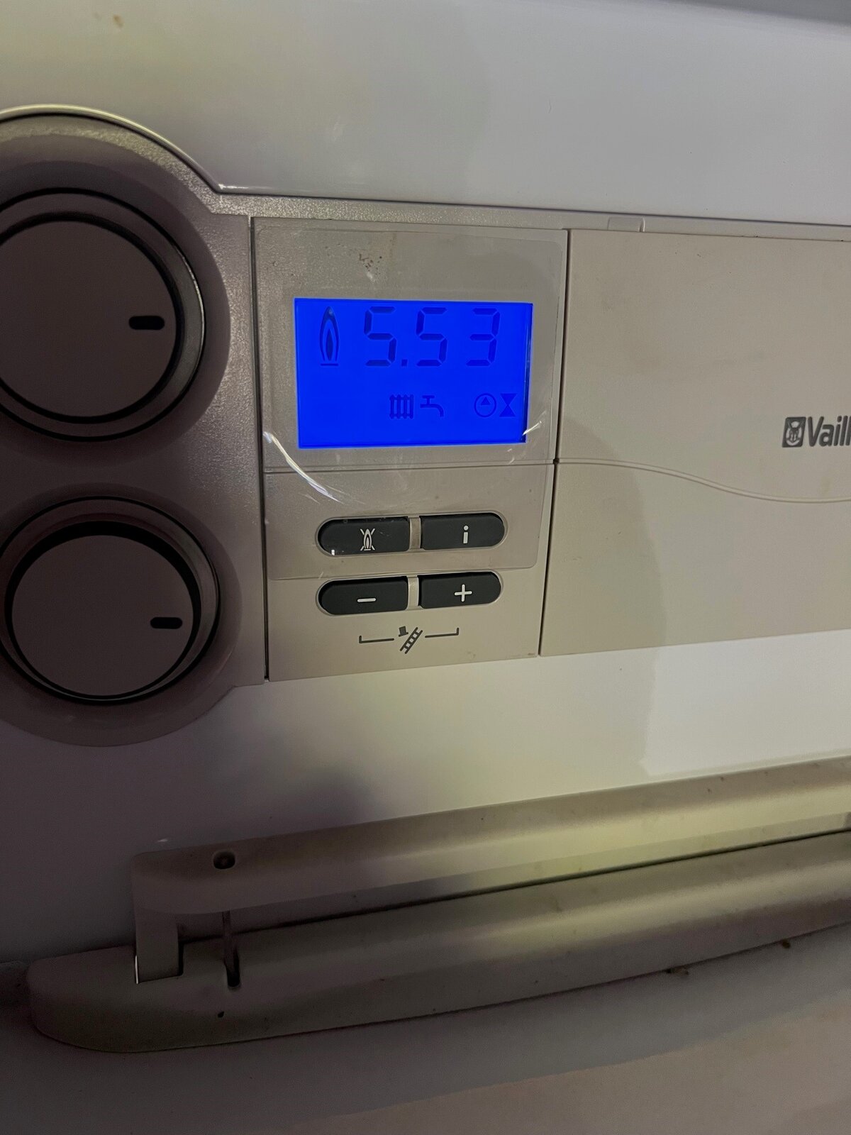

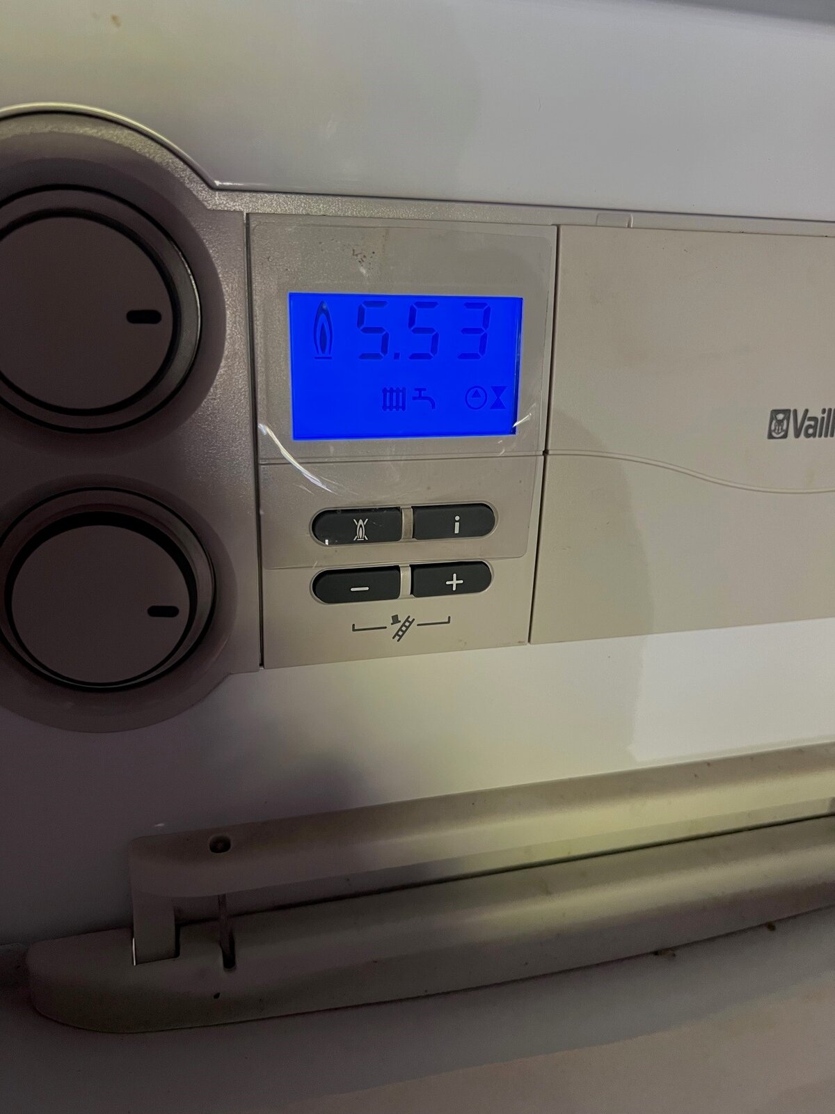

The problem I have now (which has occured on ad-hoc basis before) is that my boiler (a Vaillant ecoTEC Plus 438 installed around 9 years ago) goes into a S.53 state after running for a period of time. When the boiler goes into this state, all the pipes going to the zone valves of the central heating system and UFH system are luke warm, and the boiler does not fire. I have attached a photo showing this S.53 code being displayed on the boiler.
From my earlier research of the S.53 code, I believe it means that the flow-return temperature difference is too great OR Boiler is in waiting period of modulation f block function (or operation block function) due to water shortage (VL-RL spread too big). Can anyone please advise what can be done to avoid the boiler going into this S.53 state?

What is the boiler flow temperature SP (setpoint), is this problem occurring with UFH only required?
Thanks @Johntheo5. How can I find out what the boiler flow temperature SP is?
It is happening with central heating only, with UFH only, and when both heating types are requested

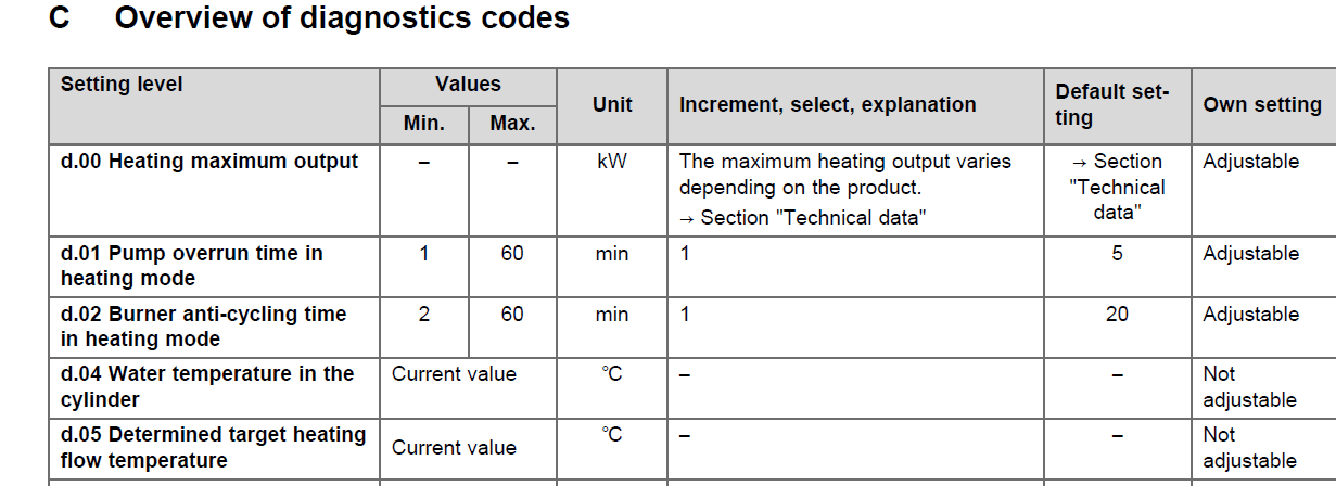

I would just try the system on CH only first but change setting d.00 first.
Suggest setting d.00, the maximum boiler heating output to say 10kw (from Auto)
d.05 is the boiler flow SP (target) temperature.
d.40 is the actual flow temperature.
d.41 is the actual return temperature.
Monitor d.40 & d.41 while the boiler is running.

Its to give it a longer warm up time and, hopefully limit the dT (which brings up the S.53) and hopefully wll get the bioiler to stay on continuously for at least awhile, by noting d.40 & d.41we can then calculate the flowrate through the boiler as it should then be running at a max output of 10kw. You should monitor these very closely for the first two minutes or so after fire up. and then once/twice after say 5 minutes. You can always up the output depending on findings.

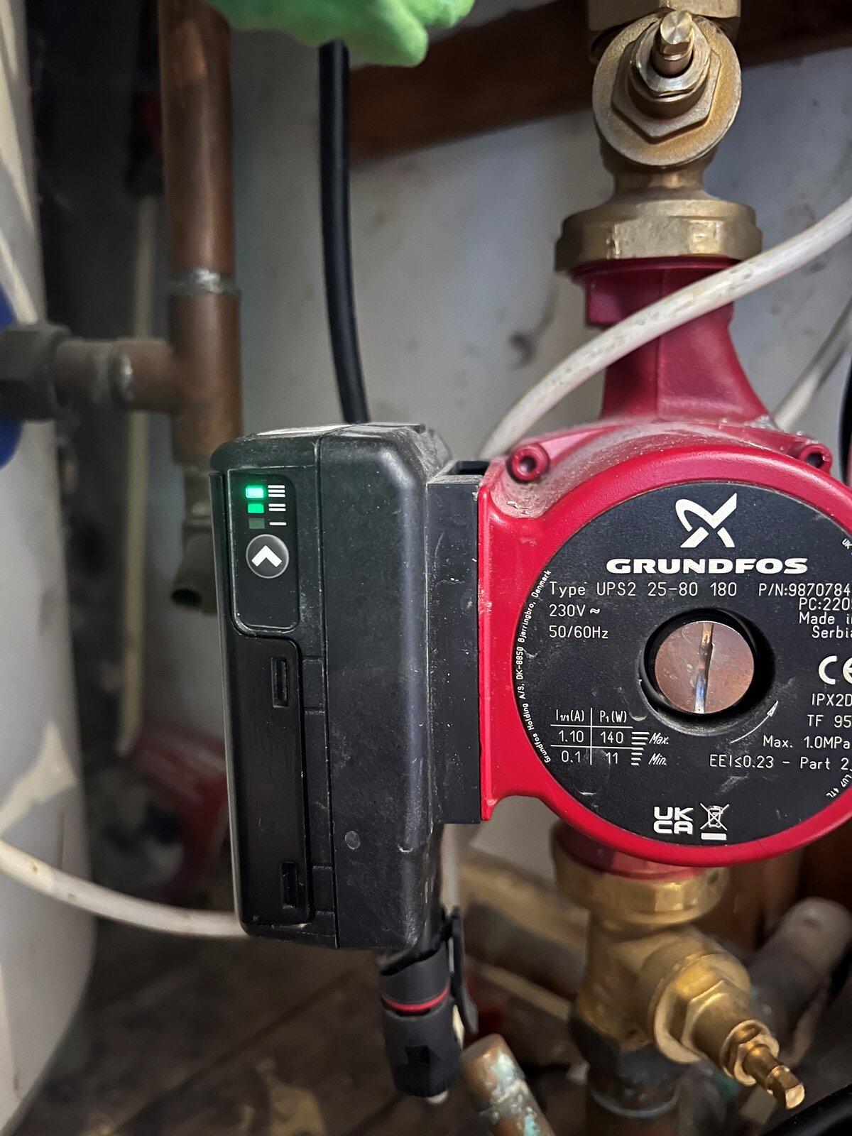

You say you have a Grundfos UPS2 25-80 pump installed on the boiler primary circuit?, can you also note when next running, its mode/setting or just post a photo of the LEDs when running.

Edit: Another unwelcome feature of Vaillants is that they hold the firing at ignition setting (65/70%) for 60 secs before allowing modulation, in which time the flow temp can overshoot the flowtemp by 5C and shut the burner down and cycle, so relatively high flowrates are required to prevent this, as you say, balancing your system may have contributed to this.

I have attached a photo of the Grundfos pump when it was running. It appears to be running at the highest speed, i.e. 3.

This may enable you to view the D parameteres, if you had d.00 up before then you should have been able to scroll up/down to see all the d values?, I think if you press the button above the + button then you should be able to scroll through the parameters, it certainly won't do any harm to reduce d.00 to 10kw, you can always changs back, I will have another look but the only utube video I have is probably the one you lookesd at, slightly different display.

thanks @Johntheo5. I think the situation has got worse :(. I managed to find out how to display the d.40 & d.41 temps. I turned down d.00 to 10. After starting the CH, the boiler fired for about 20 seconds and then immediately went into a S.53
After 2 minutes, I took readings, i.e. d40 = 35, d.41 = 22. After 5 mins, it was d40 = 38, d.41 = 24, and after 6 mins, d40 = 38, d41 = 25. During this time, the boiler did not fire and it remained at S.53 :(
