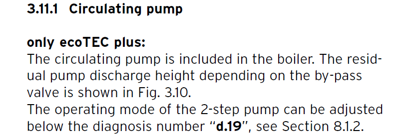

Does the boiler also have its own internal pump??. see 3.11.1, if so, see what d.19 is showing.

I am not aware whether the boiler has an internal pump. When the engineer removed the front cover of the boiler, I did not see any pump. Looking at the online manual https://www.vaillant.co.uk/downloads/z/ecotec/ecotec-installation-servicing-2007-372783.pdf and the photo of the boiler on page 9, it appears the pump is behind the electronics box. I will look to see if I can get behind the electronics box. If there is a pump, I will see what d.19 is showing.

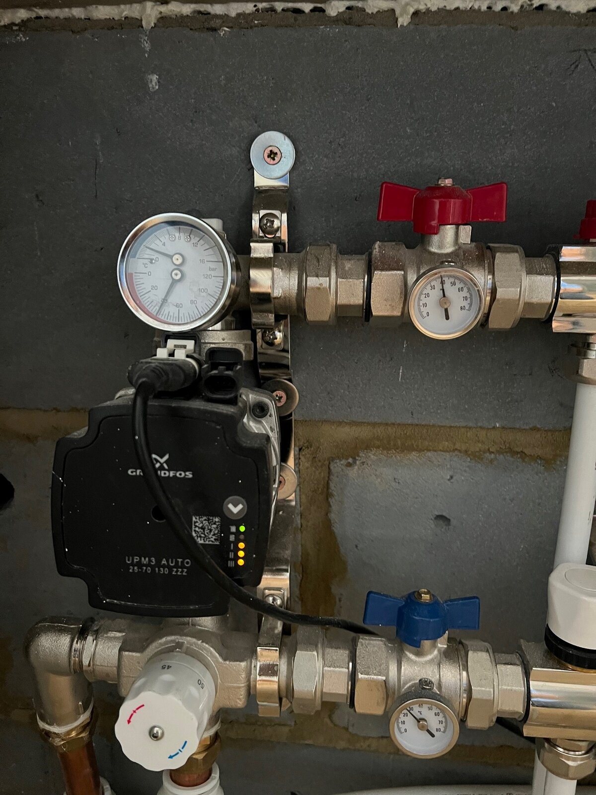

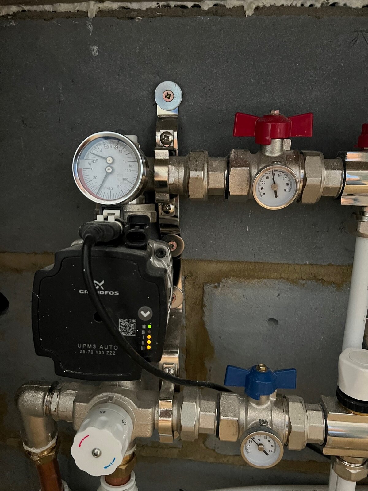

Where you ask about the make/model of the manifold pump, stupid question but do you mean the manifold pump of the UFH system? If so, from the attached photo, it is a Grundfos UPM3 Auto. From the photo, are you able to see the setting of the pump?

The manifold pump UPM3 is set to its maximum CP (constant pressure) mode but thats for another day as you want to sort out the rad problem first.

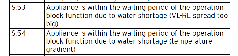

The S.53 code is interesting as it comes up due to water shortage, don't know what VL-RL is but alot of boilers use the pressure rise when the pump starts up and runs as the trigger for this so one would expect that this would relate to a boiler with a internal pump, wonder what vaillant's response would be. S.54 will annunciate if the flow/return is too high, probably around 30C so circulation rate, at least, doesn't seem to be a problem.

Is there a potential issue with the manifold pump being set to maximum CP?
Manifold pump setting: I would think the pressure (head) from both the UPS (8M) pump and the manifold pump should be reasonably close to allow rhe TMV to work properly, the UPS on its max setting (8M) will pump up to 55LPM (3.3m3/hr) at that head, the manifold pump is possibly around 5M on max CP setting. (don't have pump curves).
I'd say most systems run quite happily at pump heads of 3/3.5M.

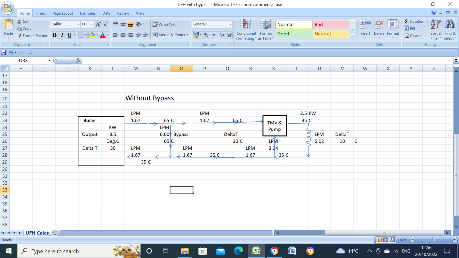

The TMV is the thermostatic mixing valve which mixes the hot water (65C in your case) with the far colder return water from the UFH manifold loops to give the required mixing temperaturre, if you have the TMV set to 45C then the returm might be 35C so you have boiler water at 65C mixing with manifold return water at 35C to give the required mixed temperature of 45C.

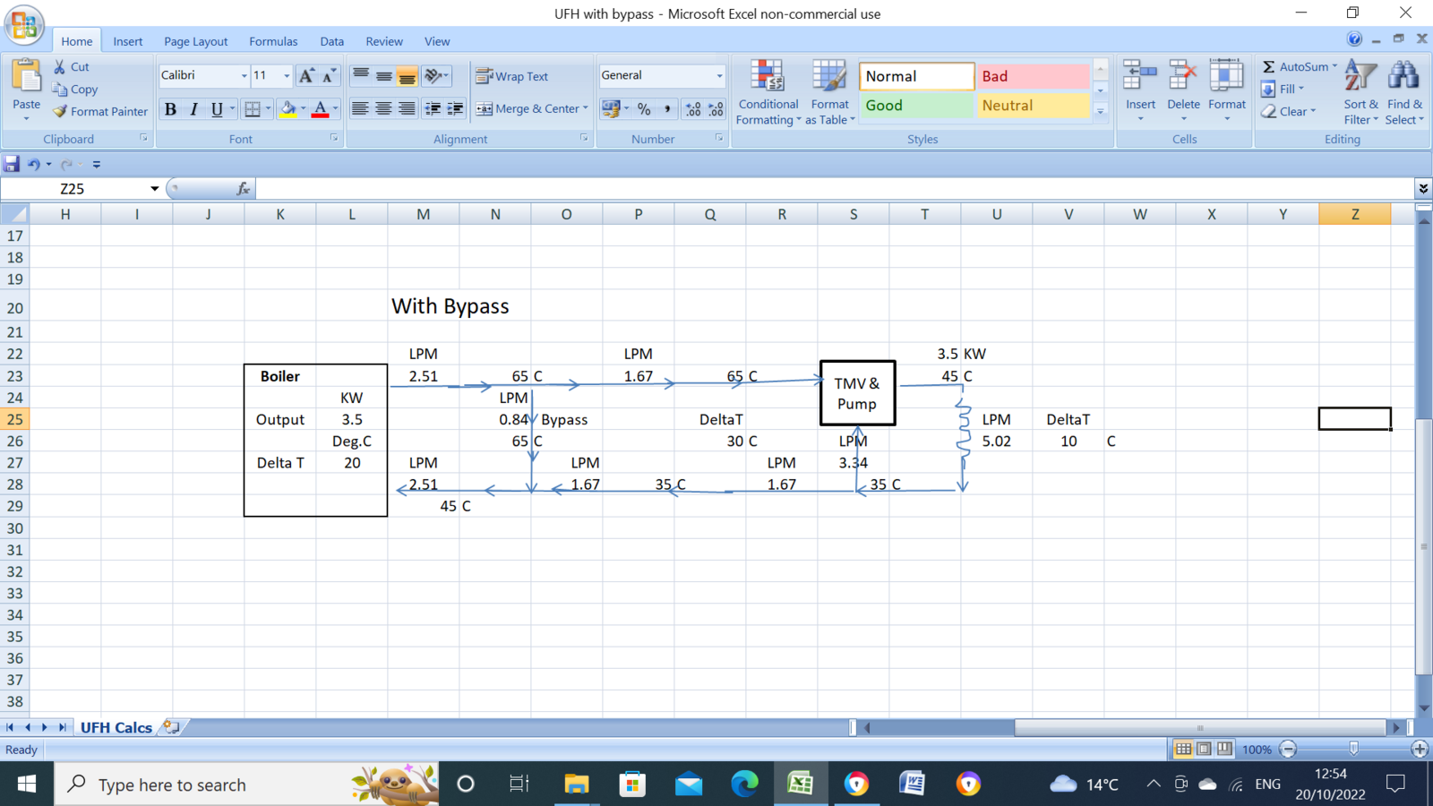

You have 2 loops circulating 5LPM, assuming a manifild dT of 10C (45-35) then the UFH requiremant is 3.5kw and you will have 1.67LPM boiler flow @65C mixing with 3.34LPM manifold to give just over 5LPM @ 45C to the manifold, the remaining 1.67LPM (boiler return & flow LPM must be the same) returns to the boiler at 35C, this gives a boiler dT of 30C (65-35), which the boiler will not be happy with and probably cause S.53, there ways of bypassing some of the boiler flow to its return to give a dT of say 20C, a bypass of 0.84LPM at 65c will raise the return temp at the boiler to 45C giving a boiler dT of 20c but your boiler cannot run continuously at a output of 3.5kw so snookered anyway except that the cycling boiler can do the job, very unlikely with a vaillant IMO.
The attached might show the various flows/temps etc without and with by pass.

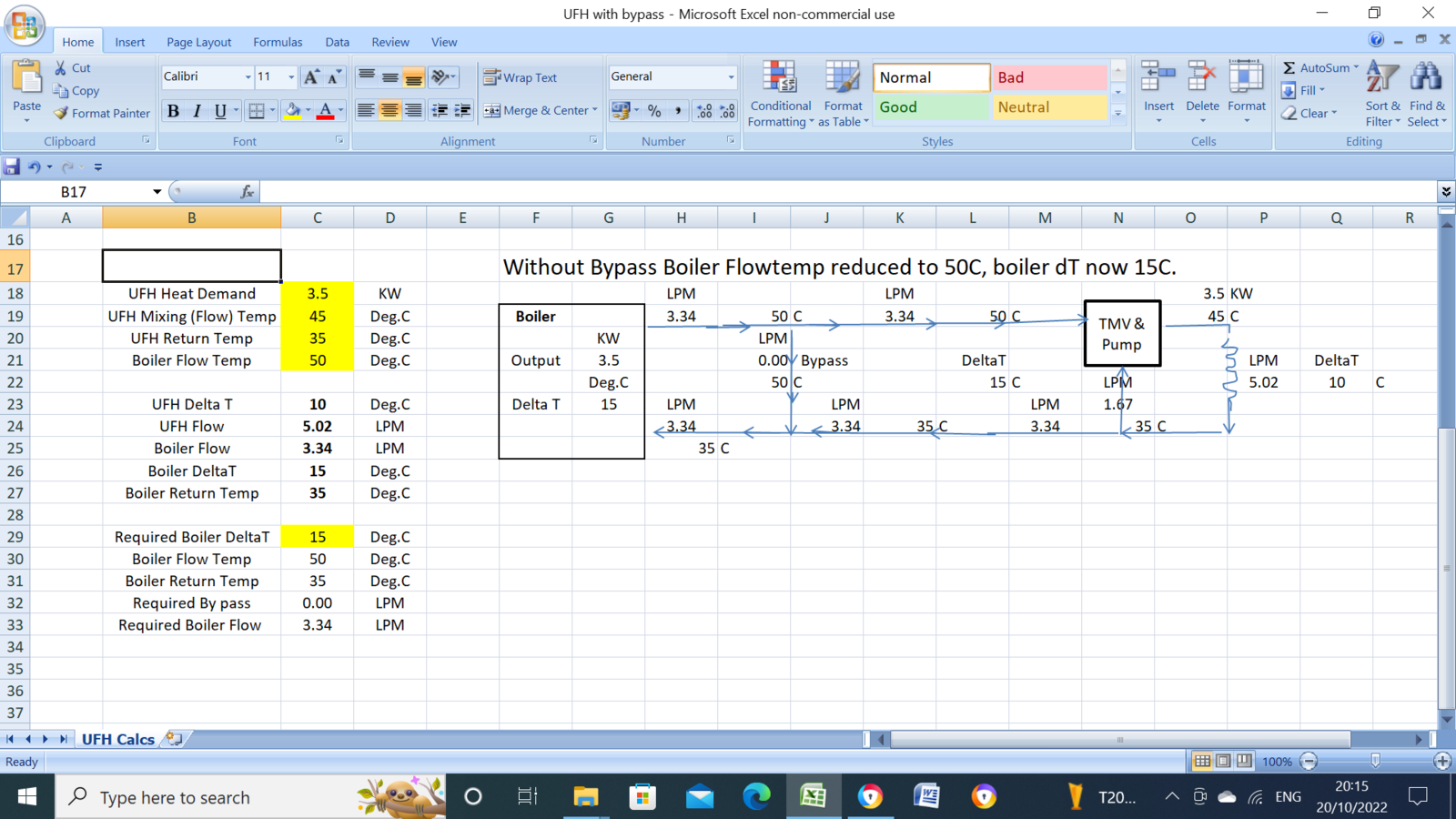

You can reduce the dT when running on UFH only, by reducing the boiler flow temperature, reducing the flow temp to 50C will reduce the dT to 15C. (see below)
You may be able to increase the heat emitted by the UFH loops by increasing the mixed flow temperature but you have to be careful not to damage the floor covering but as the minimum output of the boiler is ~ 5.5/6kw then no way IMO can you stop cycling and any Vaillant would be at the bottom of my list where cycling is involved, based on reading problems other users have.
