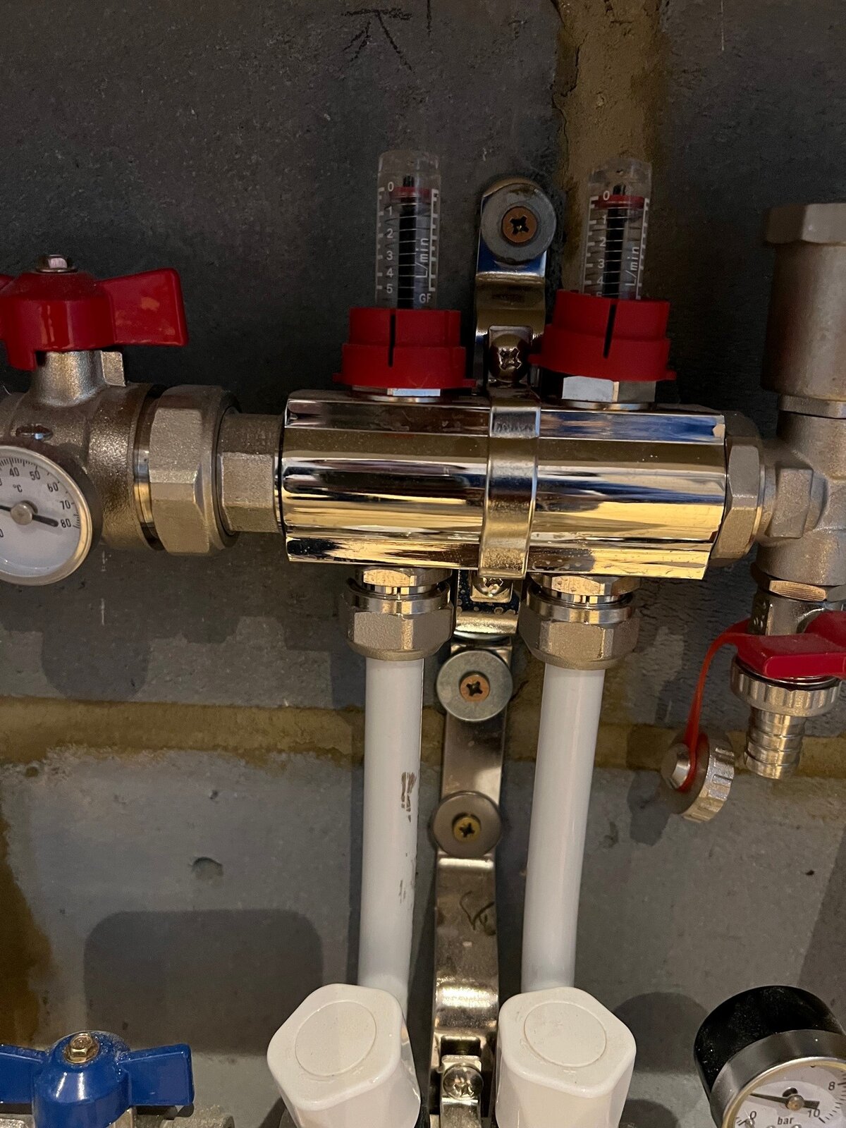

Both the UFH flow meters show 0, all the pipes around the manifold are cold but the UFH pump is on
@Johntheo5 - the zone valve for the UFH is open so don't understand why the UFH is not turning on unless when the engineer power flushed the boiler pipes, this has an effect
@Johntheo5 - I have turned off the UFH as I am concerned I might be causing damage to it. The UFH pump is on but is cold too.

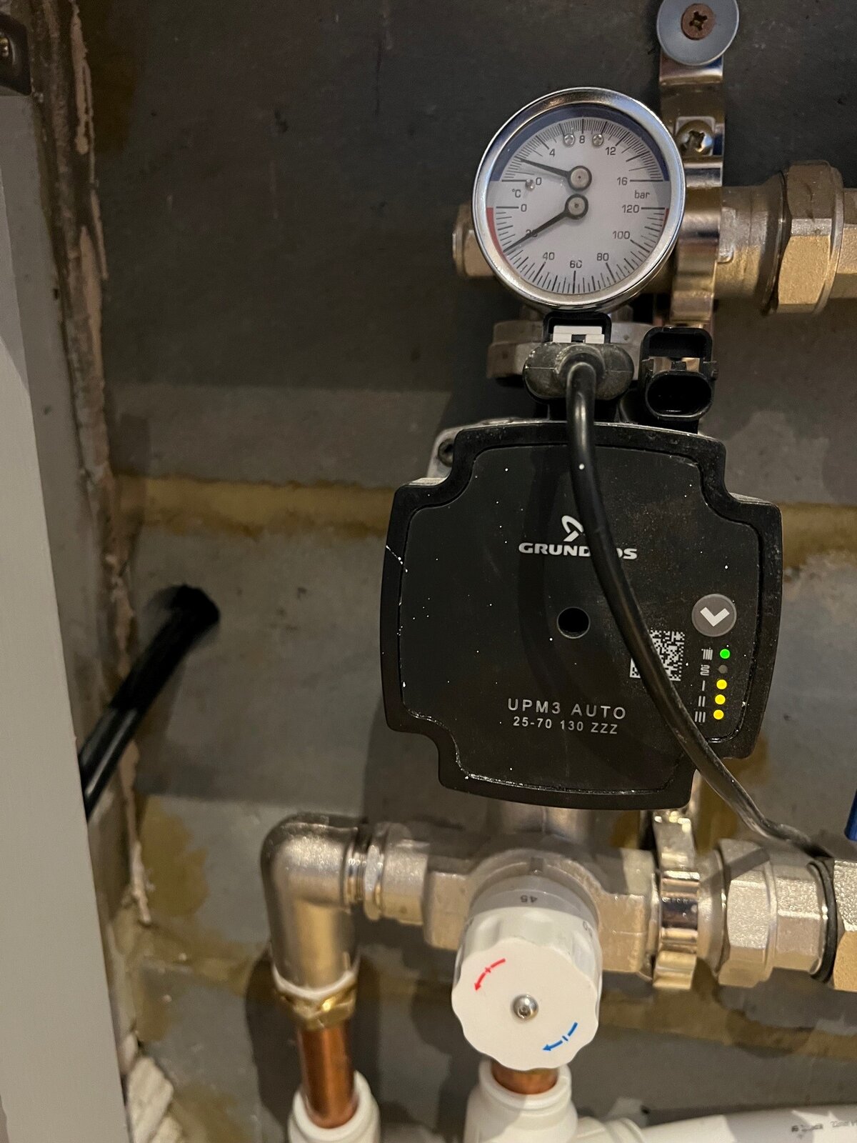

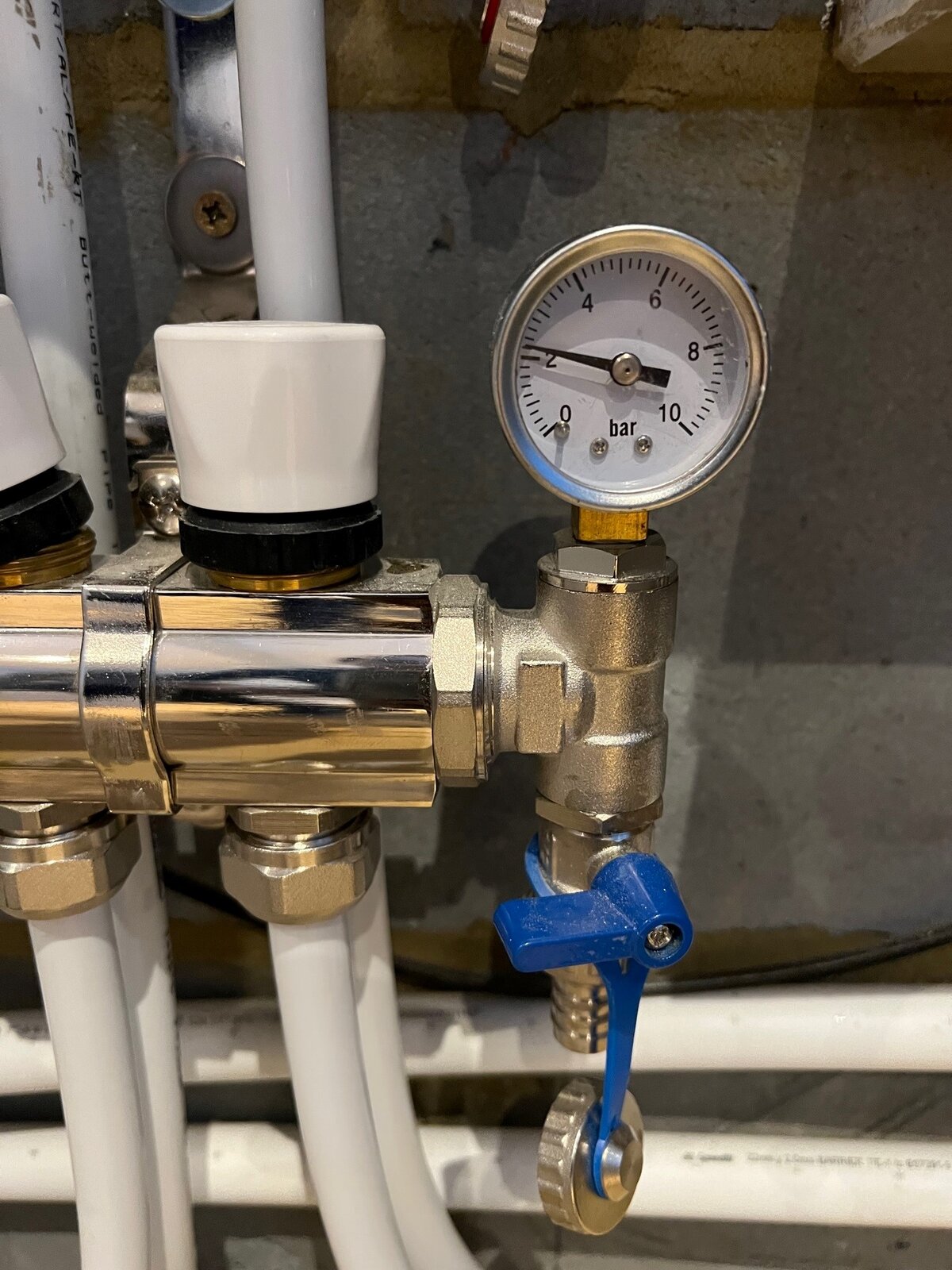

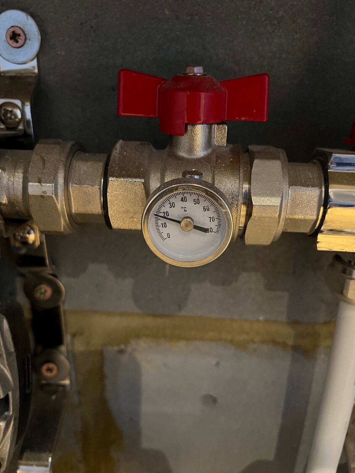

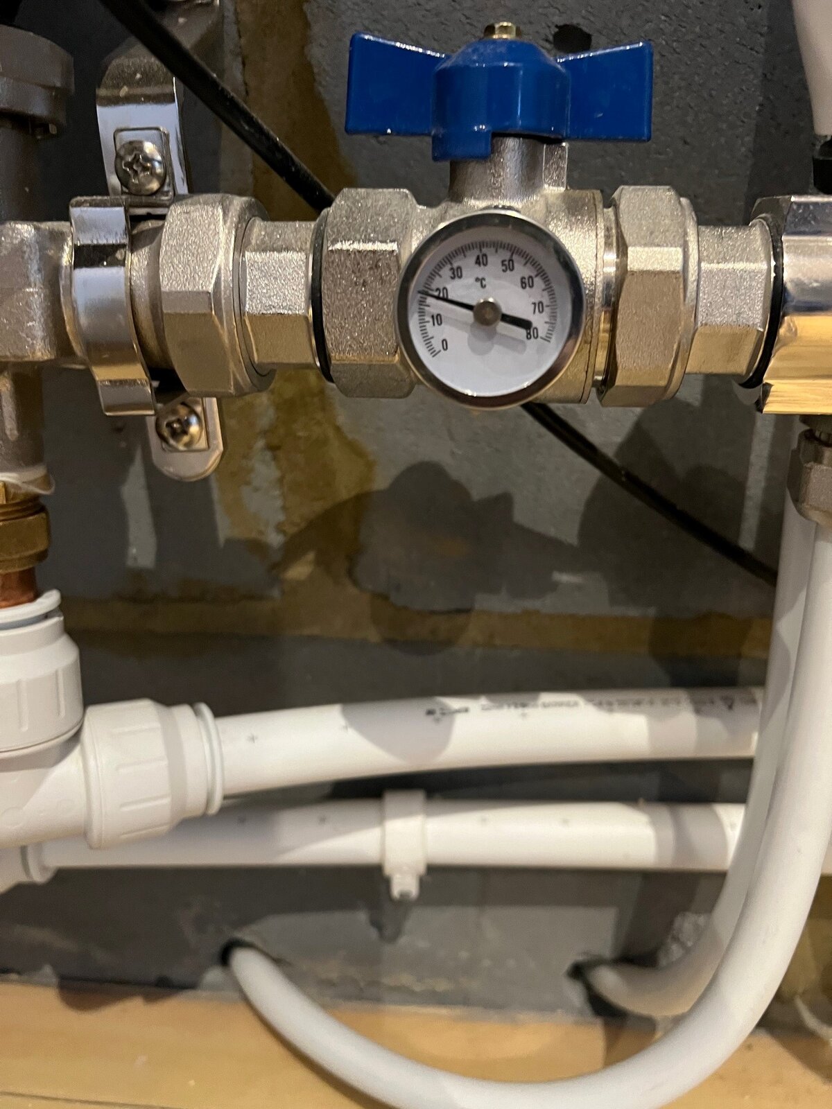

I have attached some photos of the UFH while the UFH system was on

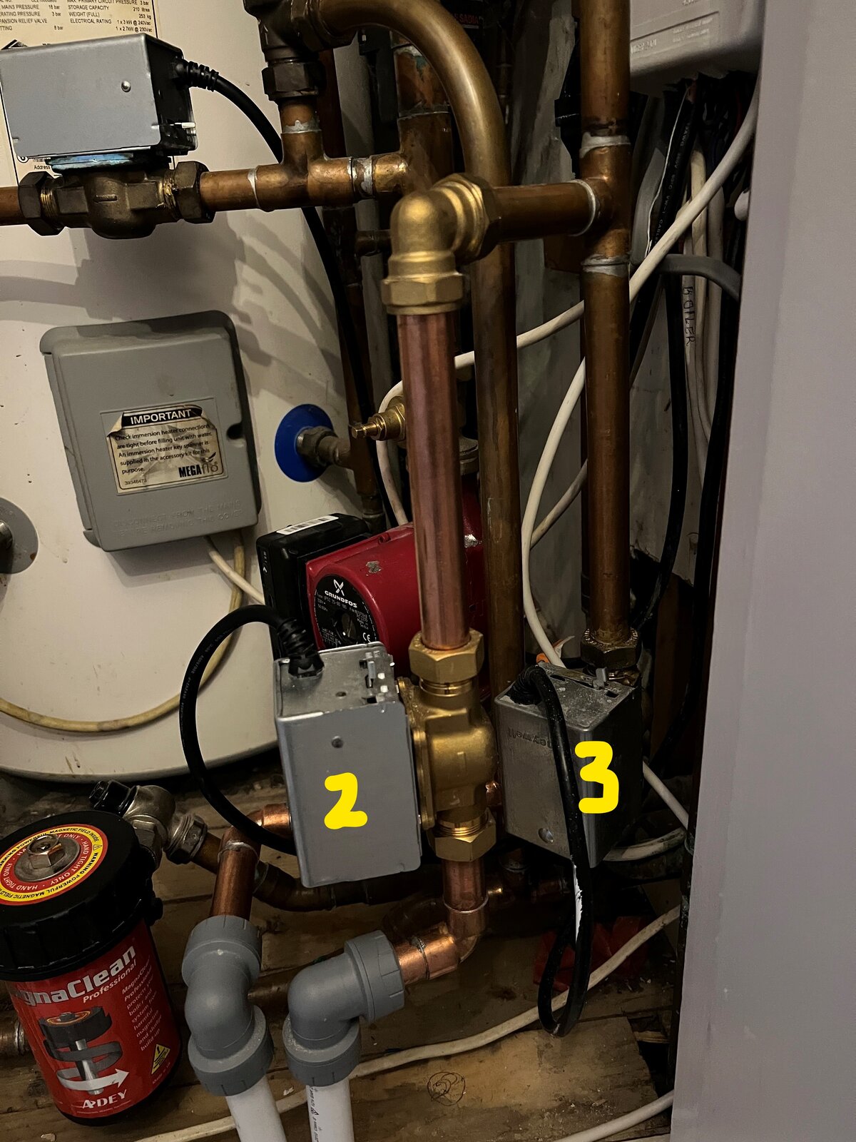

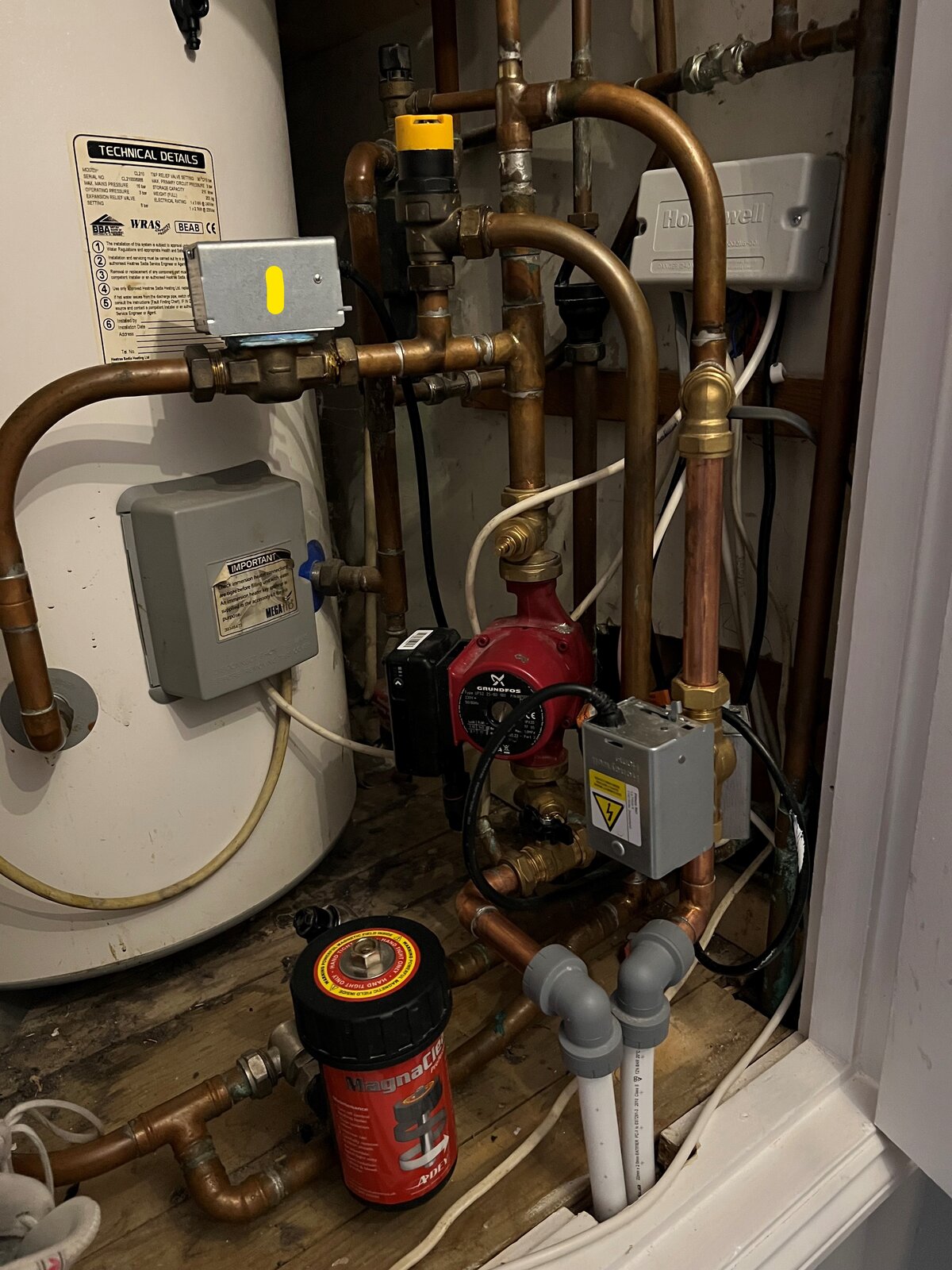

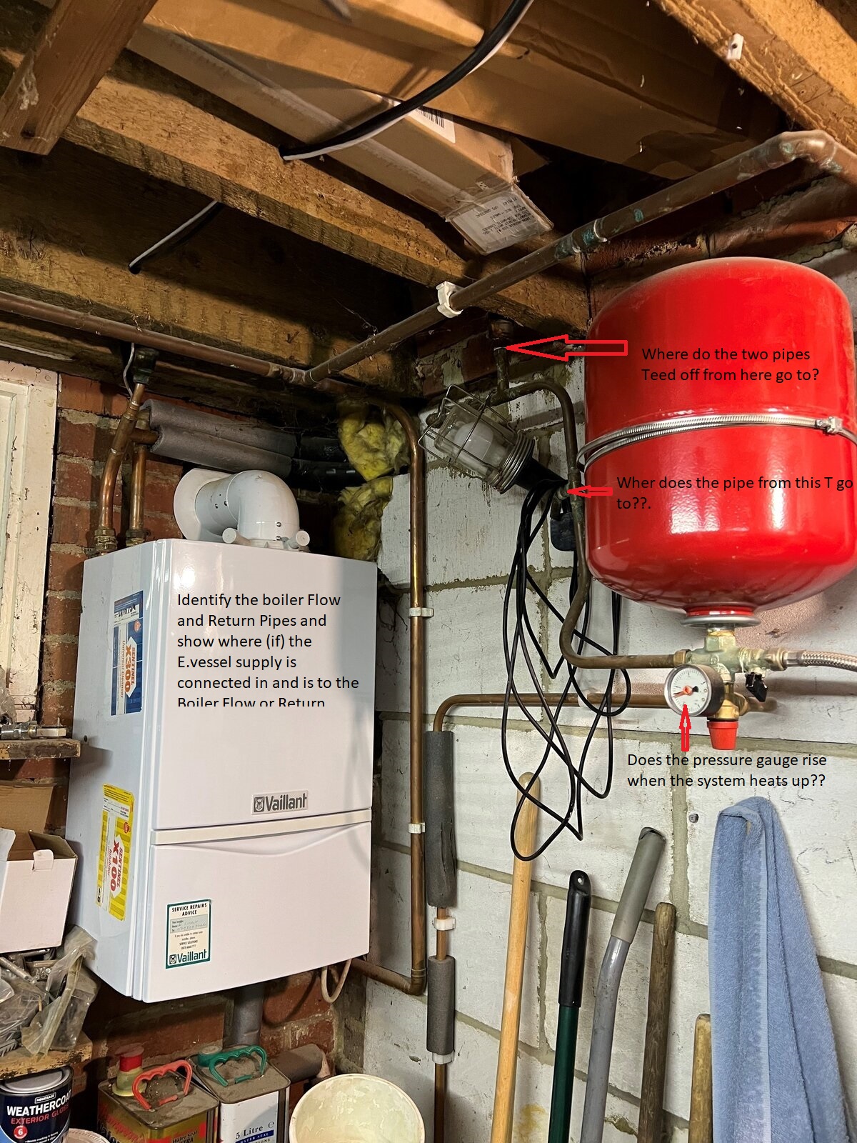

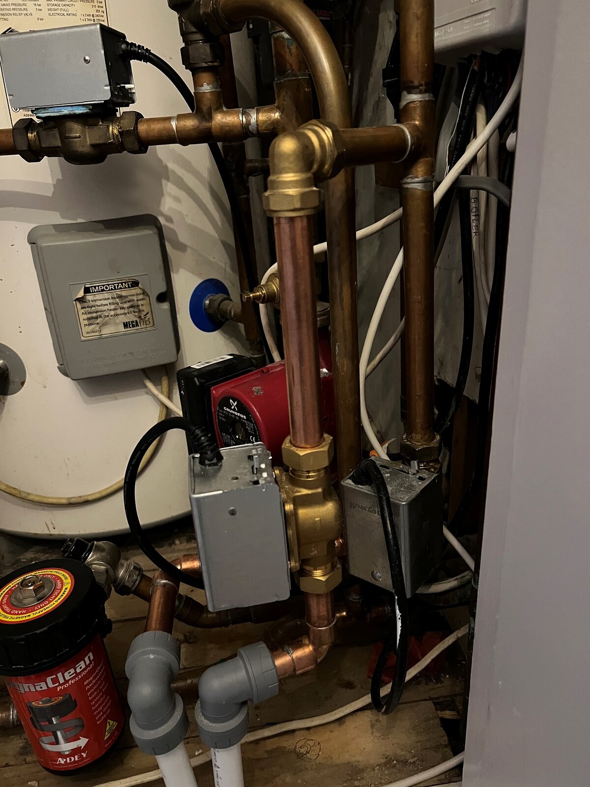

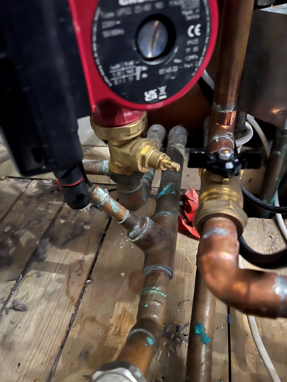

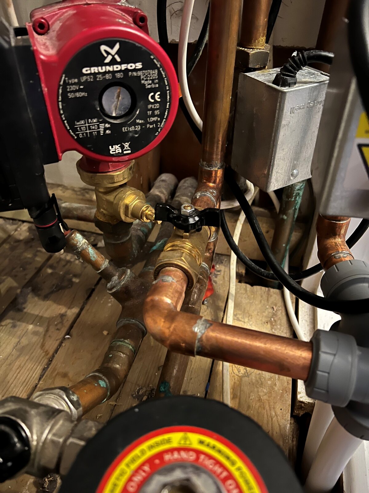

@Johntheo5 - I have attached some photos.

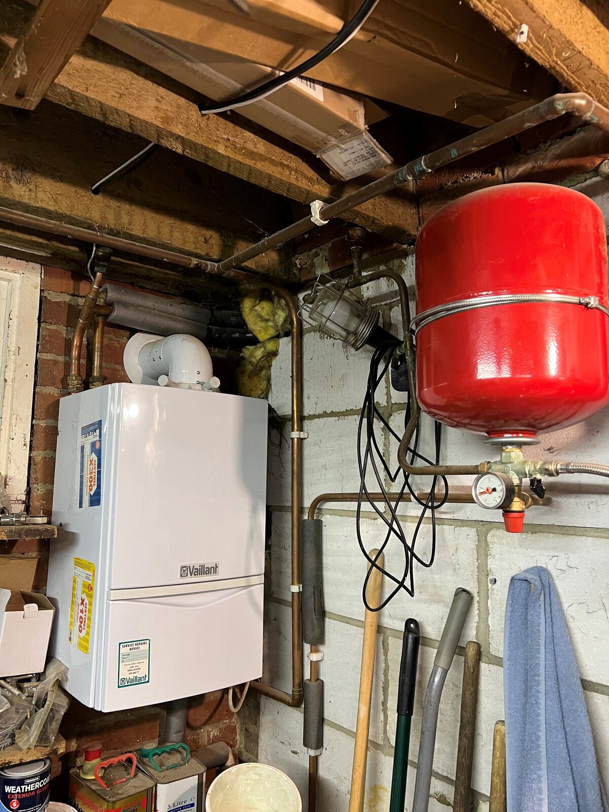

- 2 photos showing the boiler in the garage and the expansion vessel gauge
- hot water zone valve (labelled in yellow with the number 1). Within this photo, the 2 white pipes at the front are coming from the UFH manaifold
- zones valves - the one labelled '2' in yellow is for the UFH, the one labelled '3' in yellow is for the CH

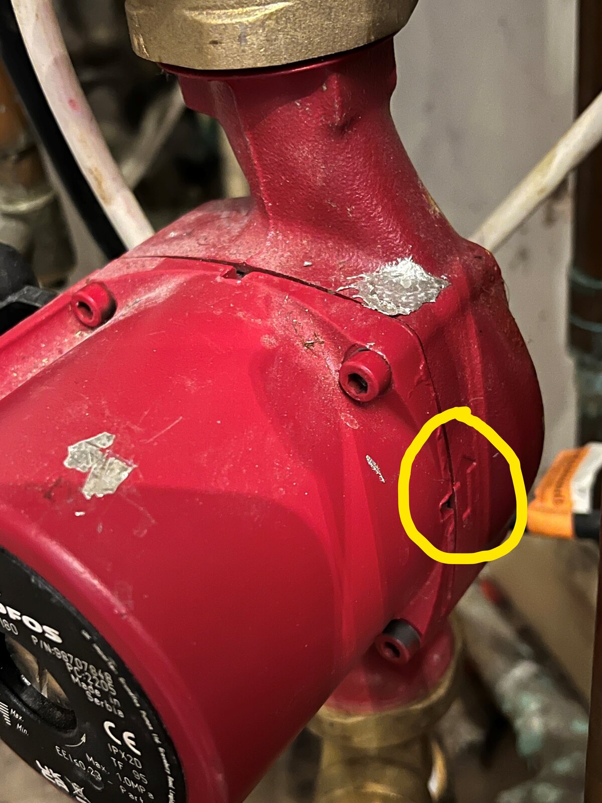

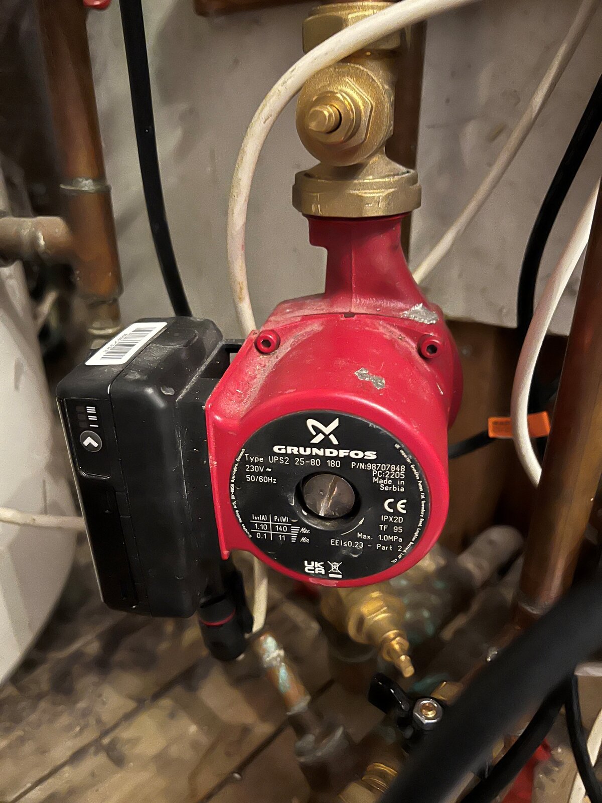

- 3 photos showing pipework around the pump
- photo of pump showing upwards arrow on pump (circled in yellow)

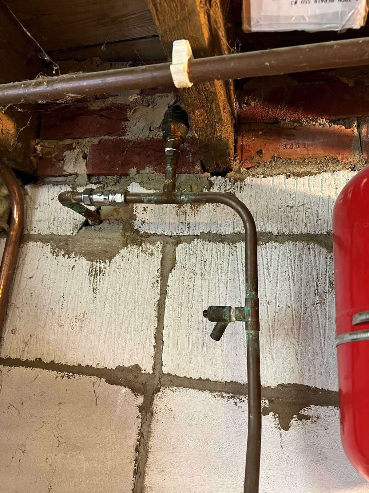

Will have to start somewhere, you might try and answer the queries in the attached, it is very important to try and establish that the E.vessel is tied in to the boiler Flow Pipe or not and before the circ pump suction.
Has the magfilter been cleaned recently?.
Thanks @Johntheo5. I will try to answer some of your queries on the attached tomorrow where I can.
My boiler is covered by British Gas and they carried out an annual service on 26/9/22 which included cleaning out the magnacleen.
From the attached, I’m 99% certain that the boiler flow pipe is the one above the boiler on the extreme left.

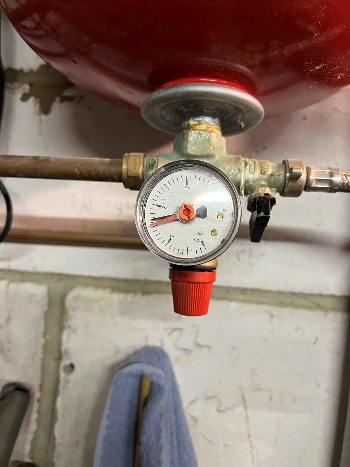

On the pressure gauge, I will check but I do not believe the gauge rises when the system heats up
It certainly should rise, give it a judicious tap of a spanner at its side to see does it fall/rise to its real pressure.
See if the E.vessel is tied in here somewhere.
