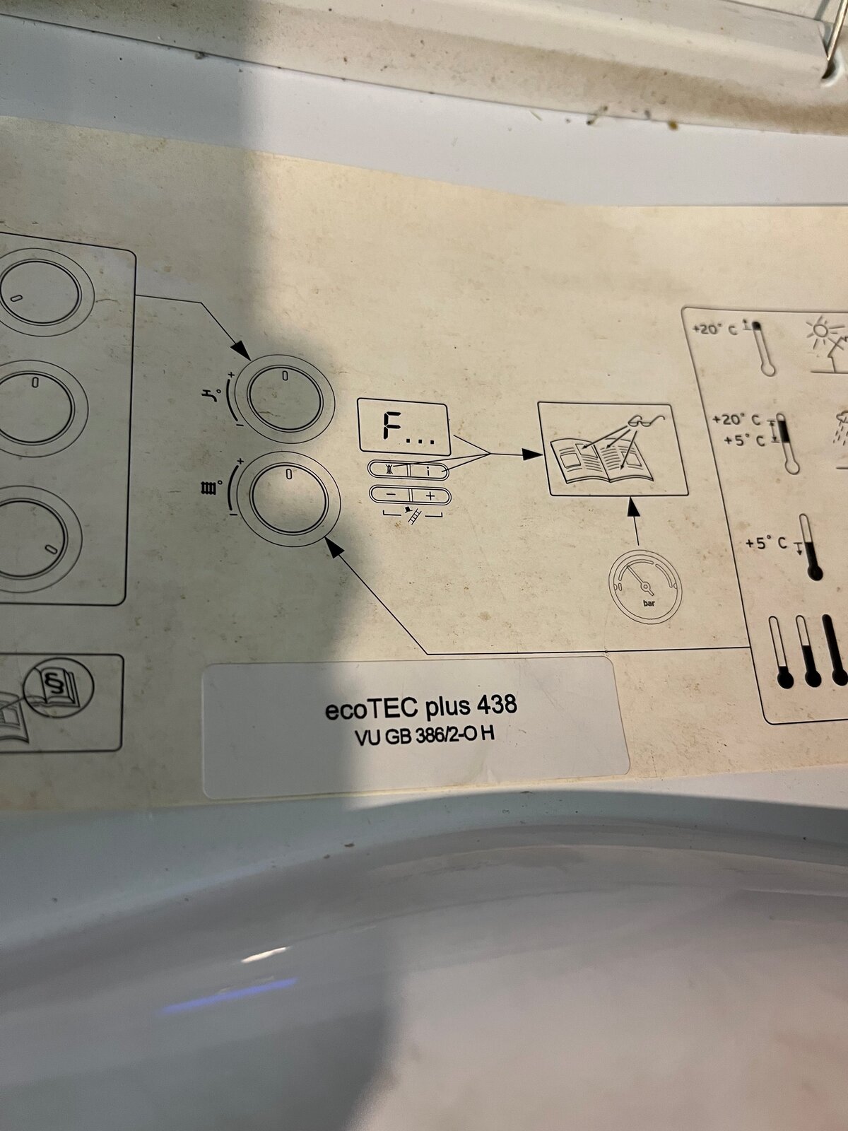

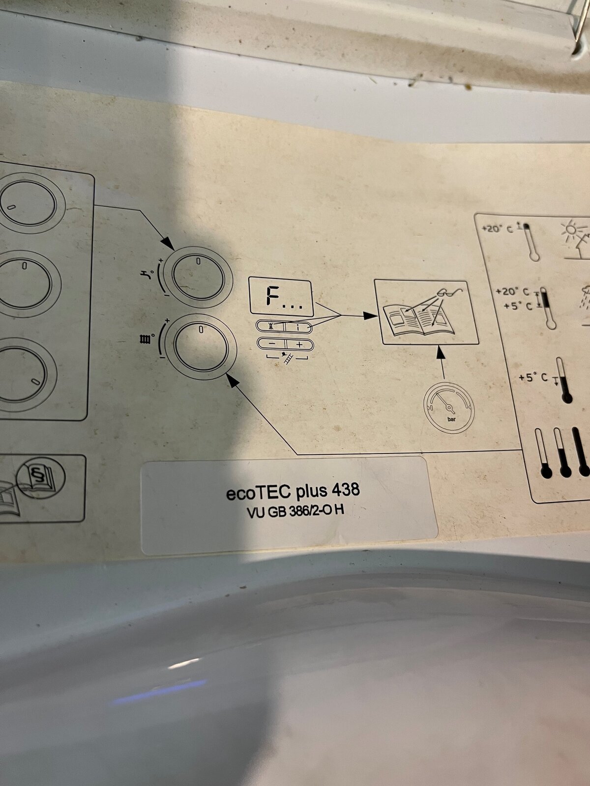

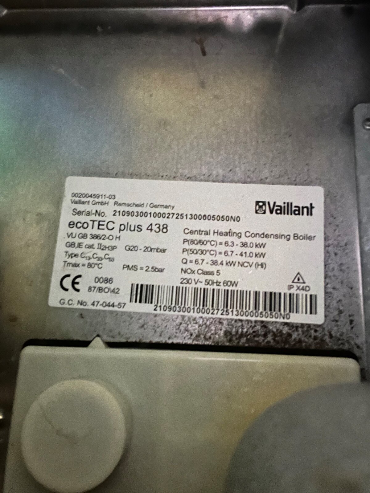

Attached are some photos of the labels shown on the boiler; one of them shows that it is a Vaillant ecoTEC plus 438 along with its serial number.
The furthest rads are still struggling to get hot but I guess that is partly down to the d.00 settings.
The fact that the range rating is not limiting thr boiler output, what does this mean? - boiler issue? pump issue? (btw - pump is very hot to the touch but running quieter than before when d.00 was on 18), blockage somewhere?

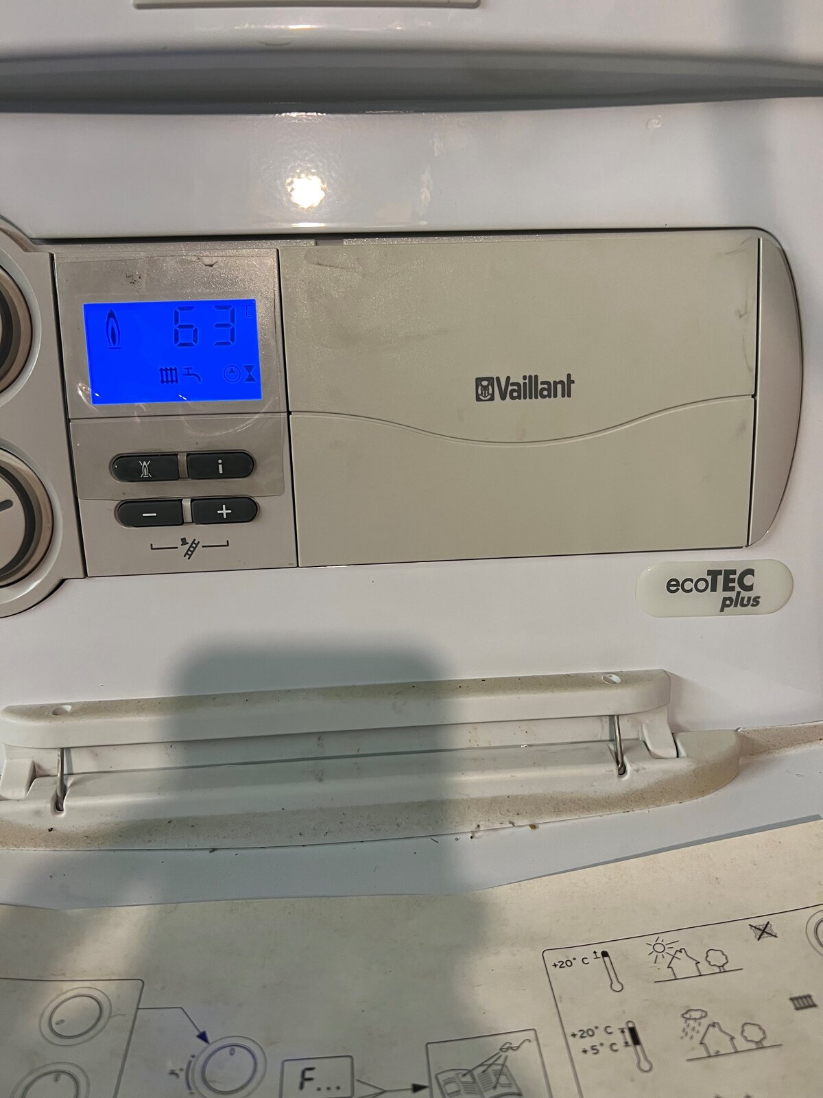

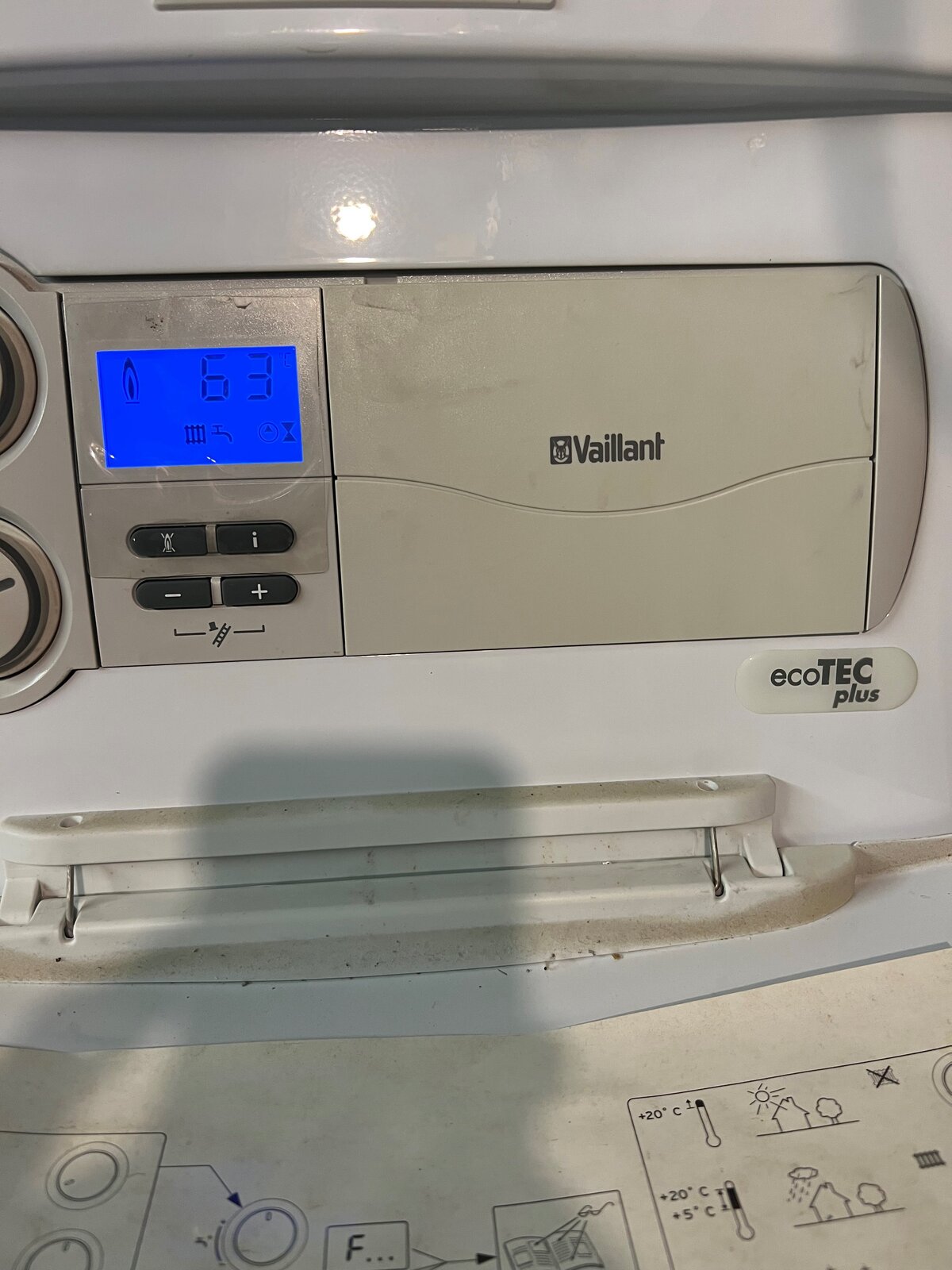

Looks as if the rad(s) demand might only actually be 7kw as the flow temp has dropped & the return decreased, if so, then the flowrate is only a virtually unbelievable 5.9LPM. (7x860/60/17).

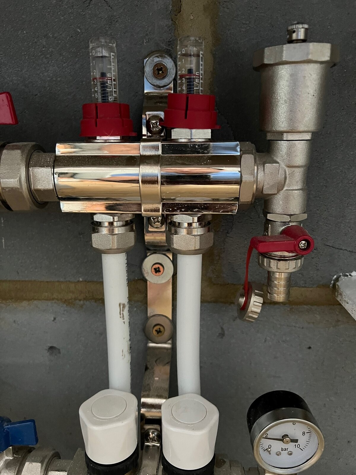

OK then leave everything as is and now switch in your UFH. (leave pump at setting III).
oh, @Johntheo5, I turned everything off as the house was getting too hot . Shall I turn back on the heating with d.00 at 7kW and then also turn on the UFH?
Do you want me to note down d40 & d.41 after a period of time?
Yes do that ASAP, and after 10/15 minutes also take UFH flowrates and flow/return temps and that will do.
You may have to turn on the CH & the UFH together to get the boiler away without cycling.
You might care to leave the UFH on alone afterwards for awhile if not too uncomfortable.
These ones, just add the two together or post a photo. take the temperatures from the flow&return from the thermometers.
This a better one, taken after you had adjusted them.
