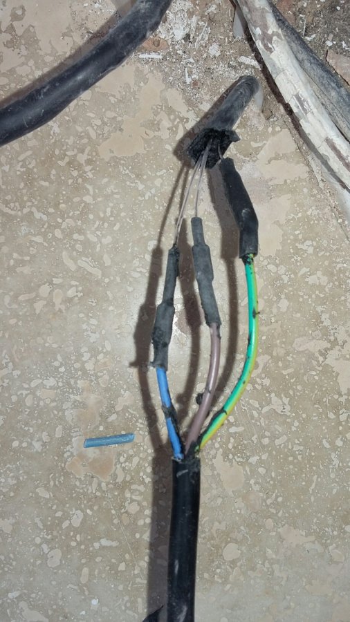

On testing cold tails found an intermittent open circuit. When the join between the cold tails and the heating element is squeezed the resistance reading is the expected figure.
So a poor joint.
Opened up the joint to have a look.
The heating elements are a very fine conductor in a clear sheath see picture
What type of crimps/connectors do you think these are?
