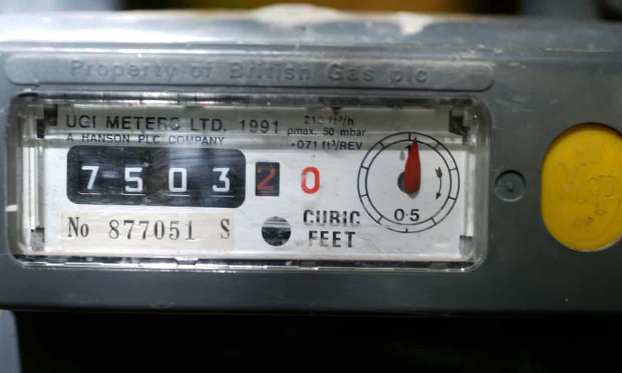

Brother has bought old probate property that has one of the old UGI gas meters by Hanson company. It is a proper vintage model that is at least 38 years old.
Advised to take photo of meters for accurate billing before work got started, which he did. Couple of weeks in and electricity meter is ticking over, but gas meter digital total has not moved at all. The boiler has been in use as too cold to work in there without heating on.
See pic ref below - the red arrow on the single circular dial to the right is static. Surely this should be moving in line with energy/heating usage.
Has anyone come across this issue? Any way of correcting this? And random Q, what is that yellow bit for??
The yellow bit is a wax seal that you cant tamper with as for the meter not registering I wouldnt be in any rush to tell anyone, but if you are worried contact who you pay the gas bill too and they will get someone out to fit a replacement meter

The house is semi detached - is it possible that the gas here was connected to the gas pipework of a neighbour?

So, does anyone think it likely that the gas could be connected to the pipework of the neighbouring house?

While not impossible, it's exceptionally unlikely.
Turn off the valve at the gas meter, and see if the boiler still works.
Meter says 1991.
Thanks for this Flameport - boiler did not work with valve turned off so that rules that niggle out.
