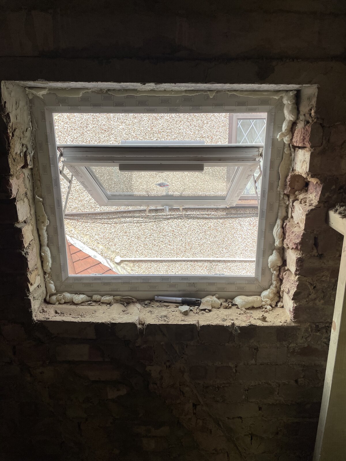

Yes, the window openings should conform to the means of escape guide, else if the BCO is giving you an option to relax that and compensate with a protected escape route, then you need to consider that. You should also check if he will require enhanced fire detection with detectors in rooms.
each room has 2 windows, 1 of which measures:
56cn x 68cm width
this size enough? it opens up wards, top hung, 'V' -- but said the hinges may need to change as when it opens, it obstruct someone from getting out...
protected escape route, need to be outside as it is a loft conversion...
my window 56cm Height x 68cm width:
