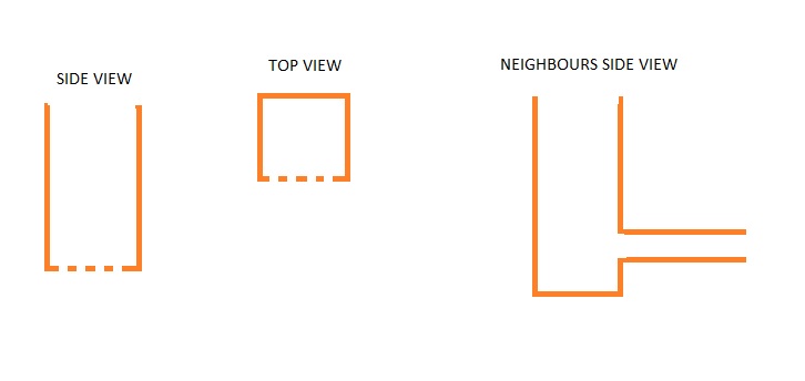

My storm drain is slow.
During heavy rain water pools up.

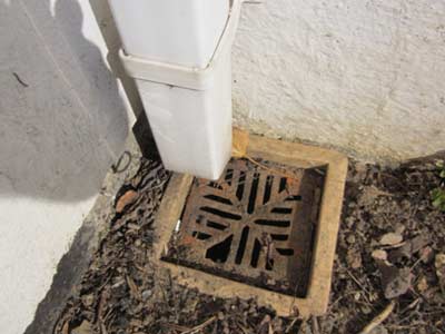

The gully is square ceramic like on the photo with down pipe.
With the difference that mine is 4 inches deep below concrete pavement.
I went arms deep to remove silt but found none.
I am unable to locate the outlet inside to gully - checked all 4 sides - all smooth ceramic walls.
On one side - facing away from the house - on the very bottom, I feel several small holes, about 5 of them, about 1cm or smaller.
Puzzled, went to neighbors side (this is semi detached) and their gully is normal.
Any ideas please?

you saying that there is no such type of gully as on my drawing?

It is a clay gulley so more than likely has been cracked, broken and leaking for years
This washes away the surrounding soil, so it sinks down (which matches your description)
Rather than dig out and replace the broken gulley, people usually patch up the cracked concrete (which matches your description)
You are going to have to break up the concrete, remove and replace the gulley
It is extremely common. Not complex or difficult.
