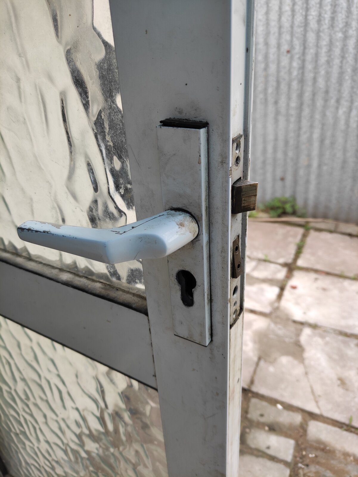

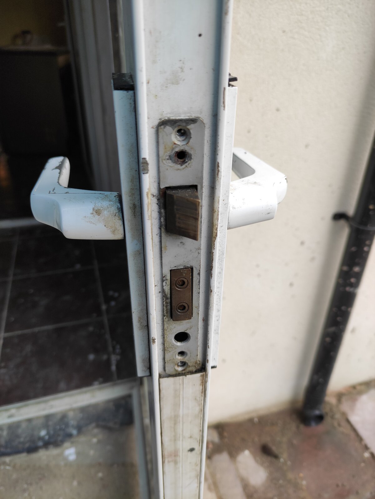

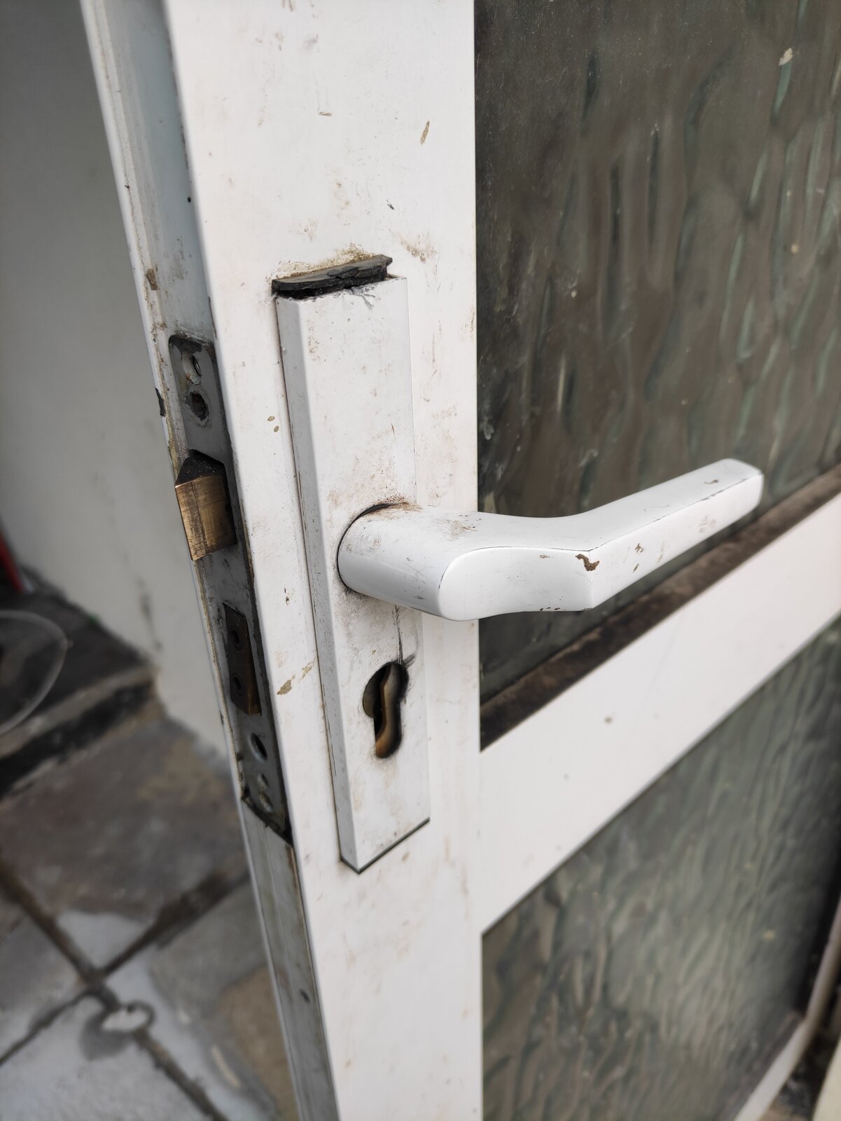

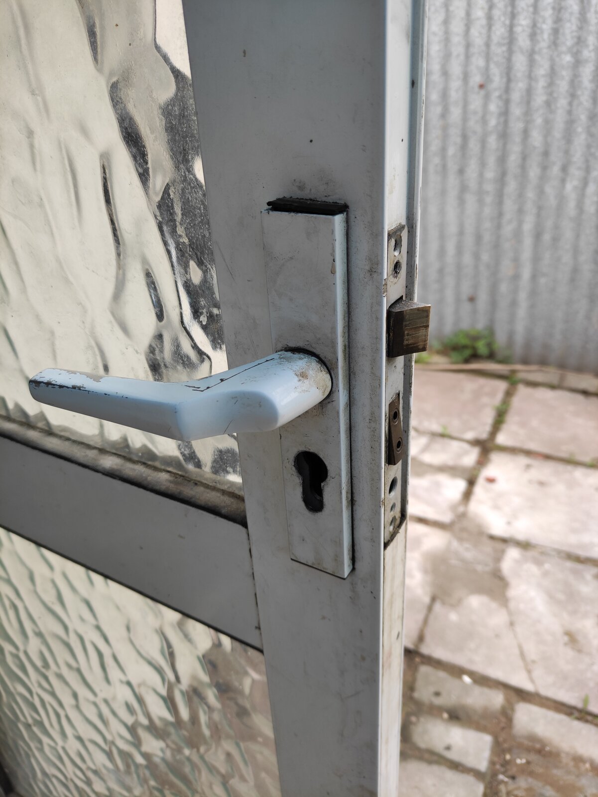

Hi all,
The lock mechanism on my door has been causing problems I wanted to replace it. In order to to that, I need to remove the handles and spindle in order to pull the lock mechanism out.
I have removed the small grub screws on each handle but its still stuck. I cannot see any other screws to remove and am stumped how else to remove the handles
Anyone have any ideas?

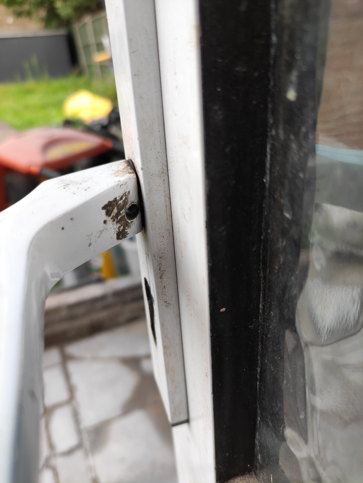

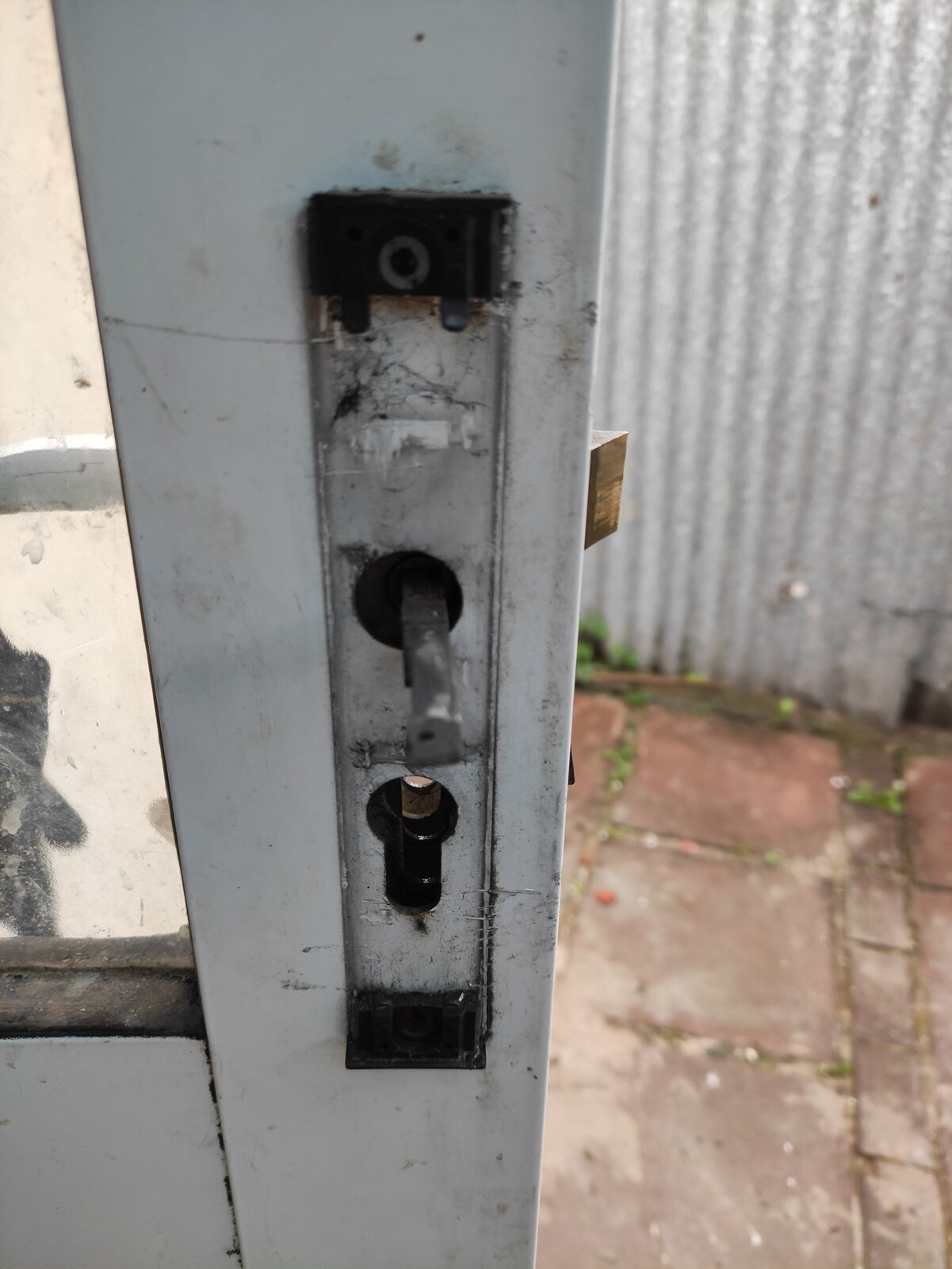

The black plastic tabs are the ones screwed through the door, you need something flat, sharp and pretty stiff to get behind the handle to pride off, it'll feel like your going to break something but it's ok, still leave the grub screw out though as that bites onto the spindle which in turn stops you pulling the handle off the black tabs
Hi Crank39,
Thanks for the response. I did try prising out the black plastic tabs, but they wouldn't budge. Makes sense now you've said they are screwed through the door.
Just confused if I should be trying to prise out the handle OR the plate. Do you think the handle is actually attached to the plate itself and that its the plate I should be removing?
Pride the backplate off the black clips, the lever handle will come away with the backplate, the backplate thumps onto the clips and is held on with some teeth hence it's a bit difficult to pop them off

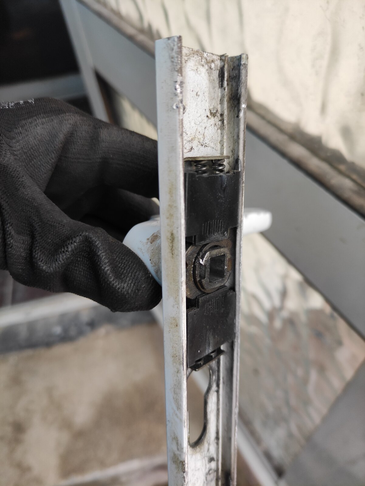

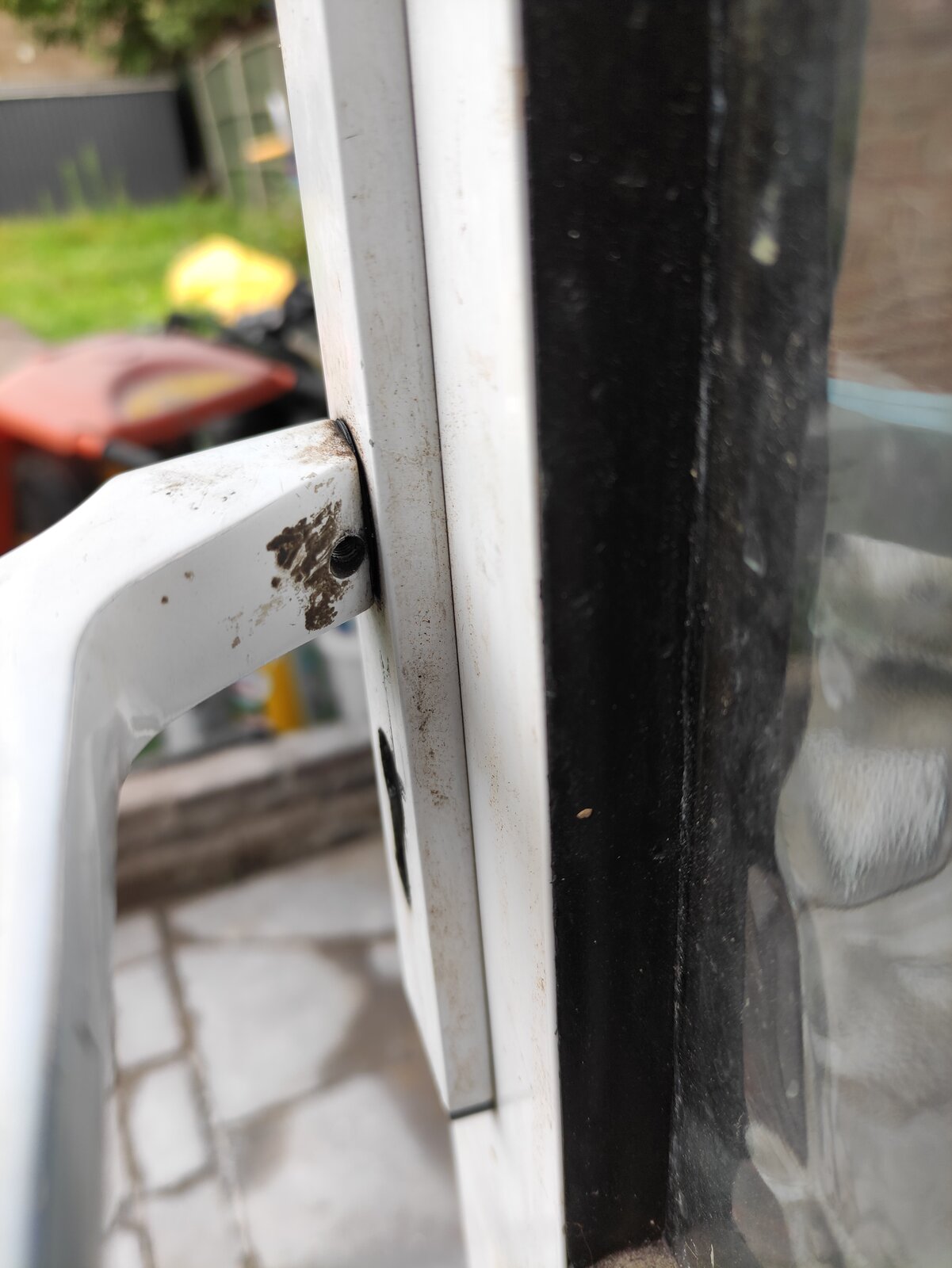

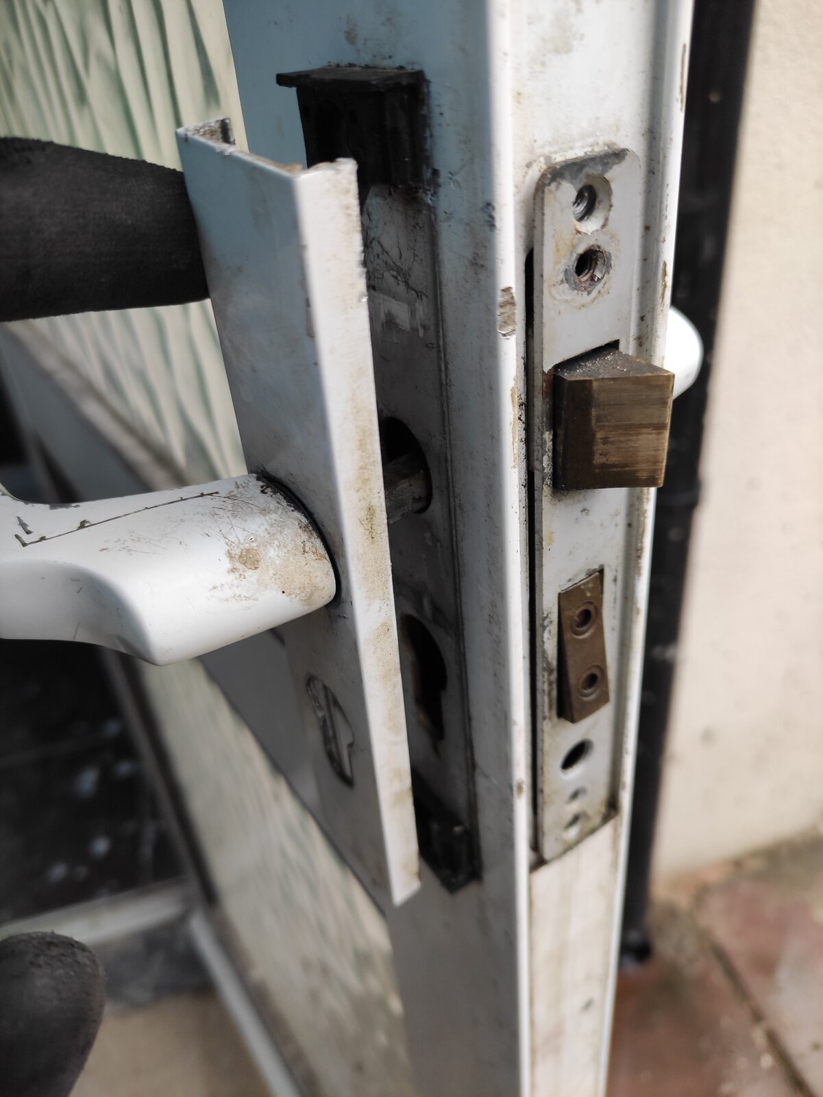

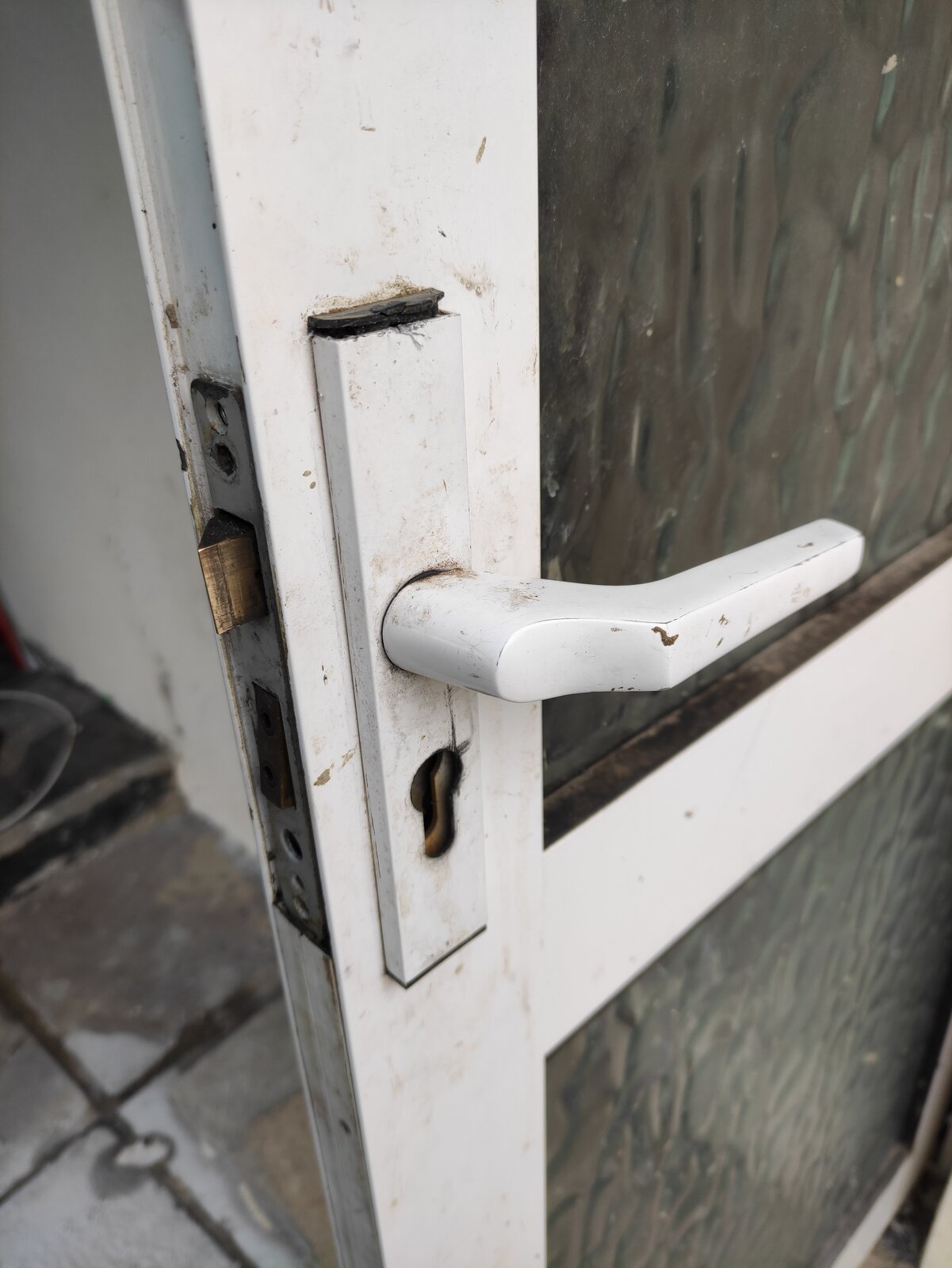

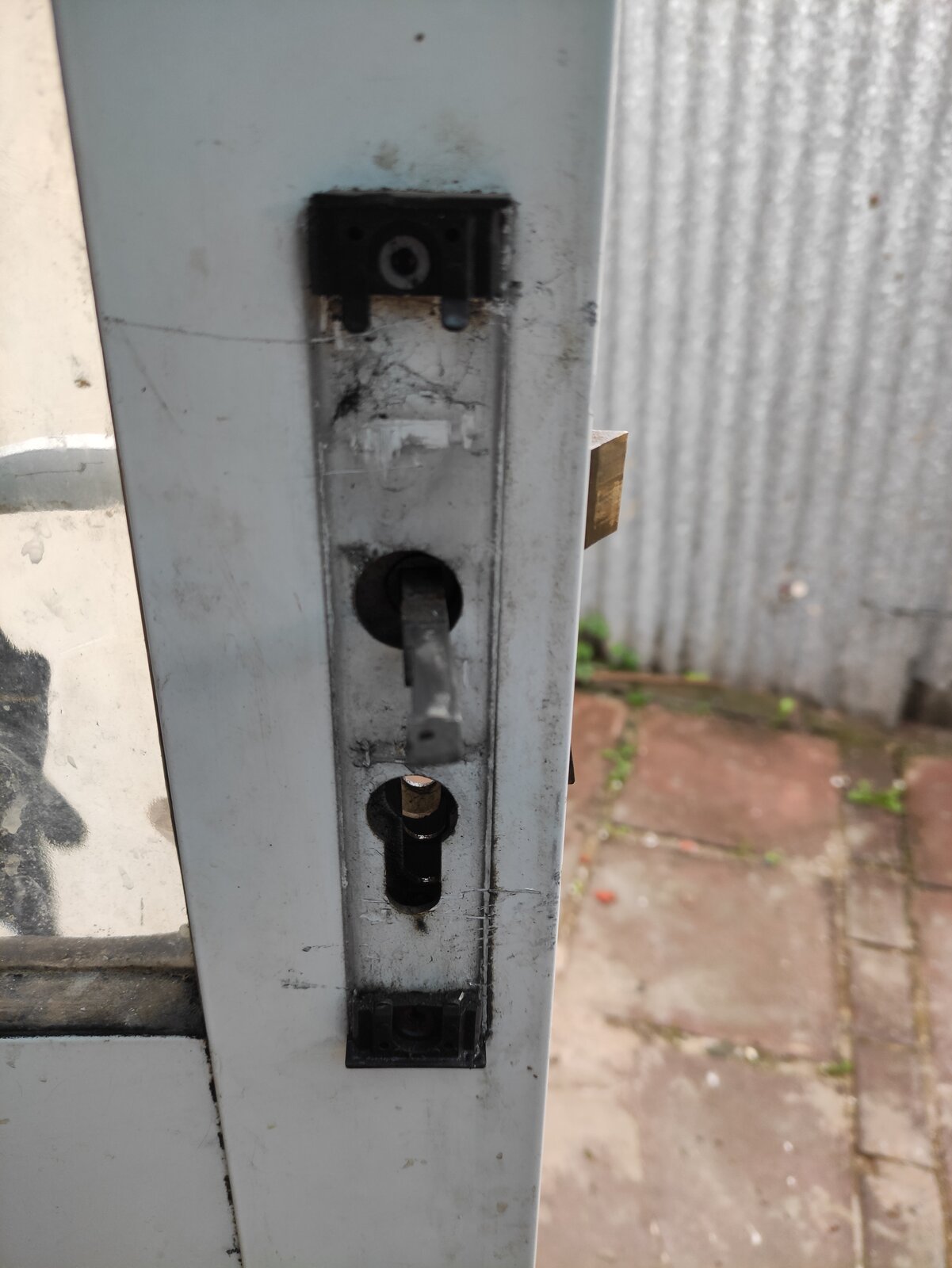

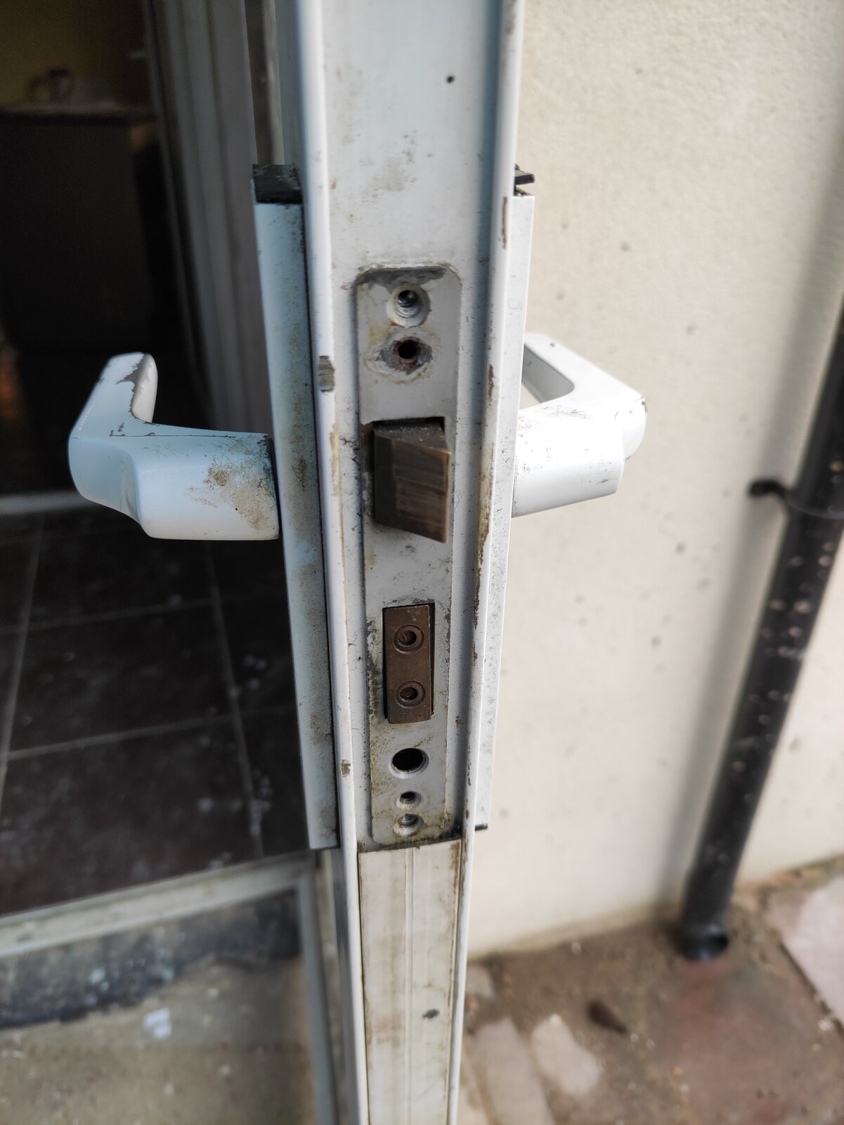

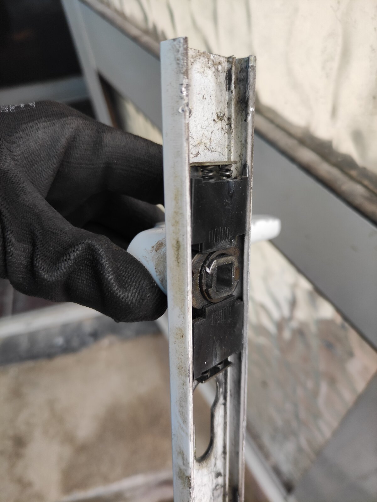

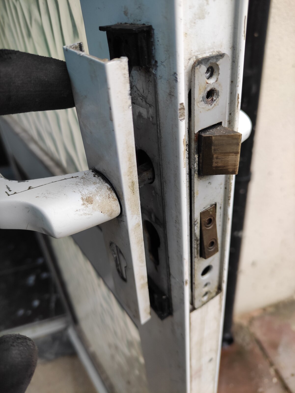

Hi all - Success!!!
Thank you Footprints, Foxhole and Crank39 for taking your time out to help.
Thanks to your advice, i managed to get a chisel behind the lever plate and pull it off - you were right about feeling like 'breaking' something, but with enough force it eventually came off.
I have attached some pictures of what it looks like in case its able to help others.
Thanks again :)
