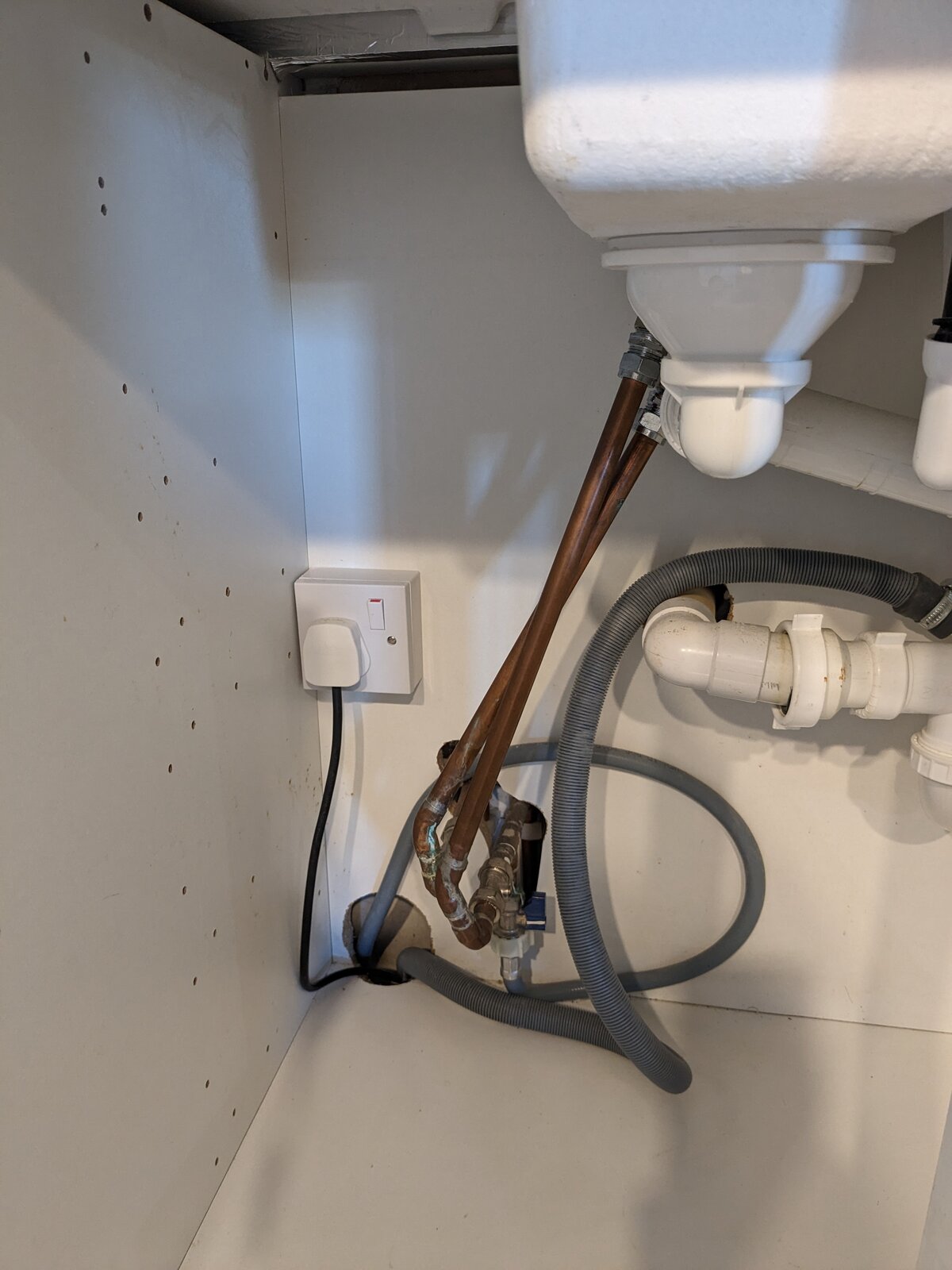

Under sink dishwasher water outlet won't fit a flow stop hose?
20 Feb 2023
2
Our Whirlpool dishwasher has given up the ghost and was hoping to have a new Bosch replacement installed as part of getting it delivered, however from the spec I can see that all Bosch, and most other makes, now come with a water flow block/stop unit attached to the end of the hose meaning you need a lot more space to fit the hose to the water outlet.
In our case the water outlet is fitted very low to the bottom of the cabinet under the kitchen sink, and the standard pipe currently fitted is tight to the floor as it is. I figure the options are cut a great big gap in the base of the cabinet or fix some sort of right angle adjustment so that the pipe goes sideways? I don't want to change the hose provided as this may invalidate the Dishwasher warrantee. Moving the pipework up would presumably be an expensive option, and probably too close to the power socket?
Loosen off the two silver nuts and turn the fitting 90 degrees.
